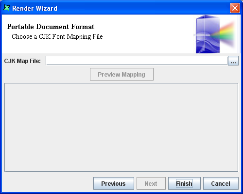

CJK Font Mapping
The PDF specification defines 14 built-in fonts. If you use fonts that are not part of the specification they can be embedded in the report (subject to font licensing) or the glyphs can be rendered as vectors, removing the need for the font, but making selection impossible.
CJK Fonts can be very large, so embedding the glyphs or even the font itself results in large files. The next page of the PDF Render Wizard allows font names to be substituted, retaining small files, as long as the CJK fonts are available on the reader devices. The wizard page is shown in Figure 5.6, “PDF CJK Mapping”.
Figure 5.6. PDF CJK Mapping
PDF CJK Mapping
The CJK Mapping File is a text file, which contains a substitution on each line. For example:
Serif=STSong-Light
SansSerif=MSung-Light
You can create this mapping file as a text file in the repository, so that many reports can share it and so you can easily deploy it to the Repertoire Server if necessary. Once the mapping file is chosen, all text in the report that use Serif font will be written to PDF as STSong-Light.
