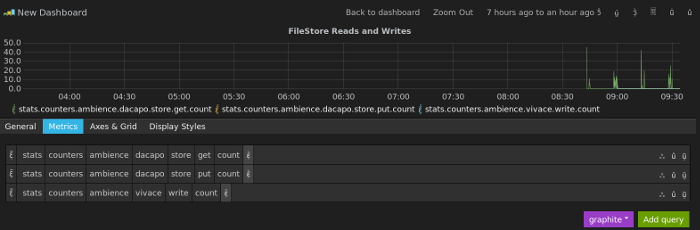

  9. From the Metrics tab, add the statistic to be retrieved and displayed, as shown by the example in Figure 2.3, “Adding the Metrics”.
    Note that as you select each component of the statistic, the system filters and displays only the appropriate choices for the next component.
    Figure 2.3. Adding the Metrics
    Adding the Metrics
