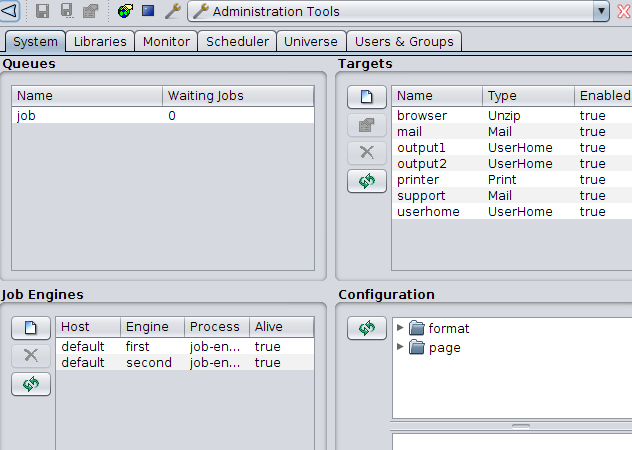

The System page is used to create job engines, monitor job queues, set targets, and configure date and time formats.
Jobs are run by many Job Engines according to their sequence in the queue. Each Job Engine takes a task from the queue, sends the result and writes the log into the Repository. Each Job Engine only processes one task at a time. Unwanted jobs can be deleted.
The Job Engines page is designed for controlling the job engines on the pre-defined set of hosts. You have the option to add and remove job engines, as well as set the host, engine name and process. If you have multiple hosts configured, you can add and remove the engines across all the hosts.
This allows you to perform common configurations that will apply across all Ambience modules. For example, you can set the uniform formats for date, datepicker, time, timepicker and timestamp. When a date is displayed by Java, it will use the /Configuration/format/date/ settings. When JavaScript is used, it will use the /Configuration/format/datepicker settings by default, unless there is a local override. Web-based modules will reflect the changes quickly, while other modules may show the changes after they are restarted.
