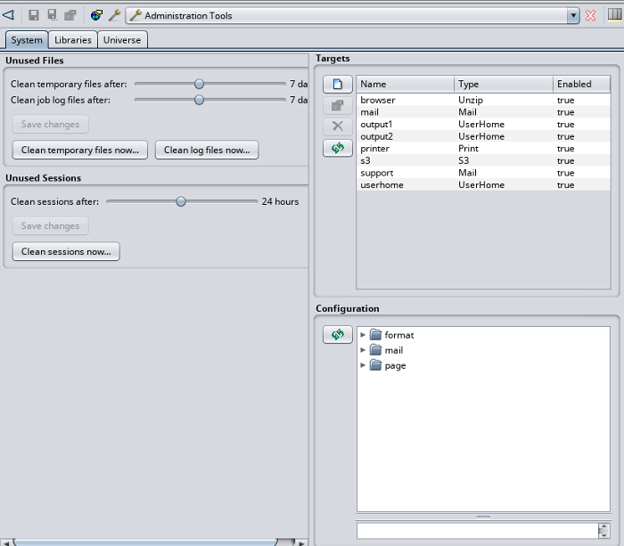

The System page allows you to clean up unwanted log and temporary files, set targets and configure formats such as date and time.
Allows you to set the duration after which unused temporary and log files are automatically deleted.
The default duration is set to 7 days.
You can also elect to clean up the temporary and log files immediately, by clicking Clean temporary files now and Clean log files now.
Allows you to set the duration after which unused sessions are automatically deleted.
The default duration is set to 24 hours.
You can also elect to clean up the unused sessions immediately, by clicking Clean sessions now.
After a job finishes, a target may pick up the result. Different targets may be chained for further processing. Target processing is also a task run by the Job Engine.
If you find yourself typing a string repetitively when configuring targets, you can define that string as a constant. Then you can refer to that constant in target property values like ${constant-name}. Target constants can be enabled/disabled. Only enabled constants can be used in target configurations. You can define multiple constants with the same name, but only one of them can be enabled at any time.
All manipulations can be done in the Target Wizard. For most of the targets, configuration is simple. You need to provide a name, enable the target and provide values for required target properties.
Targets can also be enabled/disabled. Only enabled targets can be used in RenderReport task. You can define multiple targets with the same name, but only one of them can be enabled. If you make one target enabled, the rest of the targets with the same name will be disabled automatically.
Targets can be be available/unavailable to anonymous users. When the Available to anonymous users check box is selected, the target is accessible in anonymous mode. By default, only the "browser" target is available.
A target requires certain properties such as file name, folder name, port number and so on.
When editing a target, the Target Wizard lists all required properties for the target. An administrator has several options when configuring those property values:
A target provides various output types such as CSV, HTML, PDF, Microsoft formats and so on.
After the properties are set, the Target Wizard enables you to choose among different output types for report rendering purpose. You can choose multiple types at a time for convenience. You can also print the report directly.
