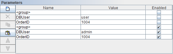

Users can group certain parameters such that the parameters can be enabled or disabled as a whole. To be able to do so, add a new parameter with name "<group>" as seen in Figure 2.2, “Grouping of Parameters”
Figure 2.2. Grouping of Parameters
A "<group>" defines a starting of a new group and the ending of the previous group. When the checkbox for a particular "<group>" is checked or unchecked, all the parameters that belong to the group will be enabled or disabled respectively.

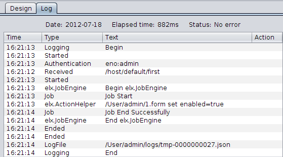

A log file is a JSON file that records the events that happen in the background when a job is running. Log files are stored in the /User/{User_Name}/logs/ directory in Repository. If the job runs successfully, a similar screen like the following figure, Figure 2.3, “Log File”, will be shown.
Figure 2.3. Log File
Log File
If the job encounters an error, the log viewer will show one or more actions on the right hand side for follow-up purpose, including Open, View and Follow, allowing you to look at job results, view more details of exceptions or follow handover to other jobs. For example, the Follow action helps you navigate through a potential tree of logs produced by multiple engines working together to solve a problem. The parent log will show the status and elapsed time of each child processing log, saving you from the trouble of following irrelevant logs.
The log viewer also allows you to send support mail with this log, or save locally to attach to support mail. The support mail address is configurable in Administration Tools > System > Targets > support. Enable the log viewer to send emails by entering the recipient's address into the support target, or disable it by deleting the support target.
