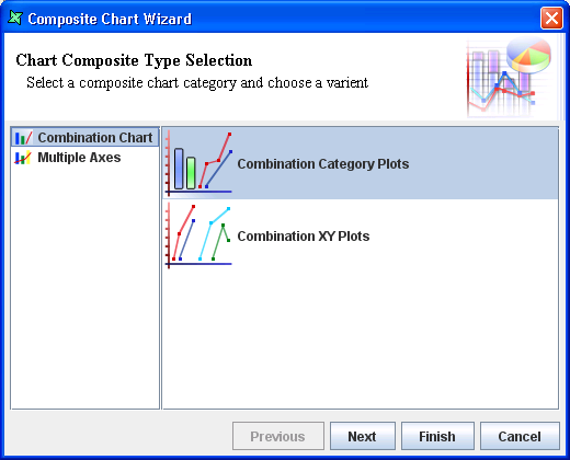

Figure 4.29. Composite Chart Type

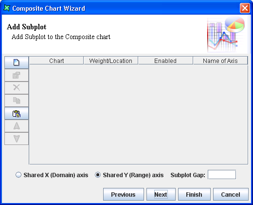

Adding a subplot adds an additional chart into the Composite Chart. The creation of each subplot is similar to the process of creating a convention Chart element. The only difference is that the process is more simplified with fewer chart types. In the section called “Case Study 1 - Composite Chart” is a sample of creating a simple Composite Chart element.
Figure 4.30. Add Subplot
Add Subplot

Combination Chart
Combination Category Plots allows the display of 2 or more Area, Column and Line Charts together side by side. Multiple XY Charts can be achieved by selecting Combination XY Plots.
The figure to be entered for Weight/Location determines the proportion of the chart. Subplot Gap determines the amount of spacing in between each chart. The value is in terms of pixels.
