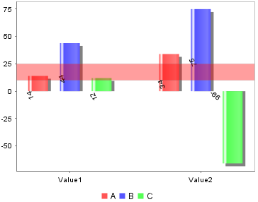

  • Interval range can be drawn on Area, Bar, Column and Line Chart. This can be done in the Chart Wizard, in the page where the Key, Values, etc are selected.
  • Position of values in Chart element can be customized according to preference. However, this is only applicable to Area, Bar, Column, Line and XY Chart (except Heat Map). The font, color and format of the values can all be customized as well. The prerequisite is to check Value in the Column tab.
    Figure 4.15. Positive and Negative Values Positioning with Interval Marker from 10 to 25

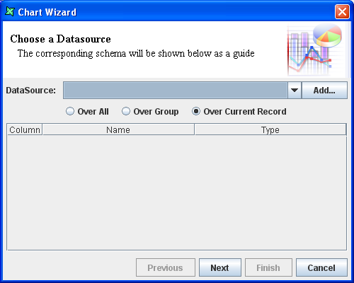

Select and place a Chart element in the report layout. The Wizard appears as shown in Figure 4.16, “Chart Wizard”. Select the DataSource from the combo box. Alternatively, by clicking the Add button on the right of the combo box select the DataSource from the Configure DataSource Wizard.
Figure 4.16. Chart Wizard
Chart Wizard
OverAll: On selecting this option, the whole set of records are taken into consideration irrespective of the grouping.
OverGroup: If this option is selected then the plotting is done based on the grouping of data is considered.
OverCurrentRecord: If this option is selected for the chart in the Group header, then the first record of the group is considered. If this option is selected for the section footer, then the last record of the data source is considered as the current record or if this option is selected for the section header then the first record of the data source is considered.
Enter the Display Name if required.
Click on the Next button to navigate to the next screen.

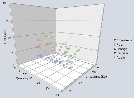

Five kinds of 3D charts are supported, Area, Column, Line, Scatter and Surface. In each case, the X axis may reference any kind of field, such as strings, numbers etc. The Y axes can only hold numeric values, so the wizard will only let you select from the numeric fields of your datasource. The Z axis can reference any kind of field, but discrete values, i.e. strings make most sense. The Z axis can't key the values effectively over a continuous range, such as a floating point number.
The chart preview tab on the Chart Wizard allows you to preview what your chart will look like. In addition, for 3D charts, you can also adjust the camera angle here, to look at the chart from a different orientation. To do this, press and hold the mouse button and drag slowly up and down and left and right. You will see the chart repainted as you drag the camera around.
Note
3D Surface chart shows values in a range. 3D Scatter chart displays values in a collection of points, as shown in Figure 4.18, “3D Scatter Chart”. These charts are also available in Dashboard Designer.
Figure 4.18. 3D Scatter Chart
3D Scatter Chart

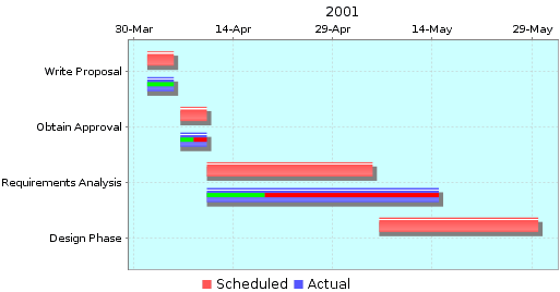

A bar chart displays series as set of horizontal bars that are grouped by category. The categories are arranged horizontally and the values vertically . Bar charts are used to compare value over categories and are ideal for showing the variations in the value of an item over time, or for showing the values of several items at a single point in time.
The Bar chart types include Bar, Bar 3D, Cylinder, Bar Stacked Chart, Bar Stacked Percentage and Gantt Chart. For example, the 3D Bars are used to display data in 3D format which is convenient for visually comparing the Bars. This is used for making comparisons between groups of data particularly when you want to compare one period of time to another (You can use Bar graph to compare sales per quarter). The Gantt Charts are used to display how much percent of the tasks has been completed during the Start and End dates, which helps you monitor the progress of a schedule project at a glimpse. Figure 4.19, “Gantt Chart” displays a common example of Gantt Chart, which uses Percent on the Actual values to show the current progress:
Figure 4.19. Gantt Chart
Gantt Chart

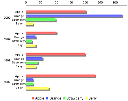

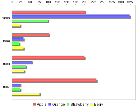

Sub-category is supported for both Bar and Column charts. Figure 4.20, “Bar Chart without Sub-Category” and Figure 4.21, “Bar Chart with Sub-Category” explains for themselves.
Figure 4.20. Bar Chart without Sub-Category
Figure 4.21. Bar Chart with Sub-Category

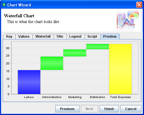

Waterfall
Waterfall charts are a special type of Floating Column Charts. A typical waterfall chart shows how an initial value is increased and decreased by a series of intermediate values, leading to a final value.
Waterfall charts have very specific data requirements. Here is a sample datasource we will use for illustration:
Product     Stage           Value
Product 1   Labour          15.76
Product 1   Administration   8.66
Product 1   Marketing        4.71
Product 1   Distribution     3.51
Product 1   Total Expense   32.64
Every Waterfall datasource requires three fields to be specified, one Key and two Values. The Key in this case is Product. The first value should be the field that describes the composition of the bars, in this case Stage. The second value should be the field that holds the numeric data. In this case Value. If you create a dataset with more or less than two values, it won't render correctly. The output produced for the sample dataset given above is shown in Figure 4.22, “Sample Waterfall Chart”.
Figure 4.22. Sample Waterfall Chart

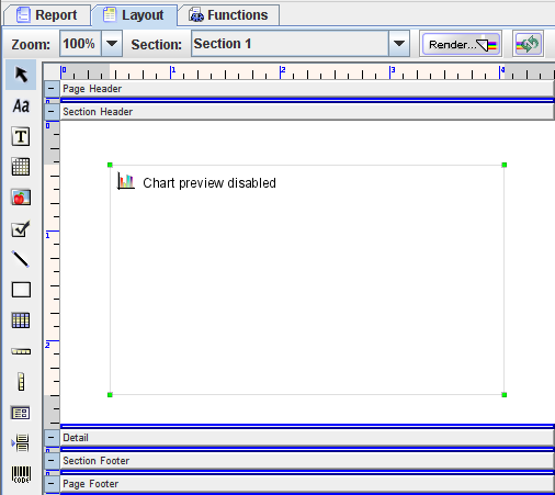

Preview: This displays a chart sample of how it will look like when it is rendered but it is just an indicator as it is displayed at design time it will not have any idea of the runtime data grouping and sorting. Preview is very useful for testing scripts.
Chart Preview on Workspace
Previewing of Chart element on the workspace can be disabled by unchecking the checkbox in the Properties panel, as shown in Figure 4.23, “Properties Panel”. With the Preview function enabled, any changes made including the size, colour and position invokes a re-render of preview. Thus, increasing the chances of performance issues.
Figure 4.23. Properties Panel
Properties Panel
When the Preview function is disabled, the Chart element on the workspace will show that previewing of the Chart is disabled, like in Figure 4.24, “Chart Preview Disabled”.
Figure 4.24. Chart Preview Disabled

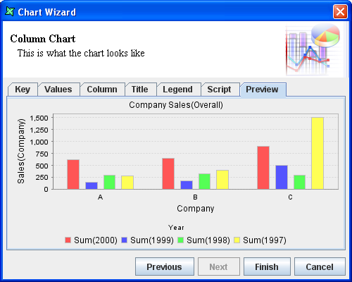

Creating Charts
The steps followed for creating Area, Bar, Column, Line, Waterfall and XY Charts are similar except for that in Column Charts, it consists of Column tab and in Area Charts there is an Area tab but the properties in these tabs are all the same. The steps for creating a Column Chart is given below. In this example you can see the difference between the Column Chart by selecting OverAll, OverGroup, etc.

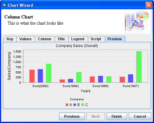

Here's how to add a Column Chart based on the Company sales for four consecutive years.
  1. Add a Blank report with ChartData.ds as the default data source which points to the Fruit.csv file.
  2. Invoke the Section Wizard on Section 1 and sort based on CompanyName in Ascending order and group on Each Value. Make sure the group header is enabled.
  3. Select the Layout tab and place the Chart element in the Section header. In the Wizard that appears select Default from the DataSource combo box. Select the Over All option and click on the Next button.
  4. In this screen select the Column category and Column as the chart type. Click on the Next button.
  5. In the Key tab select Company from the fields listed in the table.
  6. In the Values tab click the Add button to add a value. Select Operation from the Field type combo box and Sum from the Operation combo box. Select 2000 from the list of fields and click on the Ok button. Follow the same procedure and add the 1999, 1998 and 1997 fields.
  7. Select the column tab and enter "Years" as the label for X Axis and "Sales(Company)" as the label for Y axis. button.
  8. Select the Title tab. By default Literal is the field type. Enter Company Sales(Over All) in the text field and select North as the position. Select Legend tab and enter the legend title as Company and select South from the position combo box.
  9. After entering all the values the preview should appear as shown in Figure 4.25, “Column Chart”. Click on the Finish button to embed the chart in the report.
  10. Next, expand the group header so that it is large enough to accommodate a chart. Copy the Chart element from the Section Header and paste it into the Group Header. You can use the popup menu for copying and pasting, or the accelerator keys Control-C and Control-V. In order to paste into the group header using the keyboard, you must select group header first. The currently selected header shows a highlighted ruler down the left hand side.
  11. Now edit the Chart element in the Group Header so that it is Over Group instead of Over All. You can also change the chart title to "Company Sales (Over Group)" so that the charts can be distinguished.
  12. Now click the Render button and render as Glint. You will see that the Chart element in the Section header displays the Over All sum(sales) of the companies for the respective years. The Chart element placed in the Group header will display the Over group sum(sales) of each company.
Figure 4.25. Column Chart
Column Chart
In the Column tab an Invert Data check box is available. There are three data items per point in a chart: Key, Value and Amount. So when you turn on the Invert Data check box the Value and Key are switched over. The first data item controls the Overall grouping, including legend and allocation of colours. The second data item controls the clustering of values along X-axis (Column Chart). The third data items gives you the height of the bar. So, by inverting the data we get the preview as shown in Figure 4.26, “Inverted Data Column Chart”.

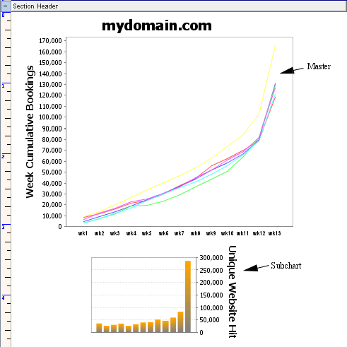

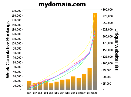

Creating Dual Axis Charts
In order to create a dual axis chart like the one shown in Figure 4.27, “Dual Axis Chart”, you need to be able to control each side of the chart independently. To make this easy, you can create two independent chart plots and then merge them into one chart.
Figure 4.27. Dual Axis Chart
Dual Axis Chart
We will call the first chart, that will show the final result the Master. The other chart, which will be merged in to the Master we will call the Subchart. The two charts to be merged are shown in Figure 4.28, “Dual Axis Chart Design”.
Figure 4.28. Dual Axis Chart Design
You will notice that one has the Y axis on the left and the other on the right. To put a Y axis on the right you need to add this script:
importClass(Packages.org.jfree.chart.axis.AxisLocation);
plot.setRangeAxisLocation(AxisLocation.TOP_OR_RIGHT);
In the designer you will see separate charts, so you can configure them independently. In the rendered output you will only see one combined chart.
  1. Create the two charts and ensure the Subchart Name is set ("Subchart" is used here).
  2. In the Properties panel, set the Subchart visibility to false.
  3. Go to the Shapes tab, right click on Master and select Wizard to access the Chart Wizard dialog box.
  4. Click Next until you reach the Line Chart section. Go to the Script tab.
  5. Key in the following code, modifying it based on your design:
    importClass(Packages.com.elixirtech.report2.logical.renderer.\
      ChartRenderer);
    if (cxt!=null) // real rendering
      var subChart = cxt.getRawElementByName("Subchart");
      var subPlot = ChartRenderer.buildChart(cxt,subChart).plot;
      var axis = subPlot.getRangeAxis();
      axis.setAutoRange(false);
      plot.setRangeAxis(1,axis);
      plot.setDataset(1,subPlot.getDataset());
      plot.setRenderer(1,subPlot.getRenderer());
      plot.mapDatasetToRangeAxis(1,1);
    (the text here is wrapped at the \ character on the first line - remove this and concatenate the first two lines together).
Note
When you have finished designing your two charts, you can put the Subchart anywhere you want - even on top of, or behind the Master as it won't appear in the output. This way it doesn't occupy space you need for other report components
