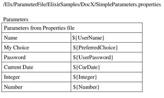

Parameter
A parameter is "declared" when user enters a string like ${parameterName} within a DocX report. A parameter is "defined" when a value is supplied. A report may have multiple declarations and mixed with normal text. For example:
My name is ${first} ${last}.
There are 2 ways of defining parameters.
  1. Define Parameter Individually - Defining each parameter one by one in the DocX report. (It can be defined as: /Elx/Parameter/<ParameterName>/Value)
    For example:
    /Elx/Parameter/Text/${User##MyName}
  2. Load Properties File - All parameters declared are to be placed in a Properties file together with the desired elements defined. It can be defined as: /Elx/ParameterFile/<PropertiesFileName>.properties
    The parameters should follow the following format: <ParameterName>=Value For example:
    Password=${Password#password#MyPassword}
    Name=${User##MyName}
    PreferredChoice=${MyChoice#choice(Apple,Orange,Pear)#Pear}
    Date=${Date#date#2011-06-01}
    Integer=${Integer#integer#20}
    Number=${Number#number#25.6}

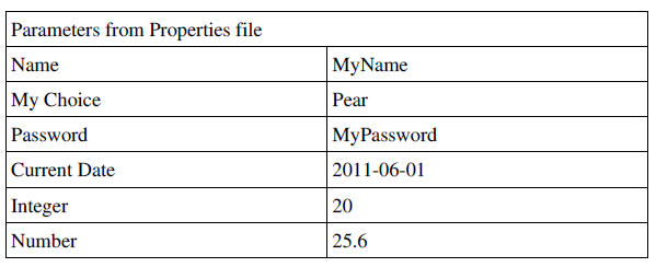

    The following, Figure 8.1, “Parameters in DocX Report”, is how a DocX report will look with the parameters declared and using a Properties file. When rendered, the outcome will be as seen in Figure 8.2, “Rendered DocX Report”. For more information about rendering a DocX report, refer to the section called “Render DocX Report” at the end of this chapter.
    Figure 8.1. Parameters in DocX Report
    Figure 8.2. Rendered DocX Report
