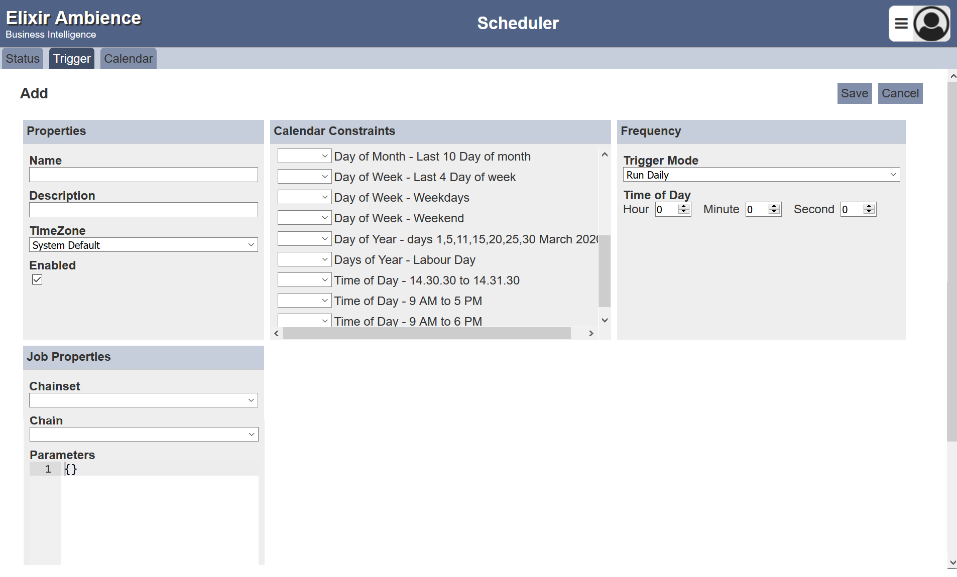

Add Trigger
The “Add” page displays the trigger’s attributes.
In the “Properties” panel, enter a unique “Name” for the trigger, set the optional “Description” and “TimeZone” fields. Select the “Enabled” checkbox to enable the trigger to fire. The “TimeZone” field is by default set to the your system’s time zone. If you are unsure of the time zone set on your deployment server, then selecting an explicit time zone, rather than using the system default will ensure your trigger runs at the time you choose.
In the “Calendar Constraints” panel, select the appropriate constraint(s) by including or excluding it. Refer to Calender for more information on how to set calendar constraint.
In the “Frequency” panel, select the appropriate “Trigger Mode” and its corresponding fields.
In the “Job Properties” panel, select the appropriate chainset and chain, and set up “Parameters” field if it is required to pass any parameters into the chain.
| Properties | |||||
| Name | Unique name assigned to the trigger. | Y | Text field | Any text. | Empty string |
| Description | Brief description of the trigger. | Y | Text field | Any text | Empty string |
| TimeZone | Time zone of the trigger to be run. | N | Drop-down list | Select from list | System default |
| Enabled | Enable or disable trigger. | Y | Checkbox | Enable or disable | Enabled |
| Calendar Constraints | |||||
| List of calendar constraints | A list of calendar constraints defined in the Calendar page. Each calendar constraint can be unselected (not used) or selected (to include or exclude). |
| Frequency | |||||
| Trigger Mode | Select the trigger mode from the list of options: - Run once only - Run hourly - Run daily - Run weekly - Run monthly - Cron expression |
| Field(s) for above selection | Depending on the above selection, one or more fields may appear. By default, the field “Time of Day” is shown, since Run daily is the default. |
| Job Properties | |||||
| Chainset | Selects the appropriate chainset for the report. | Y | Drop-down list | Select from list | Empty string |
| Chain | Selects the appropriate chain from the chainset. | Y | Drop-down list | Select from list | Empty string |
| Parameters | Defines any parameters required to be passed to the the chain. | N | Text field | Any text | Empty string |
Click on the “Save” button to add the trigger to list. Click on the “Cancel” button to abort the action.

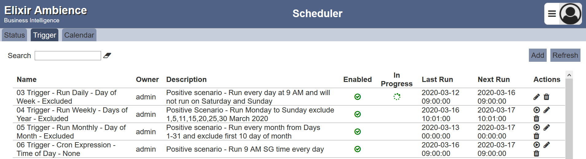

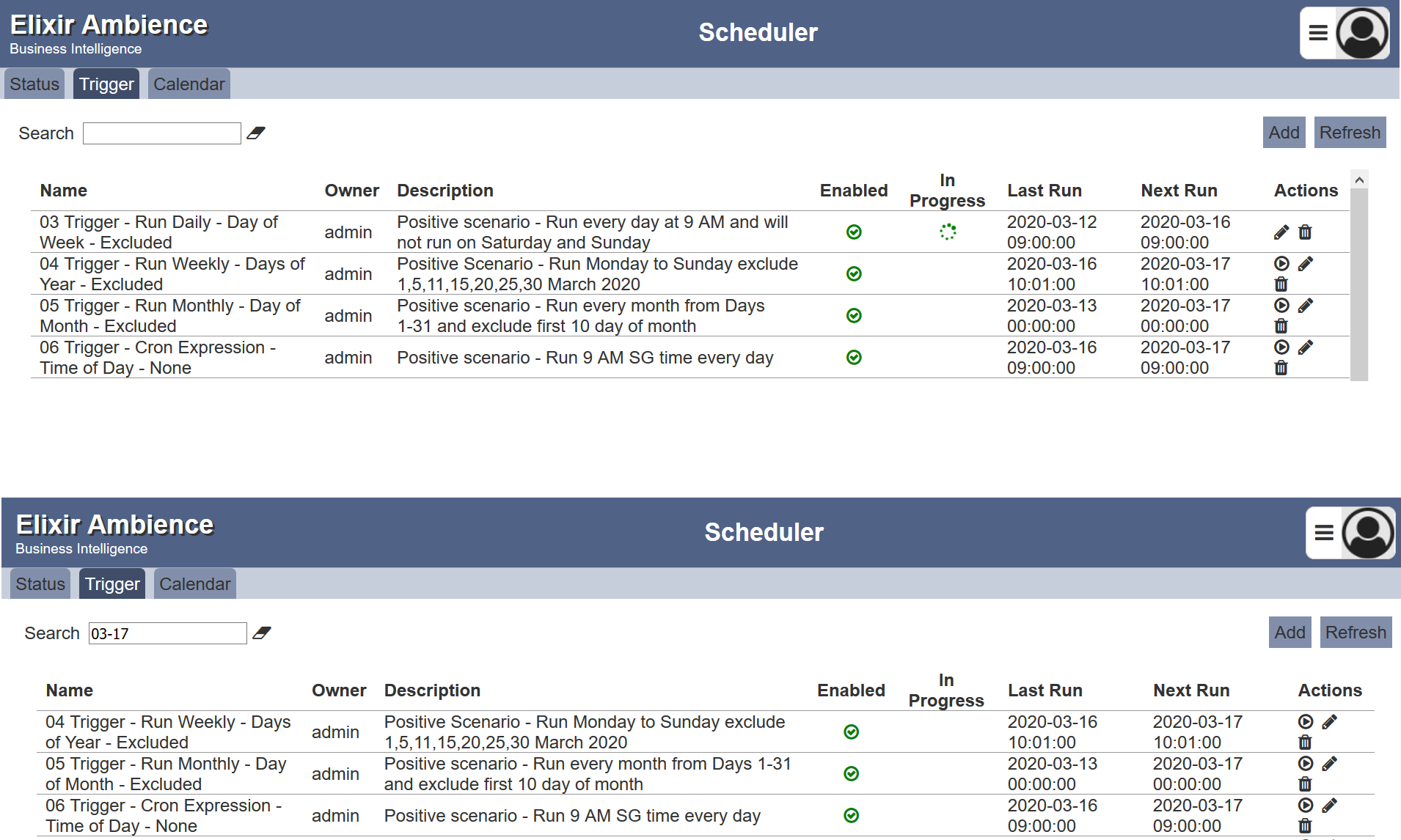

Refresh Trigger
- Last Run
- Next Run
Manually Run Trigger
Once a trigger has been set up and enabled, it will run automatically once the defined date and time is reached, and will calculate the next run time. When the trigger is not due to run, you can manually run the trigger by clicking on the “Run Now” icon under the “Actions” column corresponding to the trigger.
Do note that the “Run Now” icon is not available for jobs that are currently running (that is, in progress). A job that is running is indicated by a green ring under the “In Progress” column corresponding to the trigger.

Reset Trigger
A trigger marked as “In Progress” will not fire again until it has finished. The in progress state may be incorrect if one of the server nodes crashed while the job is running. If you are sure that it is not running, you can reset the status of the trigger by clicking on the “Edit” icon under the “Actions” column corresponding to the trigger. In “Job Status” panel, check the “Reset In Progress” checkbox.
Click on the “Save” button on the upper right corner of the page to save the change. Click on the “Cancel” button to abort the action.
