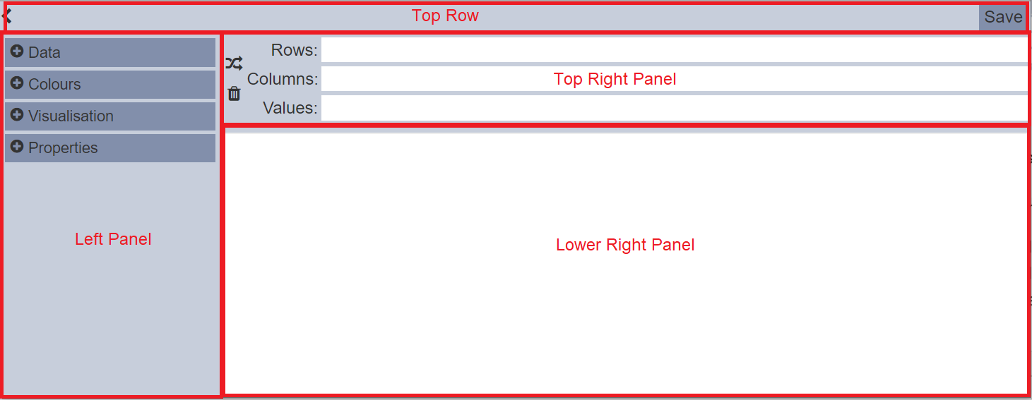

The Design page is displayed by default. It is divided into 4 portions:
- Top row - Consists of the “Close” icon and “Save” button
- Left panel - Displays data, colour palette, visualisation and properties
- Lower right panel - Displays visualisation

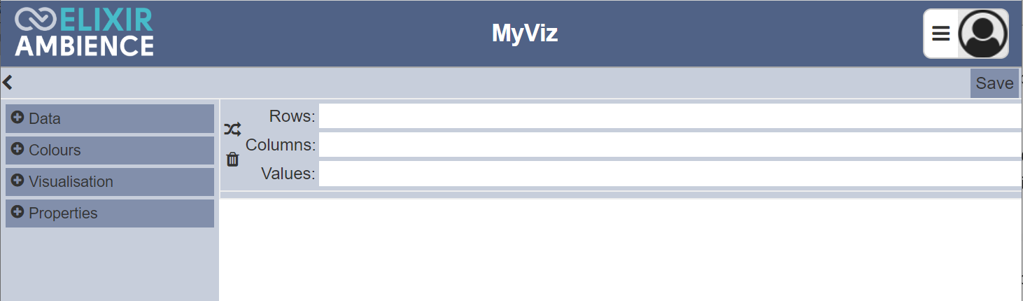

Top Row
The top row consists on the < “Close” icon and the “Save” button.
The “Close” icon allows you to close the Design page and goes to the View page. The “Save” button saves the changes made to the visualisation.
Left Panel
The left panel consists of 4 sections:
- Colours - List of colour palettes
- Visualisation - List of views, charts and tables
- Properties - List of parameters, depends on the visualisation selection
Top Right Panel
This panel allows you to set the fields for the view and it consists of 3 fields:
- Rows - Defines the XAxis of the view
- Columns - Defines the YAxis of the view
- Values - Defines the field as the value in the cell

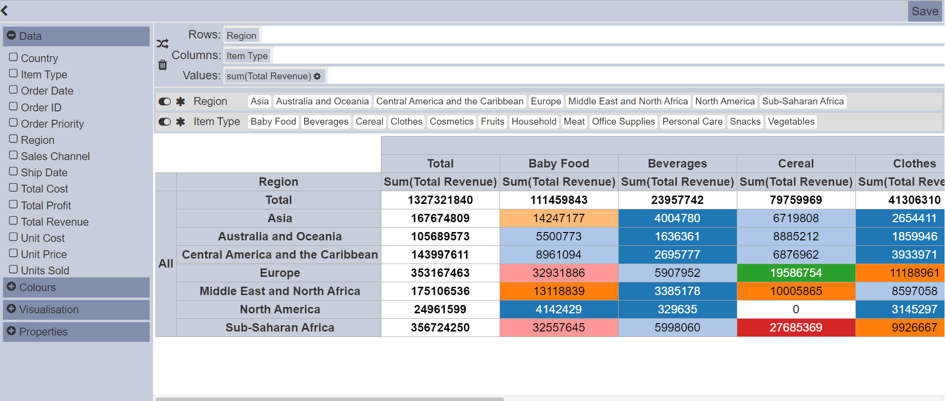

Add Data
Click on the “+” icon of ’Data“ in the left panel. The list of fields of the dataset is displayed. Drag and drop the desired data into their respective fields (”Rows“, ”Columns“ and ”Values“) in the top right panel. Once data is dropped into the ”Rows“ or ”Columns“ field, a row is added at the top of the lower right panel. In this example, 2 rows are added for ”Region“ and ”Item Type".
By default, “sum” operation is used in the “Values” field. You can change the operation by clicking on the
“Change Operation” icon. A dialog box will appear. In the dialog box, select the desired operation from the drop-down list.
You can swap the data in the “Rows” and “Columns” fields by clicking on the
“Switch Rows and Columns” icon. To delete the data in the field, drag and drop the data towards the
“Drag Here To Delete” icon.
Click on the “-” icon to collapse “Data”. Click on the “Save” button at the upper right corner of the page to save your changes.

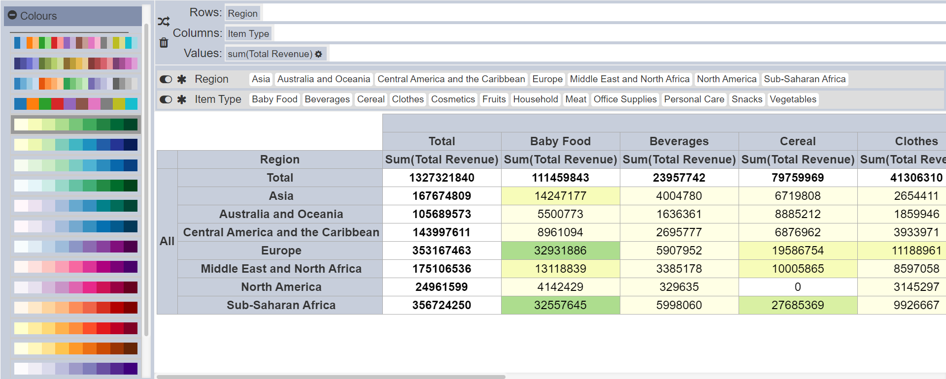

Select Colour
Click on the “+” icon next to “Colours” in the left panel and a list of available colour palette will appear. By default the first colour palette is selected. Select the desired colour palette and click on the “-” icon to collapse “Colours”. Click on the “Save” button at the upper right corner of the page to save the changes.

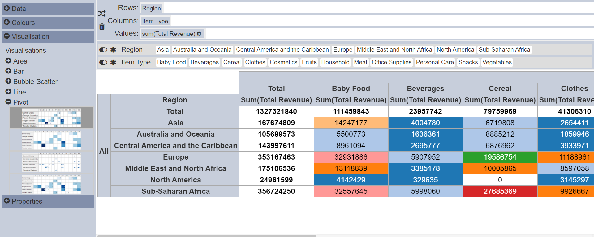

Visualisation

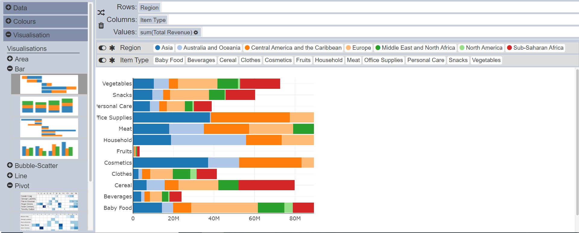

Click on the “+” icon next to “Visualisation” in the left panel and a list of visualisations will appear.
There are several types of visualisations in the list. For each type of visualisation, there are several variations. By default, the first type of pivot table is selected.

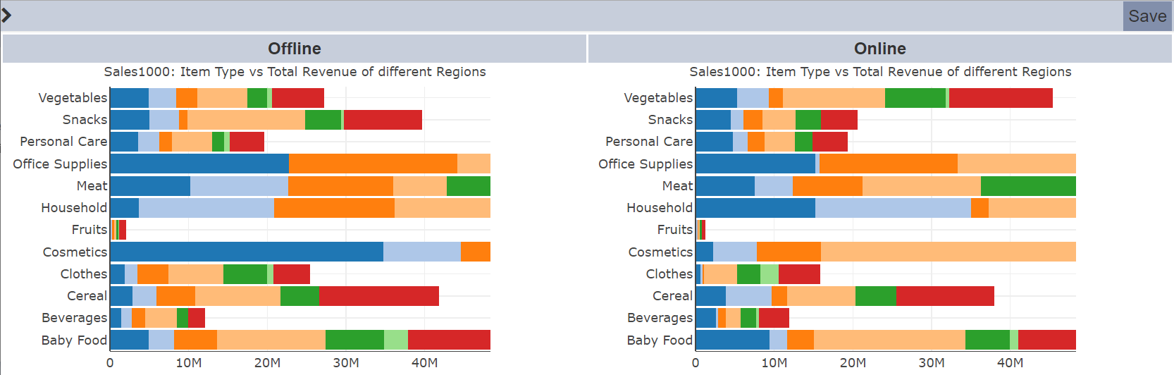

To select other visualisation, click on the “+” icon next to the desired visualisation, for example, the first variation in “Bar”. The view in the lower right panel will change according to your selection. The colours in the bar chart corresponds to the colours in “Region”.
You can click on the “-” icons to collapse the visualisations. Click on the “Save” button at the upper right corner of the page to save the changes.

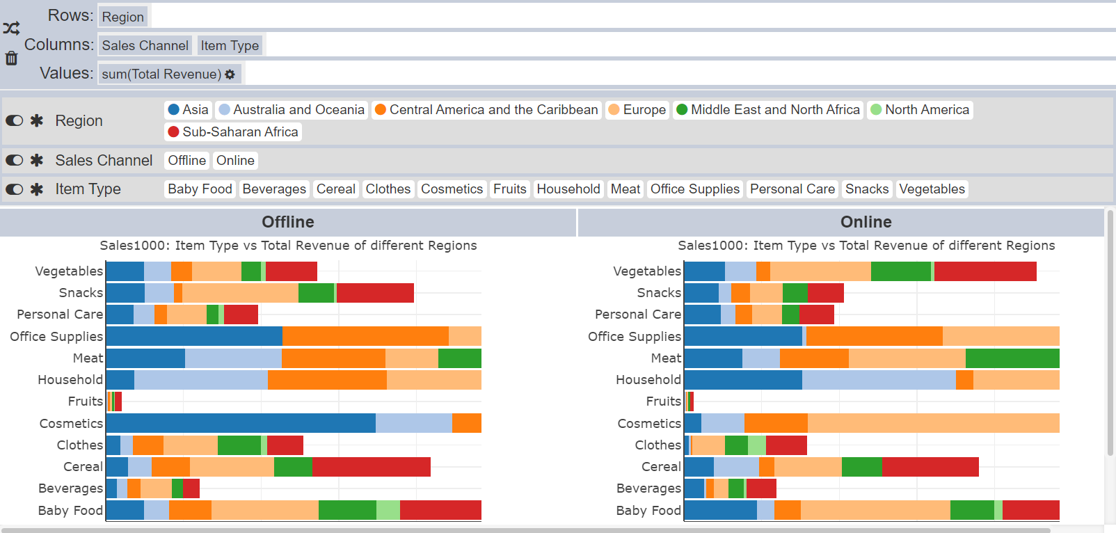

Add More Data

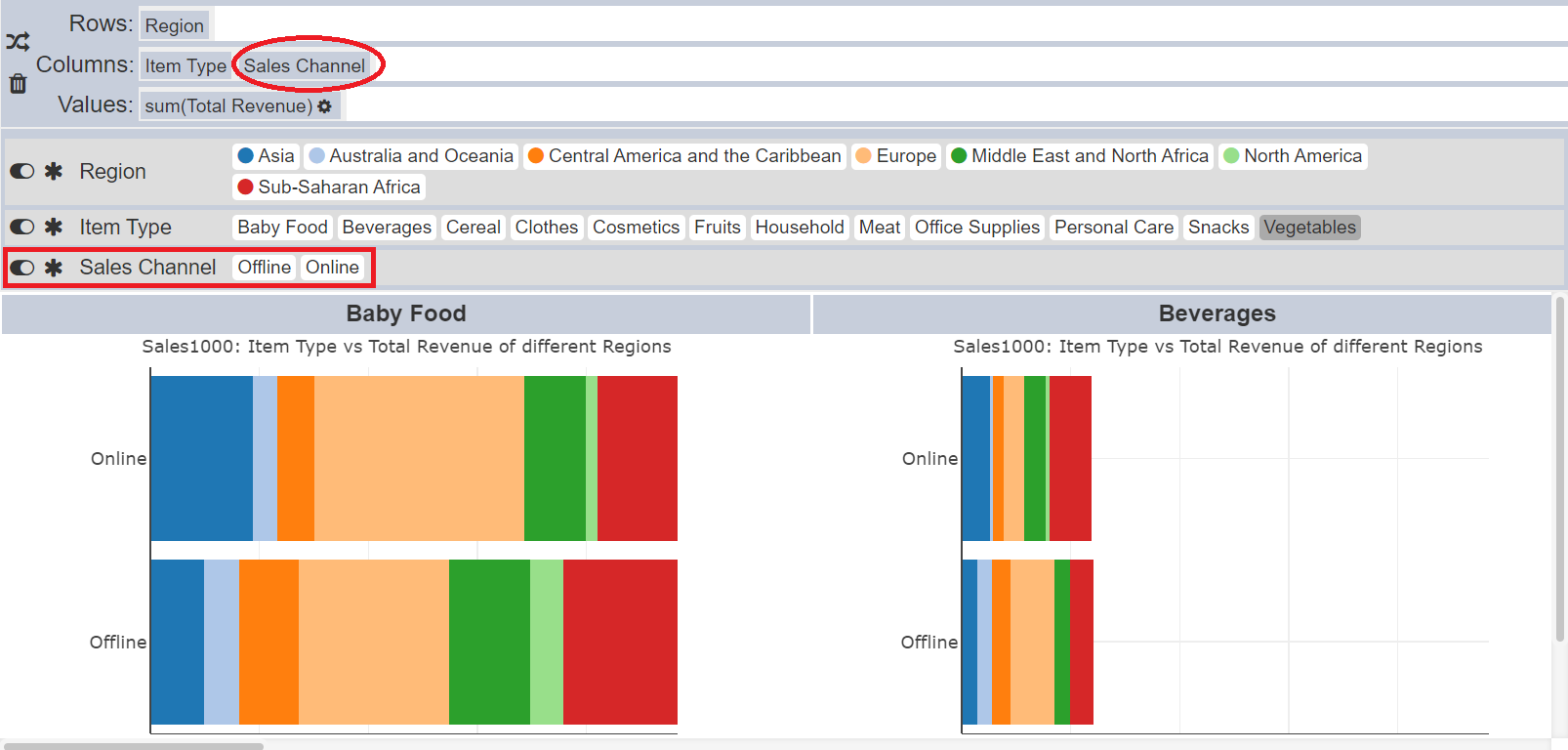

You can add more data into the “Rows”, “Columns” and “Values” fields. Simply drag and drop the desired data into the textbox next to the field.
In the example above, “Sales Channel” is dropped into the “Columns” field and an extra row is added in the lower right panel. The view(s) in the lower right panel will change accordingly. In this case, several bar charts are created.
The last data in the “Columns” field will be the YAxis. If this is not desired, simply drag and drop “Item Type” in front of “Sales Channel” to swap the data.

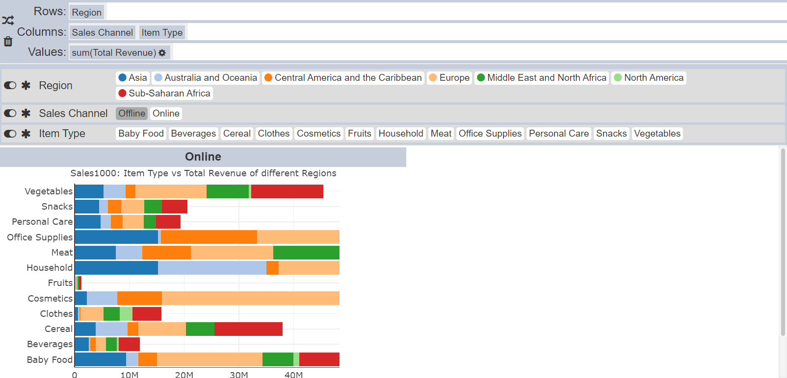

Select Data

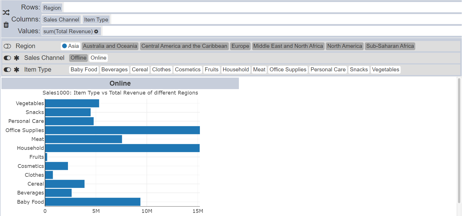

By default all values of the data in the “Rows” and “Columns” are selected and displayed. You can unselect a value by clicking on the value itself. In the example, “Offline” is unselected in the “Sales Channel” row. The “Offline” value is grayed out and the view shows “Online” bar chart only.

In the example, multiple select mode is switched off for “Region”. The view displays the value “Asia” (by default) for “Online”.

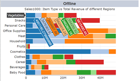

Hover over the view and the details will be displayed.
