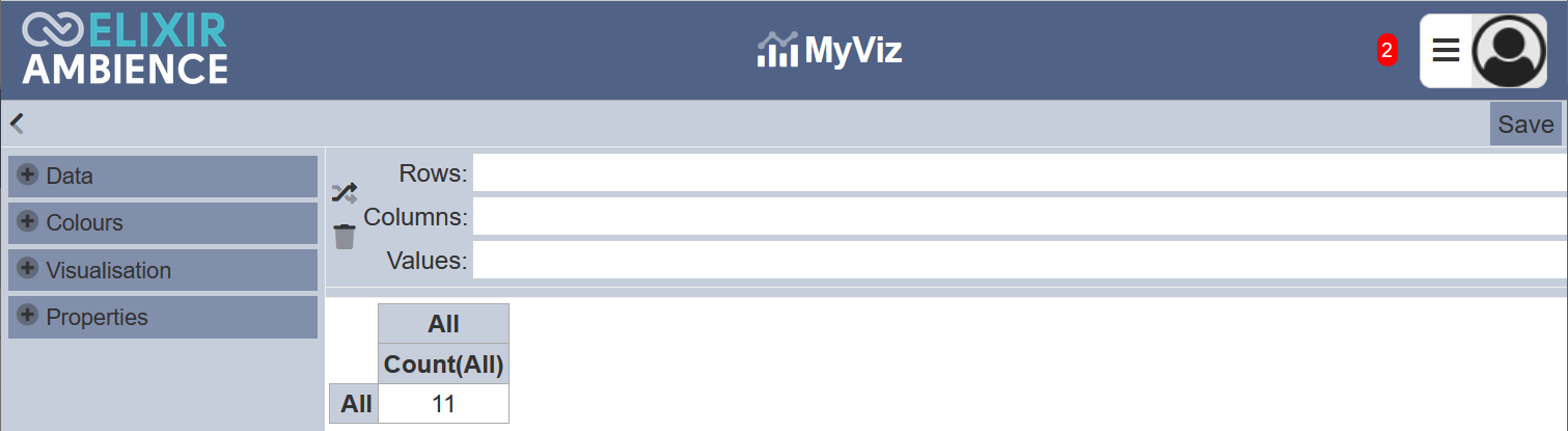

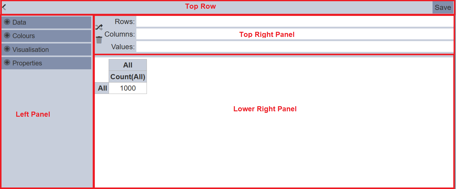

The Design page is displayed by default. It is divided into four portions:
- Top row - Consists of the “Close” icon and “Save” button
- Left panel - Displays data, colour palette, visualisation and properties
- Lower right panel - Displays visualisation
Top Row
The top row consists on the < “Close” icon and the “Save” button.
The “Close” icon allows you to close the Design page and goes to the View page. The “Save” button saves the changes made to the visualisation.

Top Right Panel
This panel allows you to set the fields for the view and it consists of 3 fields:
- Rows - Defines the XAxis of the view
- Columns - Defines the YAxis of the view
- Values - Defines the field as the value in the cell
Drag and drop the data to the desired fields (“Rows”, “Columns” and “Values”). If a data is dragged and dropped into the “Values” field, depending on the data type, by default the “sum” operation is selected. You can change the operation by clicking on the
“Change Operation” icon on the right of the field. A dialog box will appear. In the dialog box, select the desired operation from the drop-down list. Click on the “Save” button to save the change.

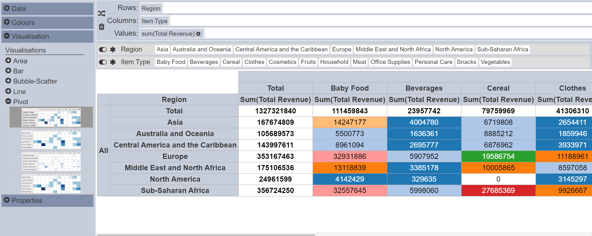

Once “Rows”, “Columns” and “Values” fields are populated, the visualisation will appear in the lower right panel. By default pivot table is selected.
You can add more data into the 3 fields by drag and drop. You can also swap the data around. The last data in the “Rows” and “Columns” fields will be the axis.

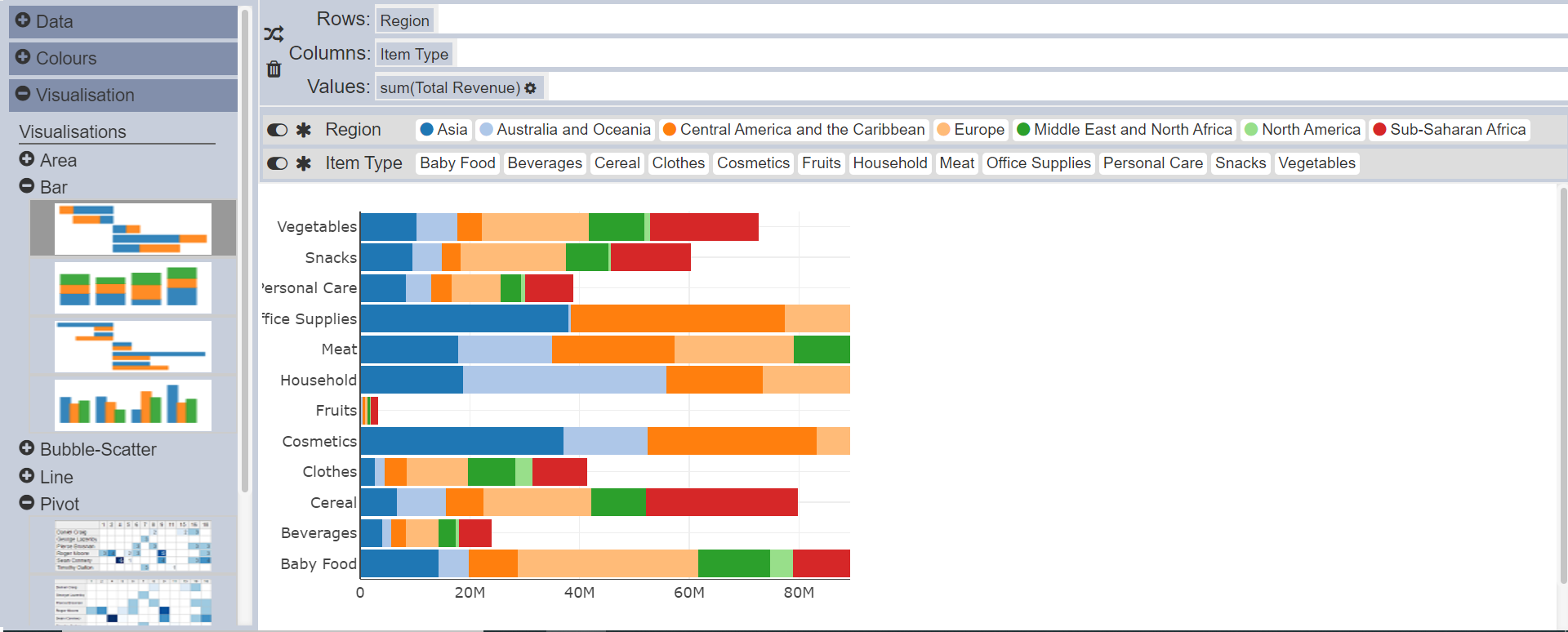

Add Data
Click on the “+” icon of ’Data“ in the left panel. The list of fields of the dataset is displayed. Drag and drop the desired data into their respective fields (”Rows“, ”Columns“ and ”Values“) in the top right panel. Once data is dropped into the ”Rows“ or ”Columns“ field, a row is added at the top of the lower right panel. In this example, 2 rows are added for ”Region“ and ”Item Type".

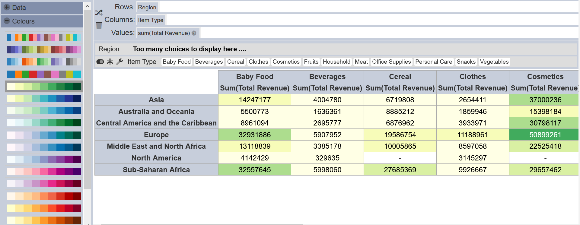

Select Colour
Click on the “+” icon next to “Colours” in the left panel and a list of available colour palette will appear. By default the first colour palette is selected. Select the desired colour palette and click on the “-” icon to collapse “Colours”. Click on the “Save” button at the upper right corner of the page to save the changes.

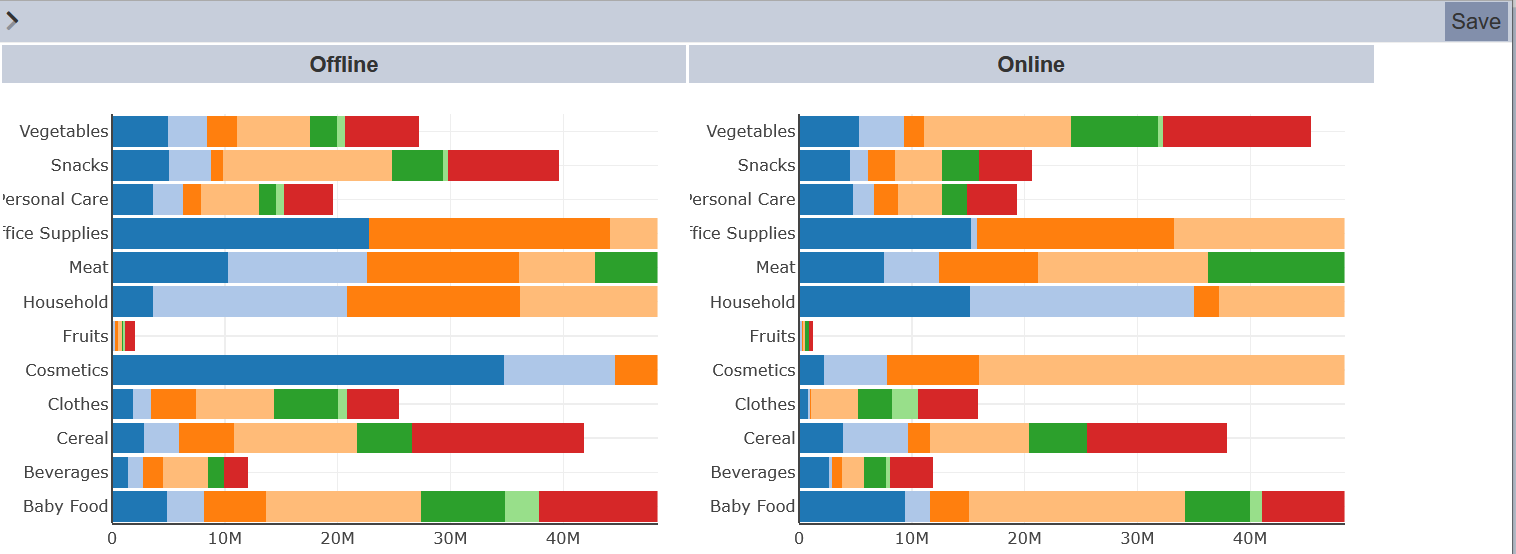

Visualisation
Click on the “+” icon next to “Visualisation” in the left panel and a list of visualisations will appear.
There are several types of visualisations in the list. For each type of visualisation, there are several variations. By default, the first type of pivot table is selected.
To select other visualisation, click on the “+” icon next to the desired visualisation, for example, the first variation in “Bar”. The view in the lower right panel will change according to your selection. The colours in the bar chart corresponds to the colours in “Region”.
You can click on the “-” icons to collapse the visualisations. Click on the “Save” button at the upper right corner of the page to save the changes.

Add More Data

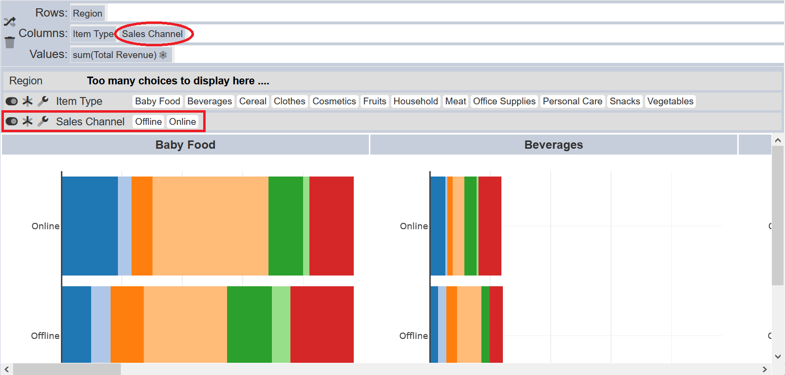

You can add more data into the “Rows”, “Columns” and “Values” fields. Simply drag and drop the desired data into the textbox next to the field.
In the example above, “Sales Channel” is dropped into the “Columns” field and an extra row is added in the lower right panel. The view(s) in the lower right panel will change accordingly. In this case, several bar charts are created.
The last data in the “Columns” field will be the YAxis. If this is not desired, simply drag and drop “Item Type” in front of “Sales Channel” to swap the data.

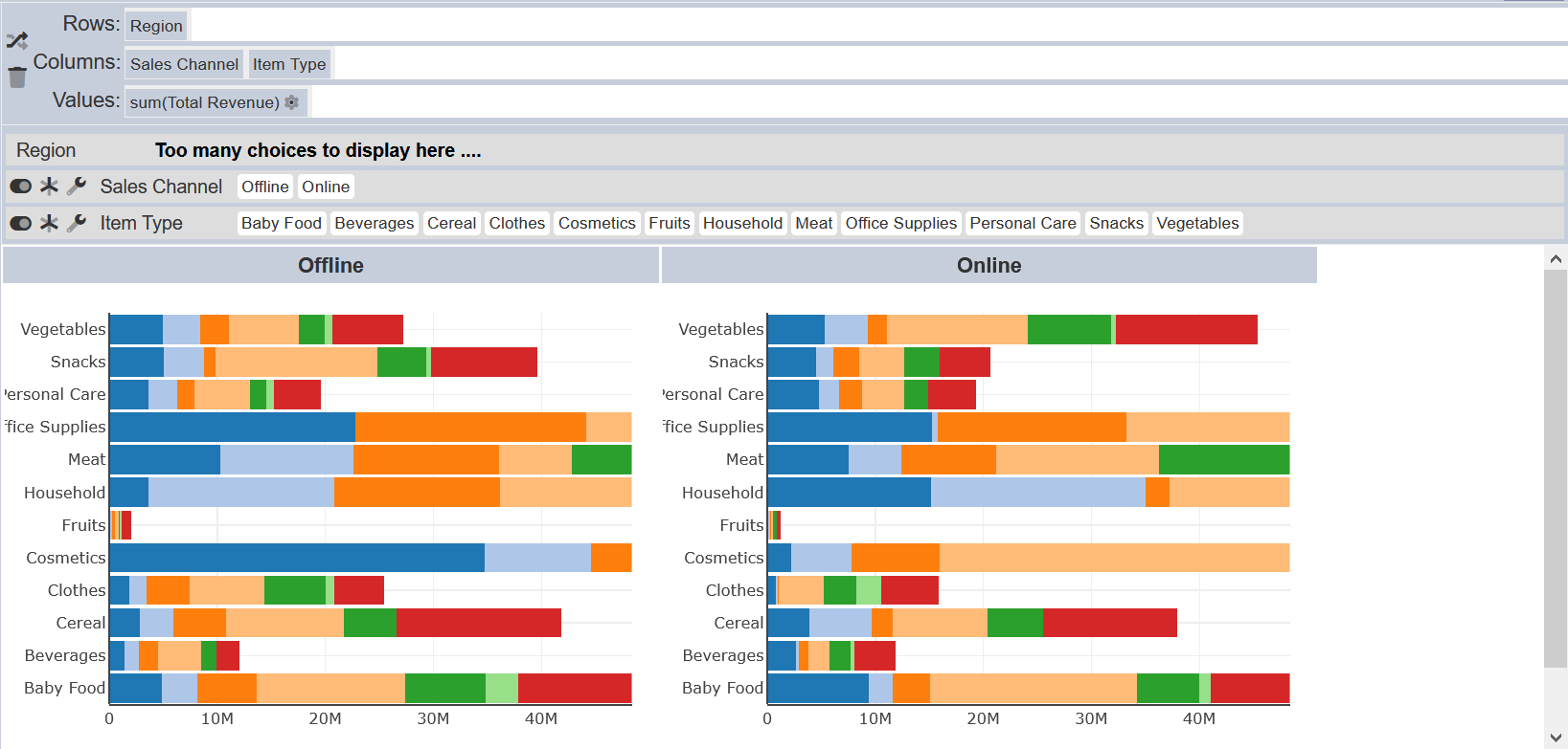

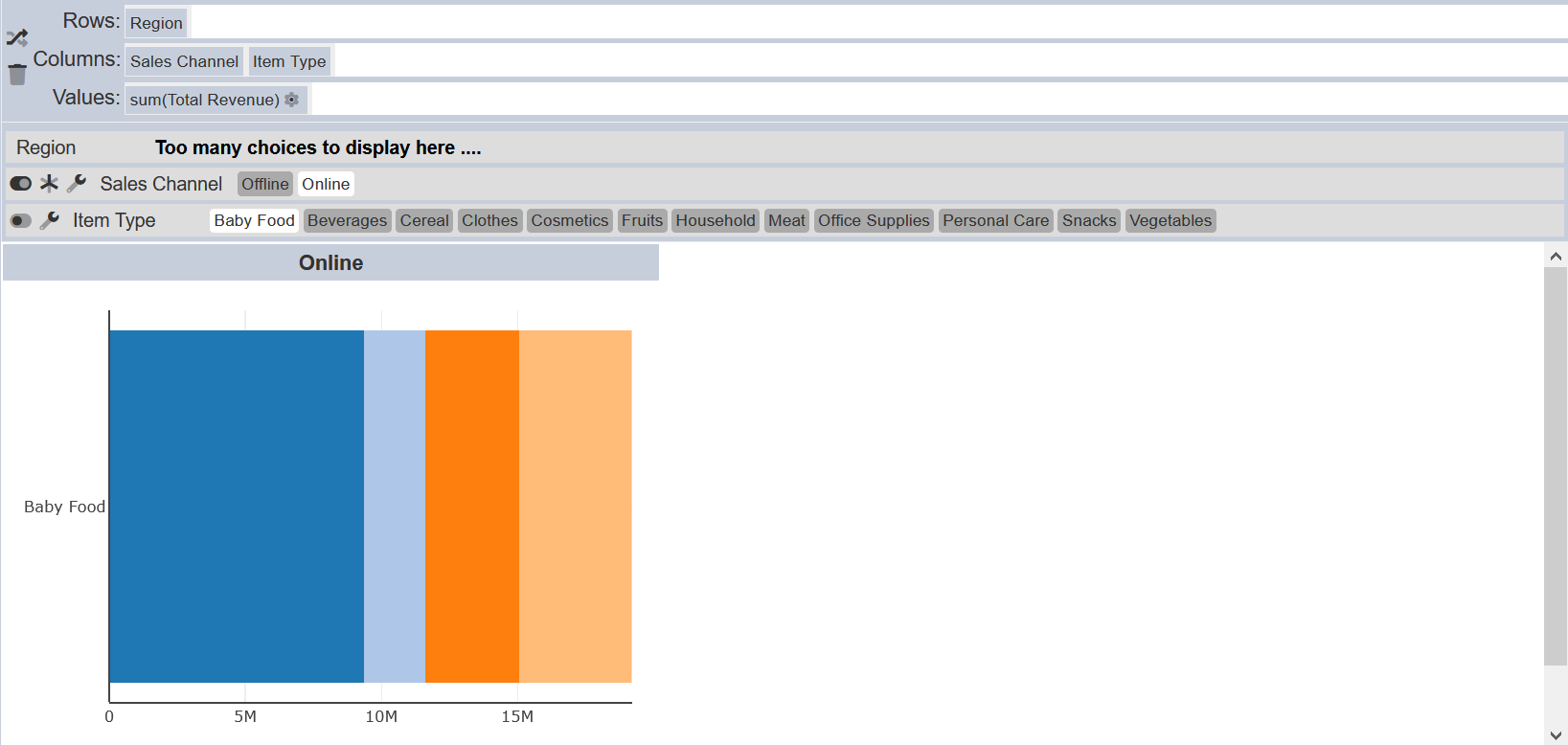

Select Data

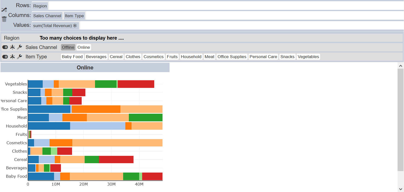

By default all values of the data in the “Rows” and “Columns” are selected and displayed. You can unselect a value by clicking on the value itself. In the example, “Offline” is unselected in the “Sales Channel” row. The “Offline” value is grayed out and the view shows “Online” bar chart only.
If several values have been unselected, to re-select the values, either click in the values one by one or click on the
“Select All” icon to select all values. The
“Multiple Select” icon allows you to switch from multiple select to single select. In multiple select mode, you can select more than one value, while in single select mode, you can select only one value at a time. Do note that in single select mode, the
icon will not be available and the first value in the data is selected.
In the example, multiple select mode is switched off for “Item Type”. The view displays the value “Baby Food” (by default) for “Online”.

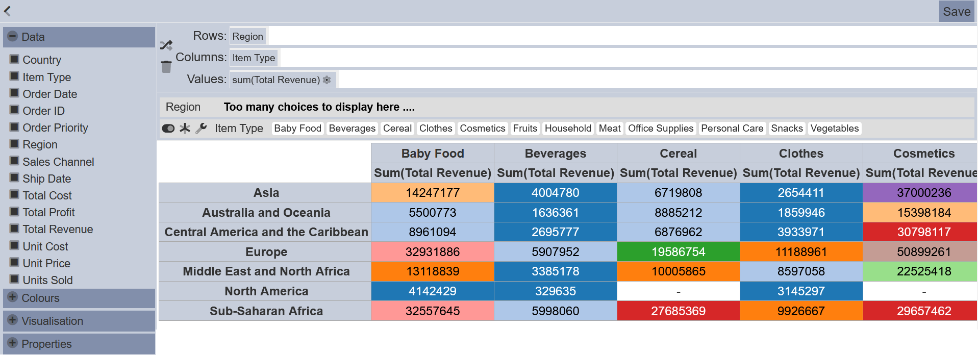

Filter Data
You can filter the values in the data using the “Data” section in the left panel. To do so, click on the icon next to the data you wish to filter. A list of values for the data along with a search textbox will be displayed. Click on the values to select, the view will change according to your selection.
In this example, “Baby Food”, “Beverages” and “Cereal” are selected and the view changes according to your selection. You can search for the values by using the textbox. To remove the selected value, click on the “X” icon next to the value. To close the filter, unselect the checkbox next to the data and the view will display all the values.
If the data to be filtered is numeric, you will need to key in a range of values in the textboxes. The view in the lower right panel will change accordingly. To reset the range, click on the “-” icon above the textbox. Unselect the checkbox of the data to close the filter.

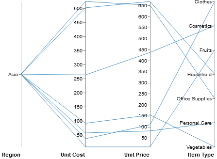

Using Sync Column

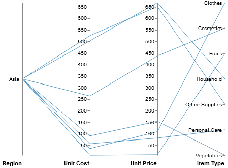

Below is an example of using the “Sync Column” property in the “View” properties when using the “Parallel Coordinates” option in the “Visualisation” section. When the “Sync Column” is not used, the columns “Unit Cost” and “Unit Price” both show different Y-axis in terms of their values.
This make it harder to read. You can synchronise both columns using the “Sync Column” sub-properties. In the drop-down list, select the desired column to sync. In this case, it will be “Unit Cost”. To add another column, click on the “+” icon below. Select another field “Unit Price”. Now the columns are sync-ed, both columns have the value “650” as their maximum value in the Y-axis. It make it easier to read and compare.
Do note that this property applies only to “Parallel Coordinates” visualisation only.

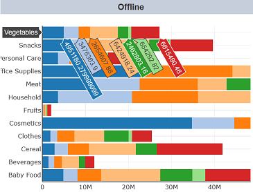

Hover over the view and the details will be displayed.
