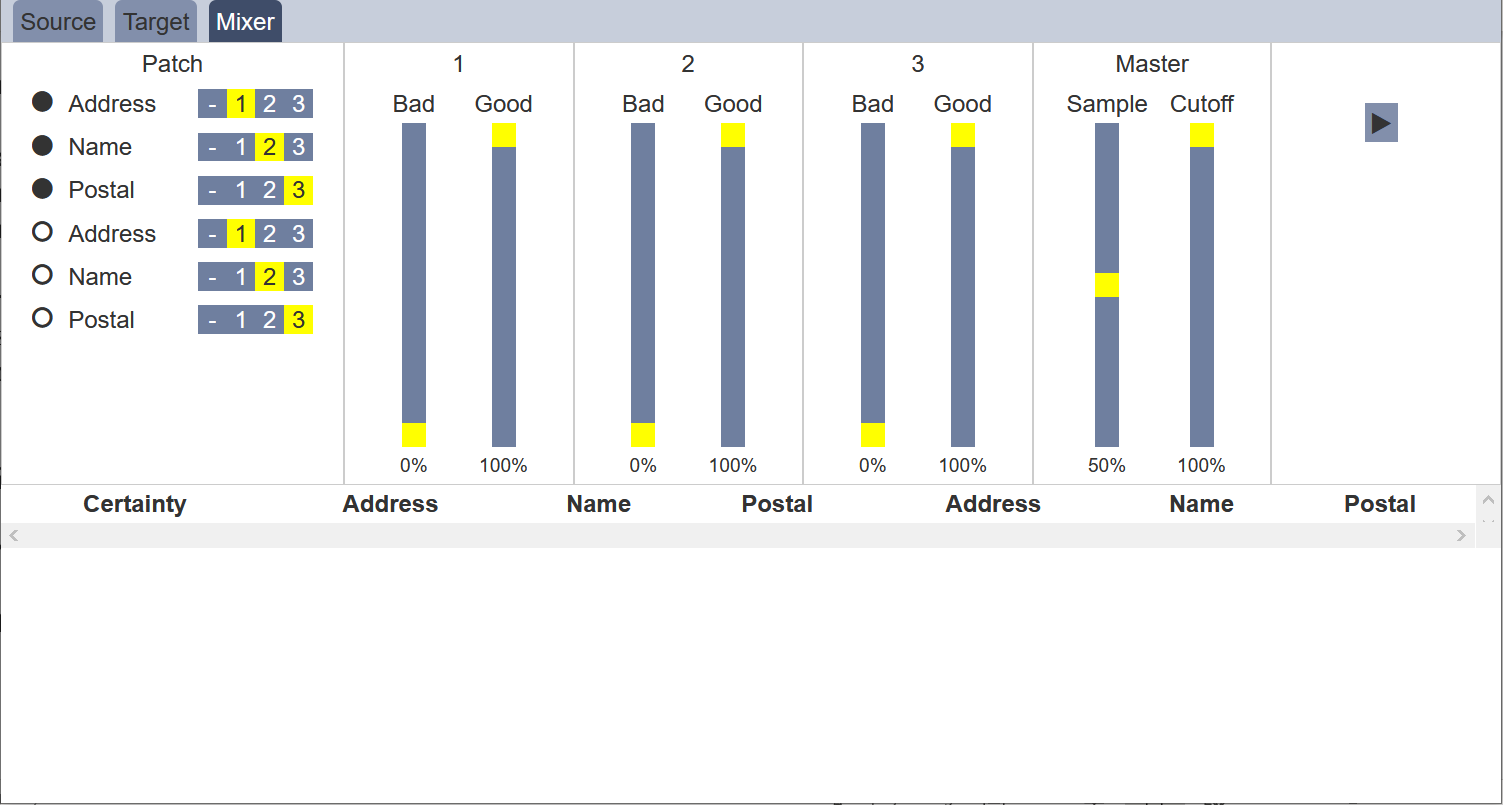

Mixer
The Mixer tab allows you to configure and perform the data mixing.
It consists of several parts:
- Patch Bay
- Channel Selectors
- Master Control
- Playback Control
- Mixer Output Panel

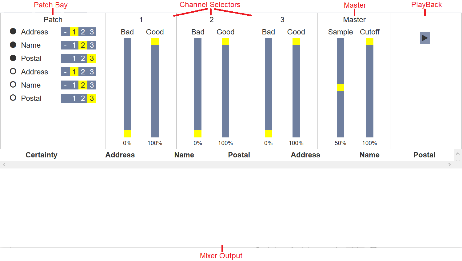

Patch Bay
The Patch Bay allows you to select which channel to be used for each selected field in the Source and Target tab.
The first 3 rows indicate the 3 fields selected for “Word Frequency” in the Source tab and the last 3 rows indicates the 3 fields selected for “Word Frequency” in the Target tab.
Click on the appropriate numeral to assign a channel to the column. For a fresh mix, no column is selected.
Channel Selectors
There are 3 Channel Selectors which allow you to select how the columns are to be mixed together. Each column in the Source and Target data sources are attached to a mixing selector.
Master Control
The Master Control consists of 2 parameters, namely “Sample” and “Cutoff”, for the mixing in each channel. The “Sample” parameter denotes the fraction of the dataset used to generate the on-screen mix. The “Cutoff” parameter denotes the minimum certainty required before the mixed data record is displayed in the demo display.
Playback Control
The Playback Control is located on the right most of the Data Mixer page. It consists of buttons that allows you to run, stop or pause the playback.
By default only the
“Run” button is displayed. The other 2 buttons will only appear when the mixing is in process.
Once the configuration in the Patch Bay, Channel Selectors and Master Control are set, click on the
button to start the playback to obtain the mix. After clicking on the
button, the
“Pause” and
“Stop” buttons will appear in the Playback Controls. The mixer output is displayed in the Mixer Output Panel. The process may take a few seconds.
You may click on the
or
button that appear to stop or pause and resume the playback respectively at any time.
Mixer Output Panel
The Mixer Output Panel displays the result of executing the mix. The leftmost column “Certainty” displays the predicted accuracy of the mix. Click on the row to see the details of the weights assigned to the various components below the selected row.
The hide the details, click on the row again.
