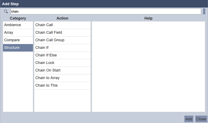

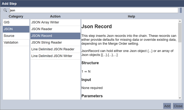

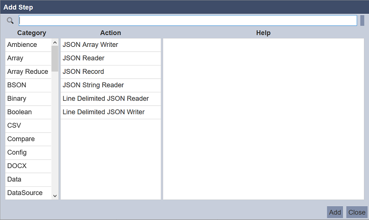

Add Step
If more steps are needed, simply continue selecting other steps then click on the Add button. Click on the Close button after adding steps. If any step was added, closing would instantly open the Edit Step dialog box corresponding to the last step added.

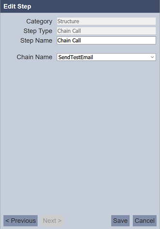

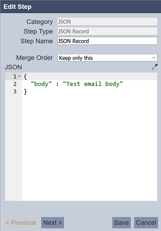

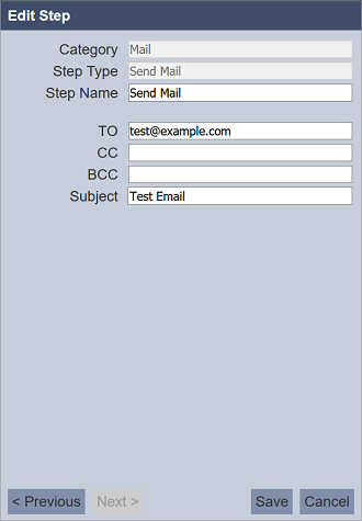

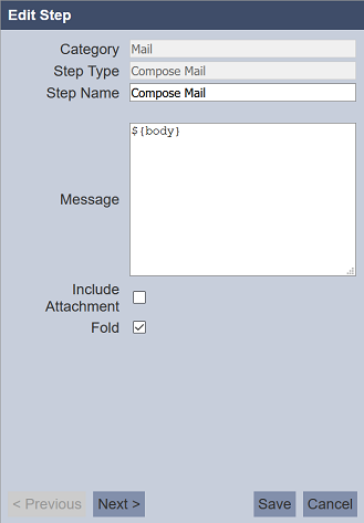

Configure Step
To configure an existing step, click on the
Edit Step button corresponding the step.

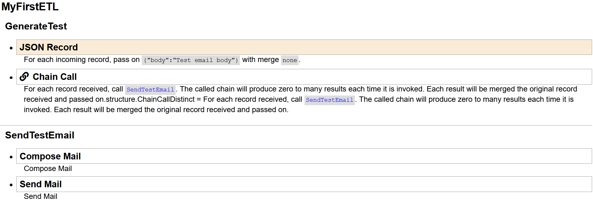

Chain Call Steps
- the
GenerateTextchain creates a text - the
SendEmailchain sends an email
There are many other related steps, serving different purposes. For more information on these steps, refer to the Dictionary provided.

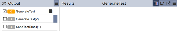

Output Panel
This panel displays the list of execution records of all chains in the chainset. Chains can be run in entirety or partially.
| No. | Description |
| 1 | Allows inverting selected and deselected output records. |
| 2 | Provides more actions that can be performed. |
| 3 | Checkbox indicating that the chain is selected. |
| 4 | The name of the chain that was executed is displayed. If chain was partially executed, the name of the chain would be appended with the range of steps that were included in the run (e..g. 1-1); the range of the included steps are referred to by the order by which they appear in the chain sequence. If the entire chain is executed, only the name of the chain is displayed. |
| 5 | Number of records resulting after the last step is executed. This corresponds to the number of records displayed in the Results panel. |
| 6 | Indicates which run is in focus. Selecting the step displays its results in the Results panel. |

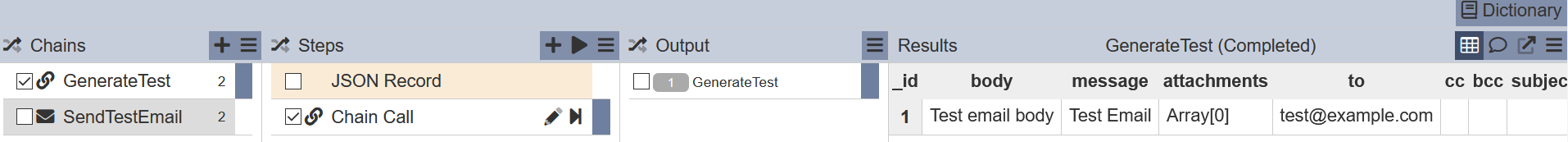

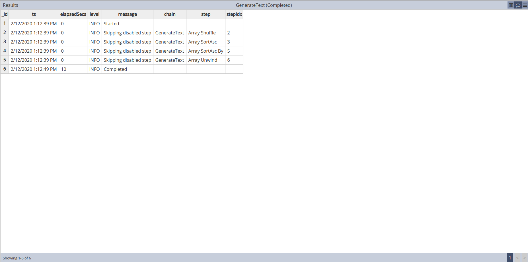

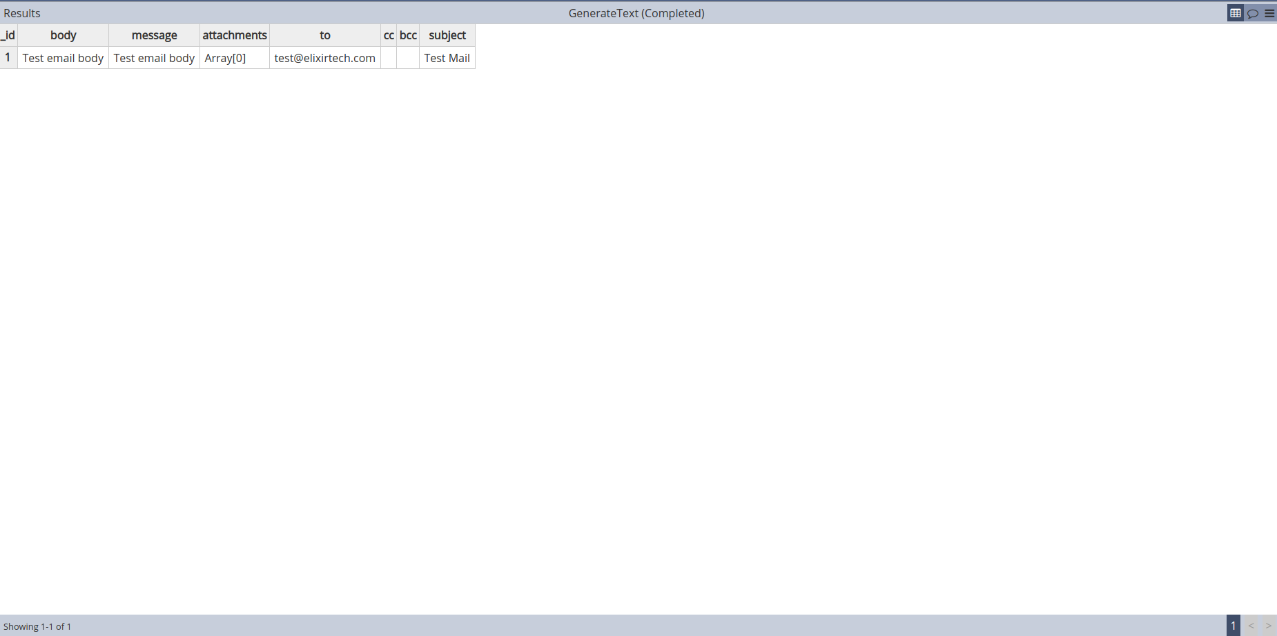

Results Panel
This panel displays the results of the selected execution record in the Output panel. The results are rendered in a table format.
| No. | Description |
| 1 | Name the row selected in the output panel. |
| 2 | Execution status of the chain or chain subset. Completed is labeled for successfully completed runs. If the last step results in a handled error, the error message is displayed as well. When the execution is still ongoing, the label is absent. |
| 3 | Navigates to the grid view, displaying the results. |
| 4 | Shows the event logs related to the execution. |
| 5 | Opens the Results panel in a separate browser tab. |
| 6 | Provides more actions, such as downloading the results in various formats. |
| 7 | Field names of the results. |
| 8 | Field values of the results. Results could have multiple rows. |

Show Data
The data grid shows the results of the record selected in the Output panel. The Results panel has this view loaded by default. Results appear if the execution has already completed successfully.
No data appears if the execution is still ongoing.
Likewise, no data is also displayed if the last step results in an error.
Pagination is applied on the results in the view. 50 rows are displayed per page. Page navigation buttons are available on the footer.

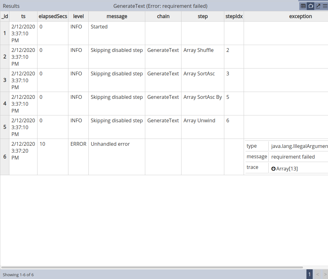

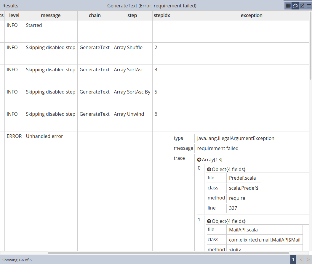

Show Log
To view the event logs created by each step that was executed for the selected record in the Output panel. Similar to the view in Show Data, the logs are also displayed in a grid. Field names are displayed on the header. Logs are also displayed in 50 records per page. A log record is also created when skipping a disabled step.
This is useful when troubleshooting steps that have resulted in errors. Most error messages could be nested. Clicking on the arrow button expands the document, displaying its nested contents.
