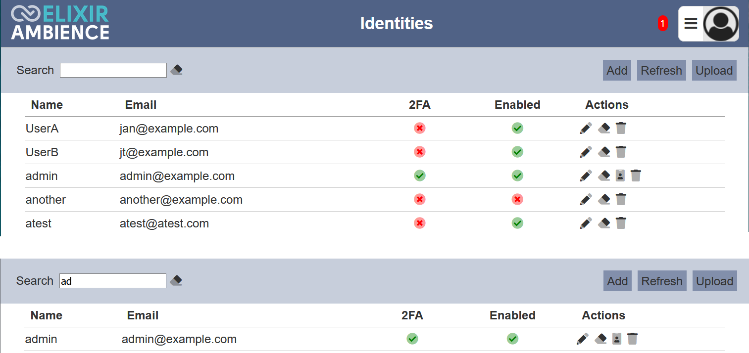

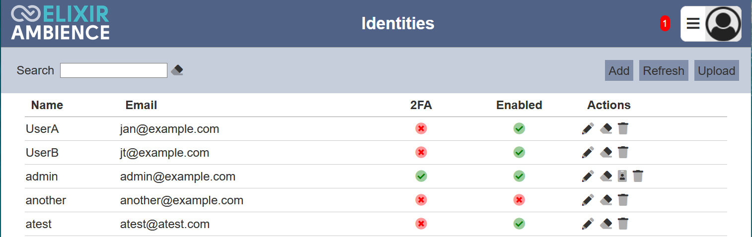

The Identities module provides a simple interface to manage user identities. Once the user identity has been created, it can be assigned roles and privileges through the Users module. The Identities module also allows you to enable or disable, edit details and reset the password of a user, as well as resetting their Two Factor Authentication (2FA).
Refresh List

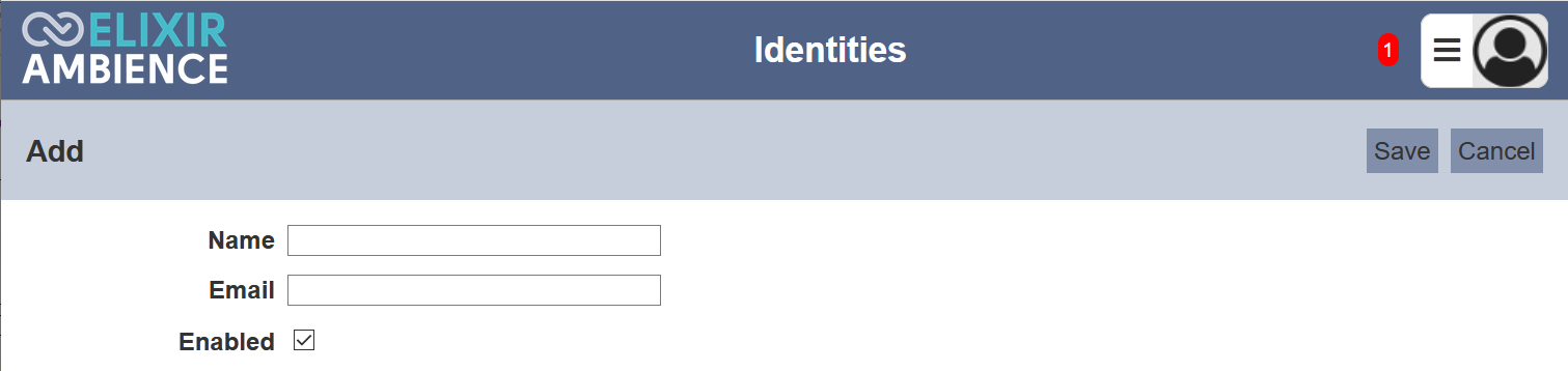

Add User
In the “Add” panel, enter the name and email of the user to be created. Ensure that the “Enabled” box is checked to enable the user. The enabled user is indicated with a green tick, while a disabled user is indicated with a red cross in the “Enabled” column in the main page.

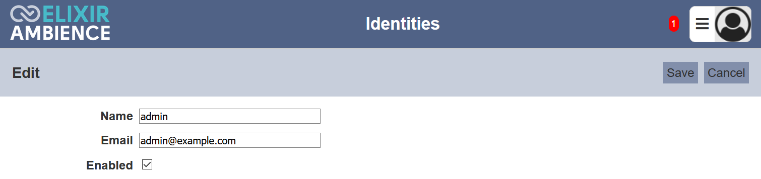

Edit User
To edit a user identity, click on the
“Edit” icon under the “Actions” column corresponding the desired user.
