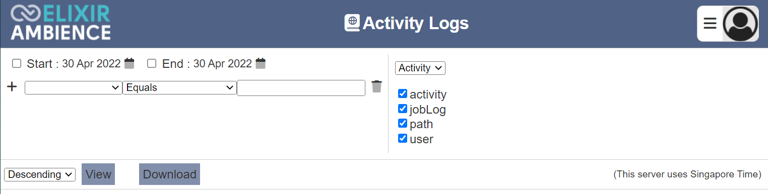

There are two panels in the Activity Logs. The left panel allows you to select the desired start and end dates, and filter for the log. The right panel allows you to select the desired column fields to be displayed and it consists of two pages; namely “Activity” and “When”.
Left Panel

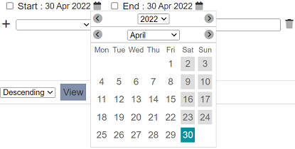

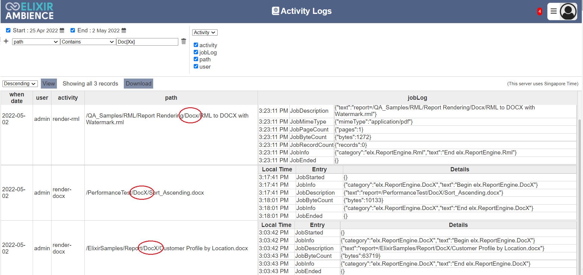

To select the start date, select the checkbox on the left of the “Start” field. By default, the current date is used. To choose another date, click in the

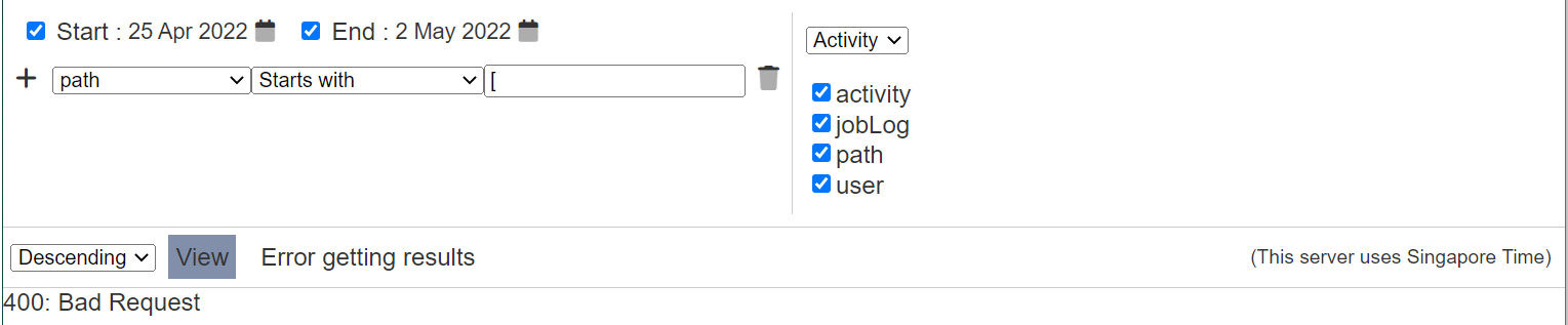

To create a criteria filter, select the desired column field from the drop-down list. Select the appropriate operator in the centre textbox. In the third textbox, key in the desired expression or value. To clear or delete a filter, click on the
 icon. To add more filters, click on the “+” icon.
Doc[Xx]
will find “DocX” and “Docx”.

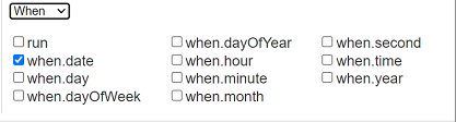

Right Panel

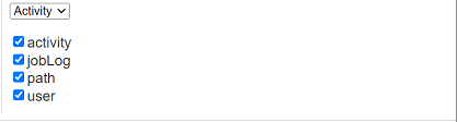

- Activity - allows you to select the activity, user, etc.
 - When - defines when the action occurs
By default, the “Activity” page is displayed with default fields. You can change the setting by selecting or unselecting the fields in the panel.
To go to the “When” page, click on “Activity” and select “When”. The fields available for “When” will appear. Select or unselect the fields according.

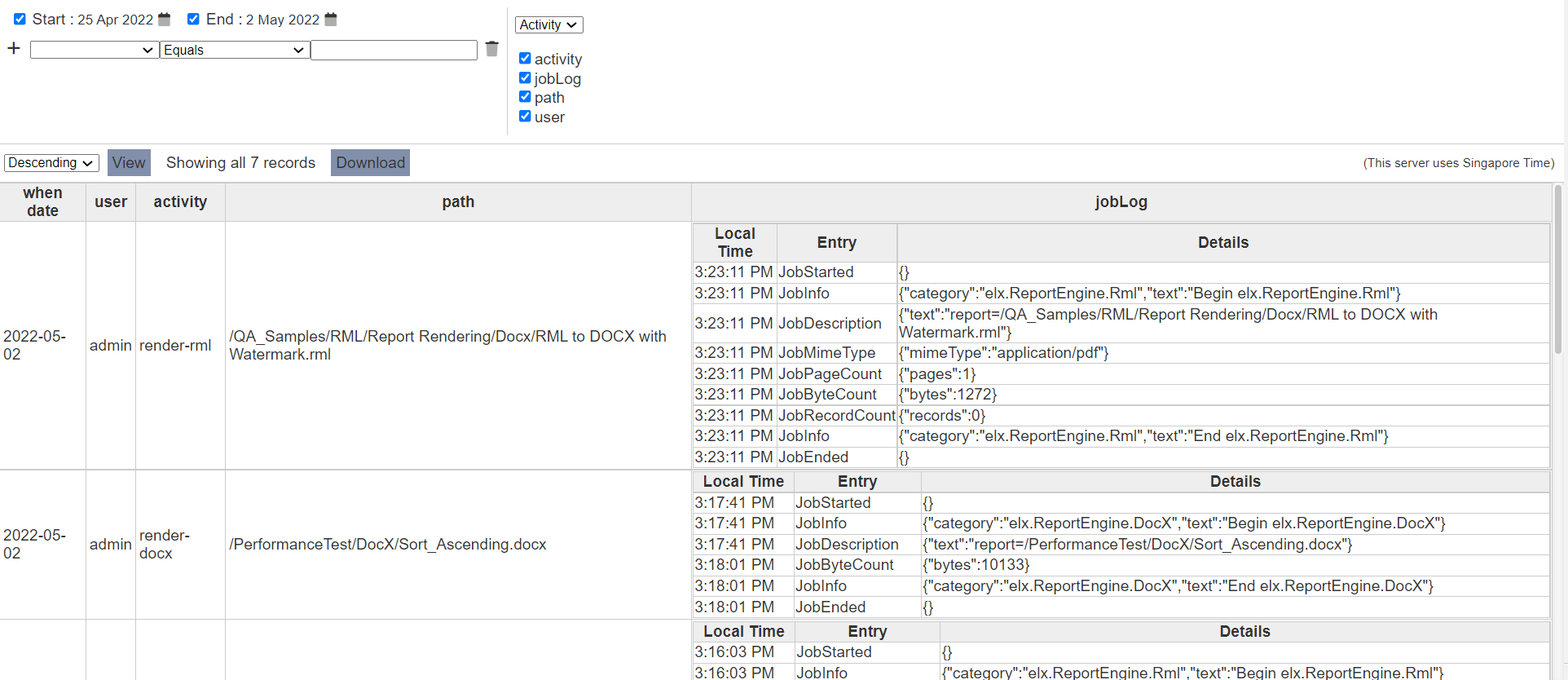

To generate the activity log, select the desired date range and set up the filters in the left panel. In the right panel, select the desired column fields in the “Activity” and “When” panels.
Click on the “View” button and the activity log will appear in the panel below.

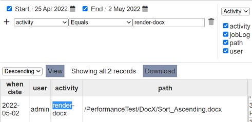

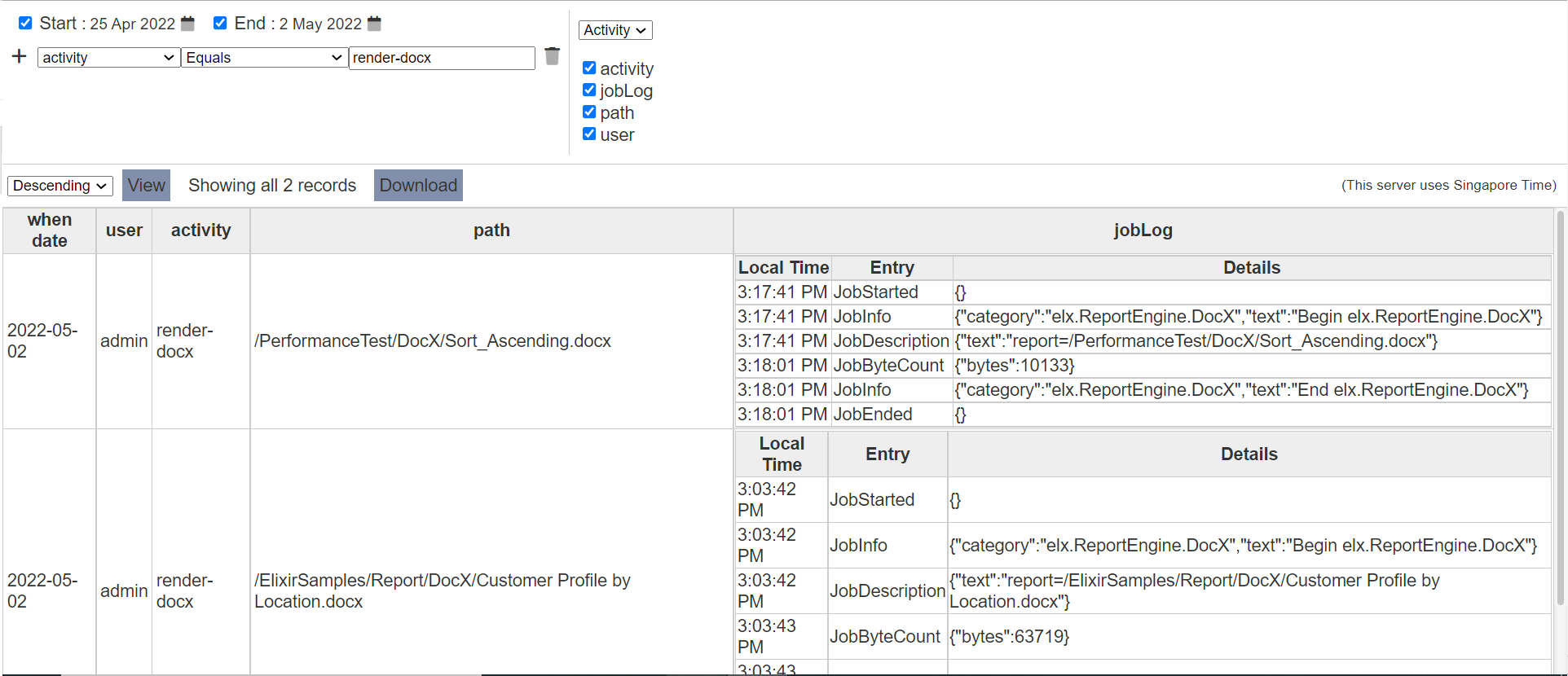

You can add filters by clicking on the desired cell field, for example, render-docx in the “activity” column. The filter will automatically fills up. By default, the “Equal” operator is selected. If it is not the desired operator, click on the “Equals” operator and select the desired operator from the drop-down list.
Click on the “View” button to re-generate the log. Now the records with “render-rml” are removed.
