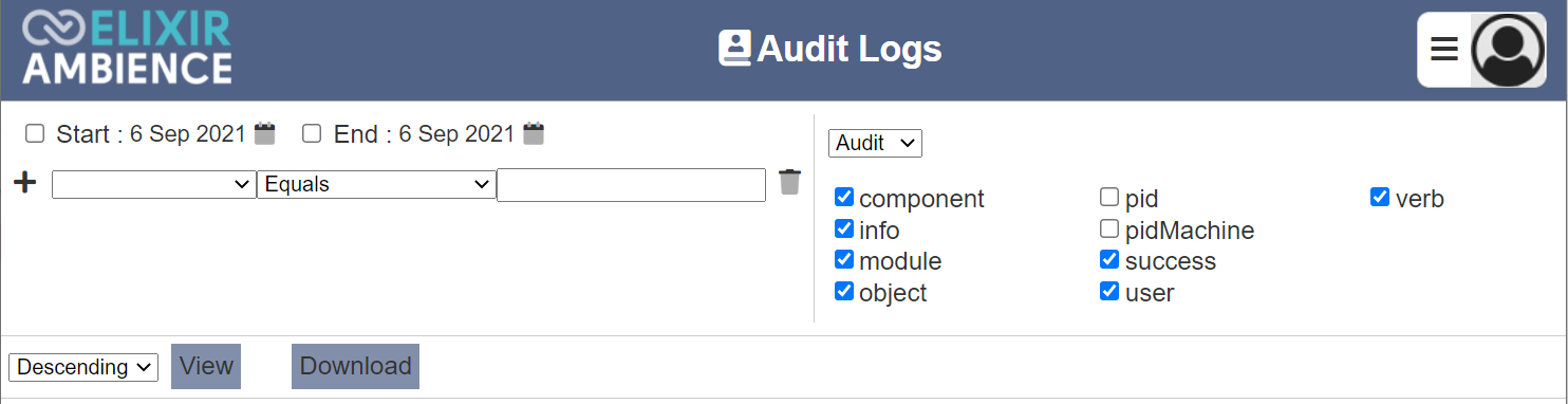

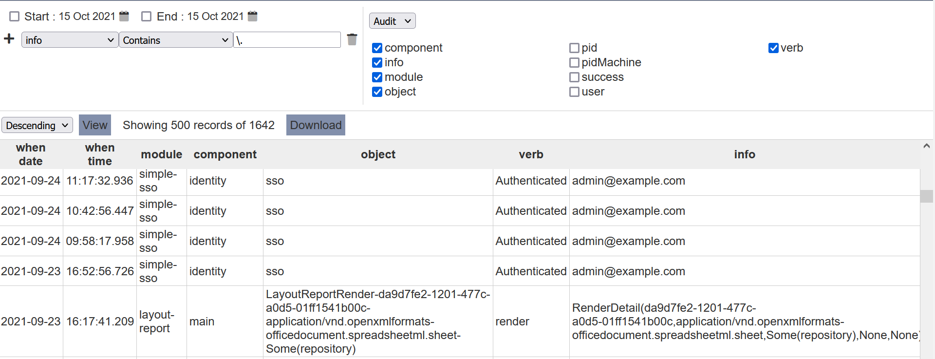

There are two panels in the Audit Logs. The left panel allows you to select the desired start and end dates, and filter for the log. The right panel allows you to select the desired column fields to be displayed and it consists of two pages; namely “Audit” and “When”.
Left Panel

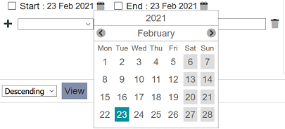

To select the start date, select the checkbox on the left of the “Start” field. By default, the current date is used. To choose another date, click in the “Calendar” icon and choose the desired date. Do the same for the end date.

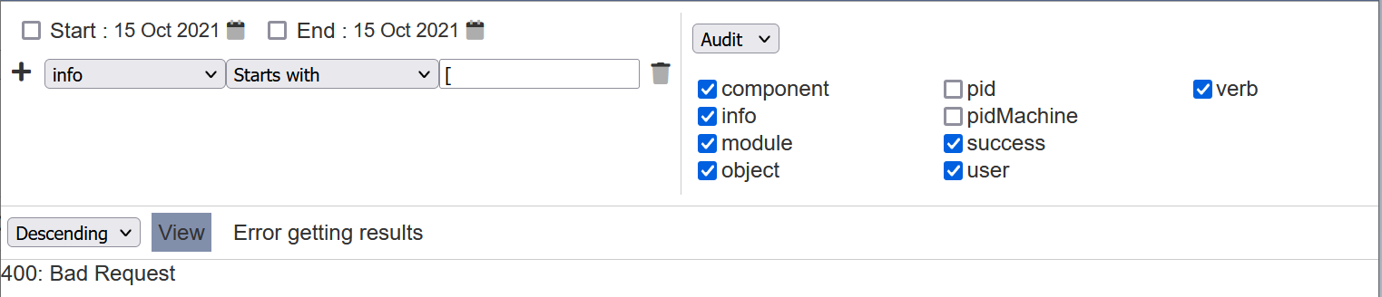

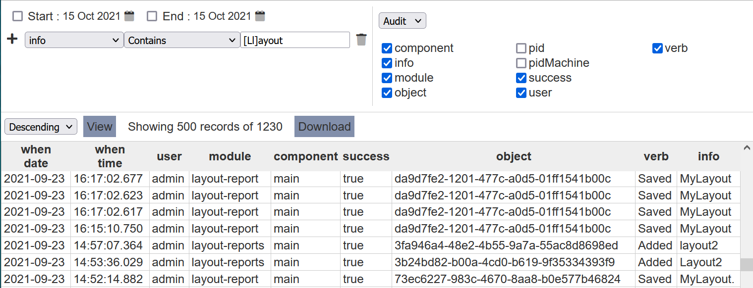

To create a criteria filter, select the desired column field from the drop-down list. Select the appropriate operator in the centre textbox. In the third textbox, key in the desired expression or value. To clear or delete a filter, click on the icon. To add more filters, click on the “+” icon.
[Ll]ayout
will find “Layout” and “layout”.
To use the reserved characters, place a \ character in front of them. In the below example, to find messages that contains with the . character, a \ is placed in front it.

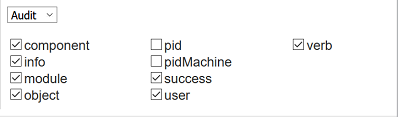

Right Panel
  • Audit - allows you to select the modules, user, etc.

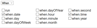

  • When - defines when the action occurs
By default, the “Audit” page is displayed with default fields. You can change the setting by selecting or unselecting the fields in the panel.
To go to the “When” page, click on “Audit” and select “When”. The fields available for “When” will appear. Select or unselect the fields according.

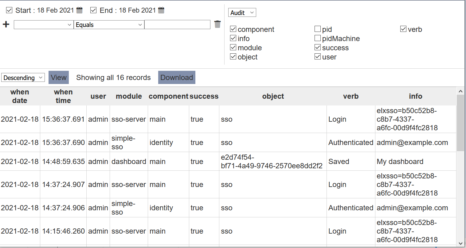

To generate the audit log, select the desired date range and set up the filters in the left panel. In the right panel, select the desired column fields in the “Audit” and “When” panels.
Click on the “View” button and the audit log will appear in the panel below.

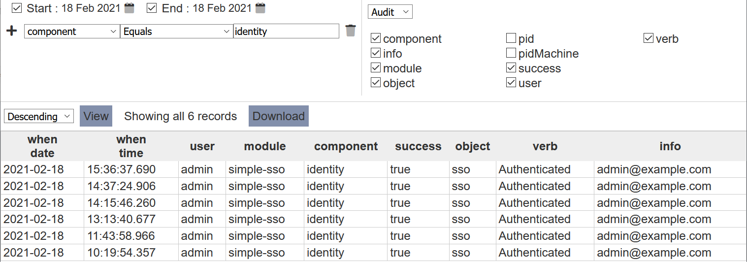

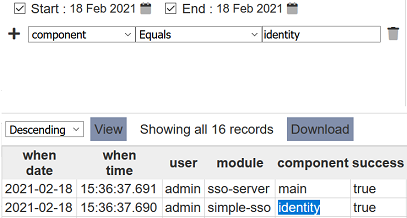

You can add filters by clicking on the desired cell field, for example, identity in the “component” column. The filter will automatically fills up. By default, the “Equal” operator is selected. If it is not the desired operator, click on the “Equals” operator and select the desired operator from the drop-down list.
Click on the “View” button to re-generate the log. Now the records with “main” are removed.

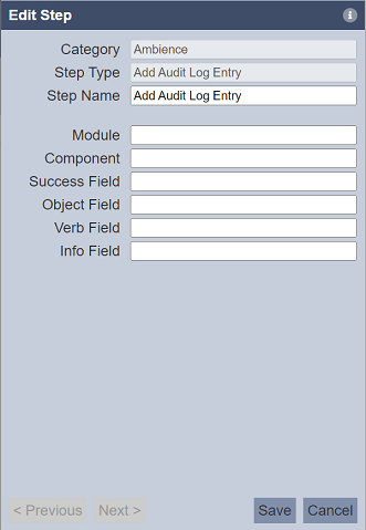

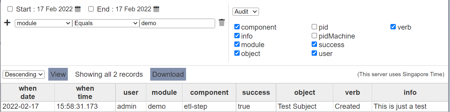

Add Audit Log Entry
The audit logs are logged from activities from various modules within Ambience. You can add additional log using an ETL step Add Audit Log Entry from the Ambience category.

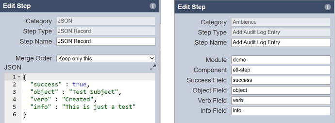

In the example below, the ETL chainset consists of two ETL steps.
  • JSON Record ETL step defines the information to log
  • Add Audit Log Entry ETL step adds the information in the JSON record into the audit log
Run the ETL chainset to log the information into the audit log. In the Audit Log viewer, search for the module demo and you can view the log added.
