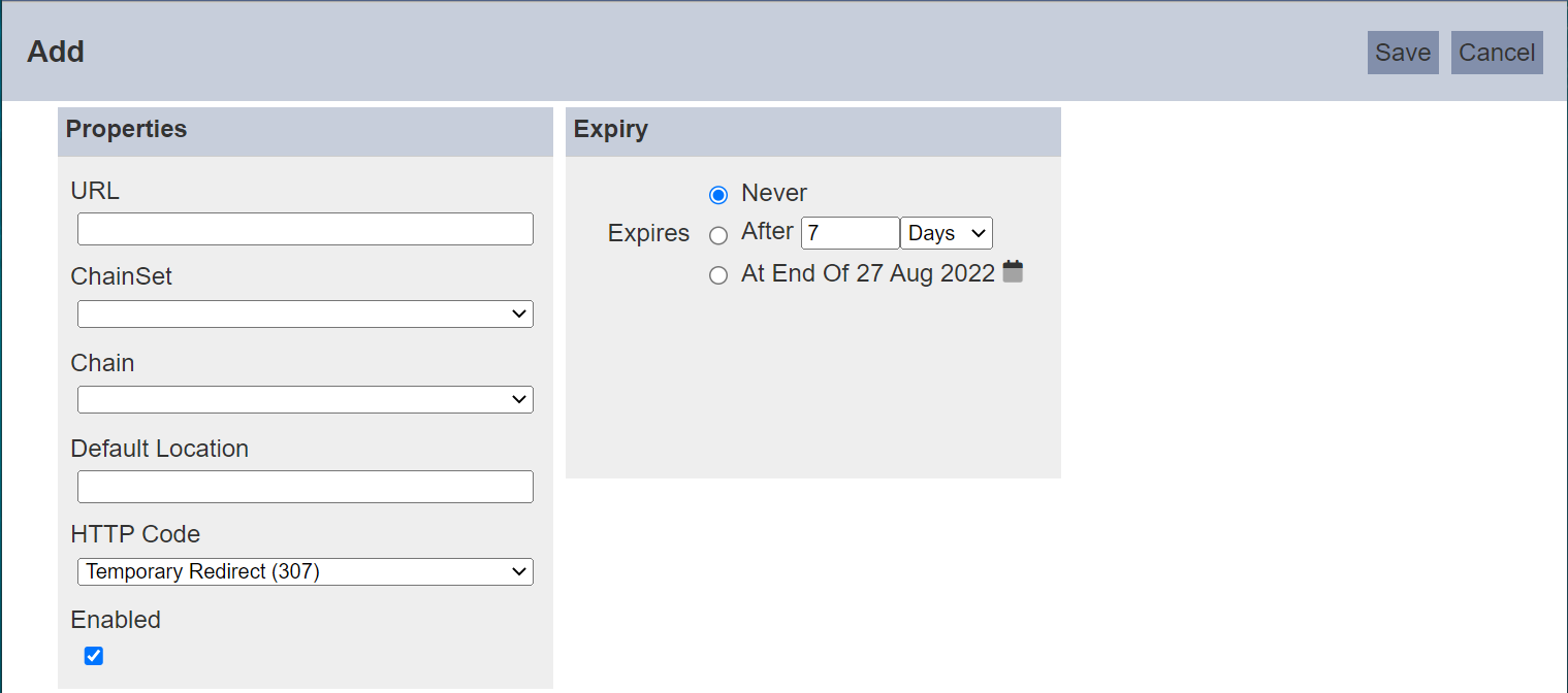

Add Redirect
To add a redirect, start by clicking on the “Add” button on the upper right corner of the page.
On the “Add” panel, set the new redirect’s parameters.
Input Fields
| Properties | |||||
| URL | Defines the unique URL to redirect to. | Y | Text field | Any text. The value must not exist in the current list of URL names, regardless of status (enabled or disabled). The value is case-sensitive. | Empty string |
| ChainSet | Selects the ETL chainset. | N | Drop-down list | One value can be selected. | None |
| Chain | Selects the ETL chain. | N | Drop-down list | One value can be selected. | None |
| Default Location | Defines the default location. | N | Text field | Any text. | Empty string |
| HTTP Code | Selects the HTTP response status code. | Y | Text field | One value can be selected. Options are: - See Other (303) - Temporary Redirect (307) - Permanent Redirect (308) |
“Temporary Redirect (307)” |
| Enabled | If selected, enables the redirect. | Y | Checkbox | True (selected) or false (unselected) | Selected |
| Expiry | |||||
| Expires | Defines when the redirect expires. | Y | Radio buttons | One value can be selected. Options are: - Never - After “current period” - At End Of “current date” |
“Never” |
The “Properties” section allows you to setup either a fixed or dynamic redirect. The value in the “URL” field is mandatory and must be unique. An error message will appear when you try to save the redirect using an URL that already exist or no URL is entered.
To created a fixed redirect, the “Default Location” must be filled. The “Chainset” and “Chain” fields are left blank.
If a dynamic location is desired, setup an ETL chainset and select that ETL chainset in the “Chainset” and “Chain” fields. Doing so allows you to create a dynamic redirect that loads for the desired redirect as setup in the ETL chainset. However, it is a good practice to fill the “Default Location” field for dynamic redirect. This can help prevent hogging the server if the dynamic redirect does not work.
The “Enabled” field is selected by default. If this field is not selected, an error message will appear when you try to use this redirect.
redirect /<redirect URL> not found
The “Expires” section allows you to define when the redirect expires or will not expire. There are three options:
| Value | Description |
| Never | As the name implies, if this option is selected, the redirect will not expire. This is the default option. |
| After | The redirect will expires after the defined days or hours. There are two sub-fields: The text field allows you to key in the desired numeric value. The drop-down list allows you to select the unit. By default, the value is “7 Days”. |

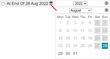

| At End Of | The redirect will expires at the end of a pre-defined date. The default date is the current date. This date can be changed by clicking on the |
Click on the “Save” button located on the upper right corner of the “Add” panel to proceed with adding the new redirect. Clicking on the “Cancel” button aborts the action.
If an expiry date/time is selected for the redirect, the expiry date/time will be displayed under the “Expires At” column corresponding the redirect in the management page. Once a redirect expires, it will be removed from the management page.
See Examples on how to create redirects.

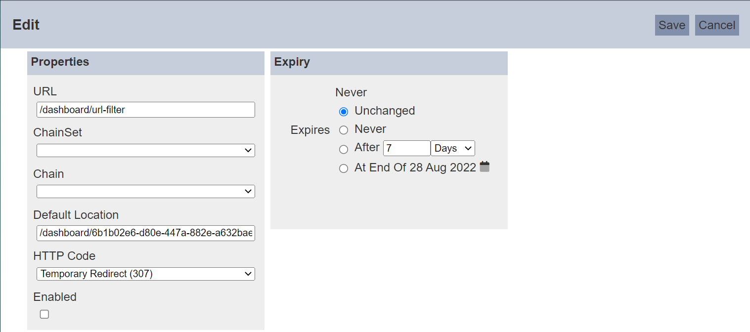

Edit Redirect
To modify an existing redirect’s parameters, click on the
“Edit” icon under the “Actions” column corresponding the desired redirect.
The “Edit” panel displays the selected redirect’s parameters.
The same fields and constraints in Add Redirect are applied. Noticed that the “Expires” section look a little different from the “Add” panel. There is a new option “Unchanged”, which is selected and a value is displayed above these options. The value indicates the current expiry status of the redirect.
To leave the remaining time unchanged, ensure the “Unchanged” option is selected. To change the expiry time, select the “After” option and set the desired value in the text field and the desired unit from the drop-down list.
Click on the “Save” button located on the upper right corner of the “Edit” panel to proceed with saving the changes made to the redirect. Clicking on the “Cancel” button aborts the action and retains the redirect’s parameters prior to opening the “Edit” panel.

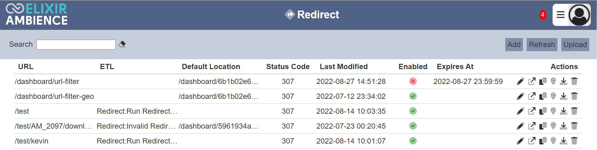

Open URL
To test the redirect that was created, click on the
“Open URL” icon under the Actions column corresponding the desired redirect. The redirect will open a new tab window, displaying the redirected URL.
Error messages will appear in the new tab window if the redirect fails or if the redirect is disabled.

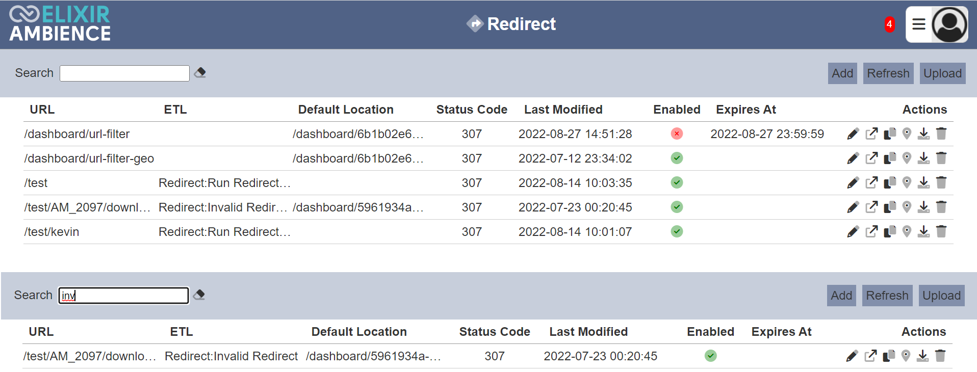

Refresh List
After performing actions (e.g. add redirect, delete redirect) on the browser window/tab, the list is reloaded to display the updated data. The manual “Refresh” button is available and is particularly useful if there are others making changes on the same page.
The “Refresh” button is available on the upper right corner of the page. Clicking on it reloads the list of redirects.
This provides an easy way to search through the redirect list. It is case-insensitive and displays records that have the entered search value in any of the values of the fields below:
- URL
- ETL
- Default Location
- Status Code
- Expires At
