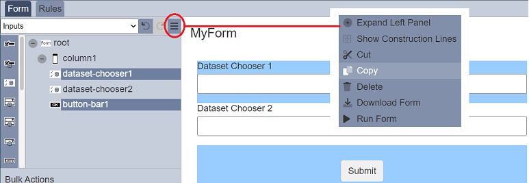

| Expand/Collapse Left Panel | Toggle to expand or collapse left panel. By default, the left panel is collapsed. |
| Show/Hide Construction Line | Toggle to show or hide the construction lines in the form area to better see the alignment of the components. By default, the construction lines are hidden. |
| Cut | Cuts the selected component and adds onto clipboard. Not available for root. |
| Copy | Copies the selected component and adds onto clipboard. Not available for root. |
| Paste | Pastes the component from the clipboard onto the form. |
| Delete | Deletes the selected component from the form. Not available for root. |
| Download Form | Downloads the form. |

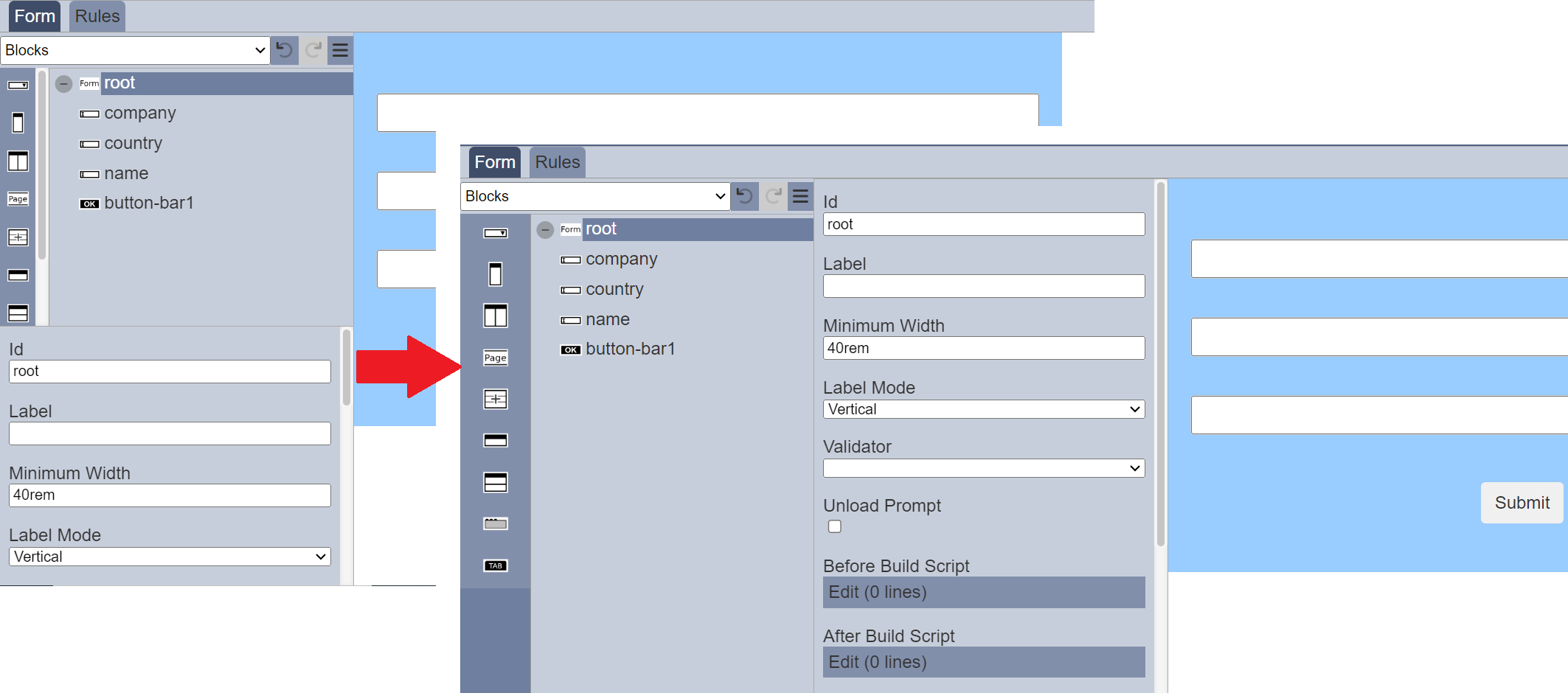

The left panel can be expanded to show component properties more prominently beside the form structure This allows you to view the component properties easily when working on the component.
You can toggle between showing or hiding the construction lines in the form by clicking on the “Show/Hide Construction Line” icon.

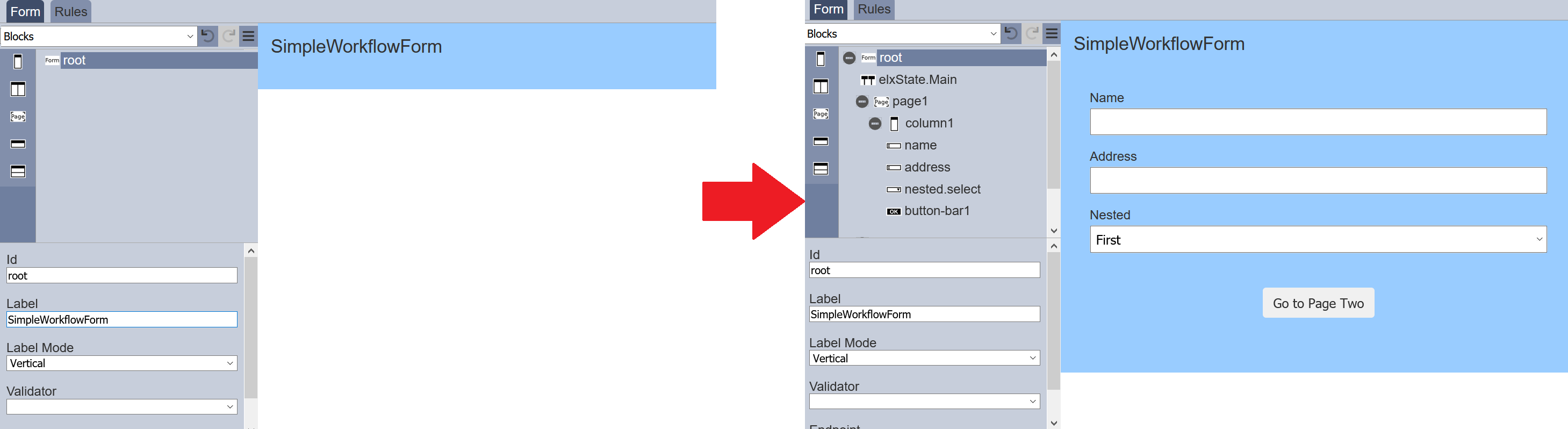

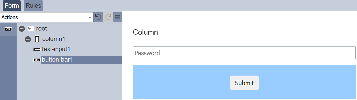

In the simple example below, a new form is created, which includes a input text field and a submit button. First, under the “Blocks” option, select “Column” and drag it to the “root”. Next, under the “Inputs” option, select “Text Input” and drag it to the column. Lastly, add a “Button Bar” under the “Actions” option to the column.

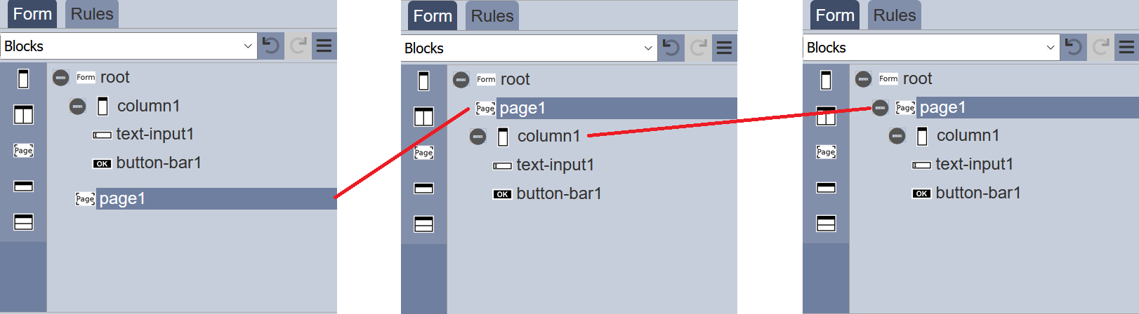

To add a page to the form, select “Blocks” from top row and select the “Page” icon on the left panel in the “Form Structure” section. Drag and drop the “Page” onto “root”. The new page will be added at the bottom of the “root” by default, if there are any components added onto the form prior adding the page. You can relocate the new page by drag and drop it to a new location in the form structure.
Note that the default name (or Id) of components added onto “root” will always start with the number “1”. For example, when the first text input is added, the default name will be “text-input1”, the next text input will have the default name of “text-input2” and so on. Unless the first such component is renamed (i.e., first text input name is renamed to “TextBox”), then the second text input component will be named “text-input1” instead. This numbering method applies to all components on the form.

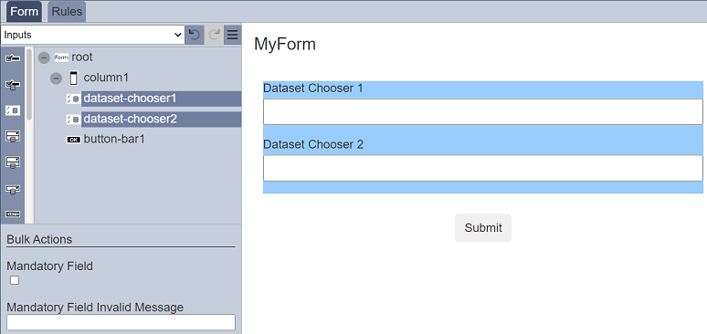

For example, two Dataset Chooser components and a Button Bar component are added onto the form with their properties are set up properly.

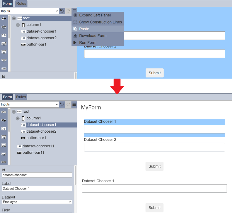

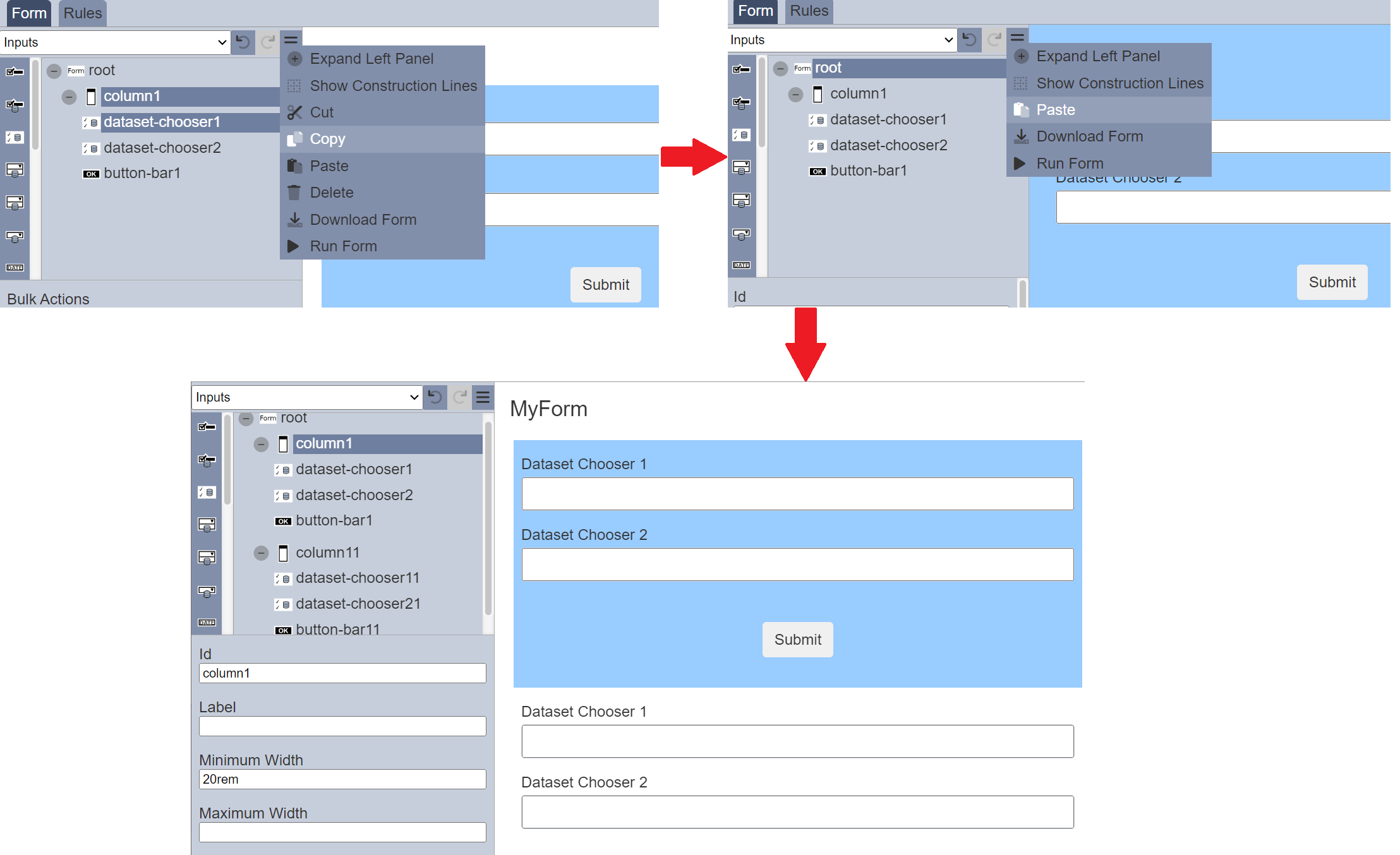

Components Dataset Chooser 1 and Button Bar need to be duplicated in the form. You can click on the Ctrl key and select the Dataset Chooser and Button Bar. Then click on the “More Actions” icon in the Top Row and select the “Copy” option.
Select the desired location in the form structure to paste the components copied. Click on the “More Actions” icon in the Top Row and select the “Paste” option. The copied components will be added onto the form in the selected location.
The new component will be labelled with a suffix 1 (e.g., dataset-chooser11) and it will inherits all the properties from the component it copies from.
If the parent component (column1) and the child component (dataset-chooser1) are selected and copied. The Paste action will add all the child components along with the parent component. For example, when copying column1 and dataset-chooser1, and pasted to root. The result will be column11 being pasted under root with all its children.
The Cut and Delete actions behave the same way, all its children will be cut/deleted along with the parent component.
Bulk Actions
When multiple components are selected, the “Bulk Actions” panel will appear below the form structure.
The “Bulk Actions” panel allows you to setup the same properties for the selected components.

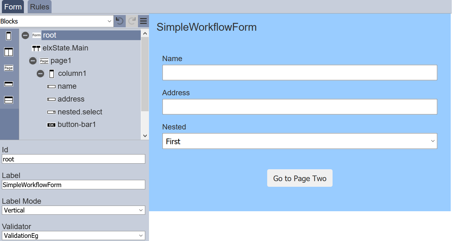

Root
Every form has a root, this is by default. The root presents the blank form itself until components are added onto it.
You can define and validate the form using its properties.
| Id | Name of the root that will be displayed in the form structure. | “root” |
| Label | Name of the form that will be displayed. | None |
| Minimum Width | Defines the width of the form. | “40rem” |
| Label Mode | Defines the orientation of the form. Available options: - Vertical - Horizontal - None |
“Vertical” |

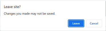

| Unload Prompt | If selected, a prompt will appear when changes are made to the runtime form and the user is trying to close the tab or navigate away from the form. ![]() |
