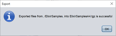

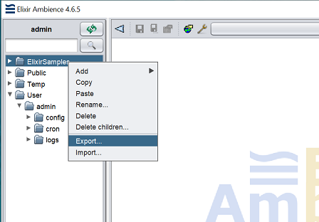

In the A4 Designer, export the filesystems to migrate. These files will be saved as .tgz files.
A message will appear after the files are exported successfully.

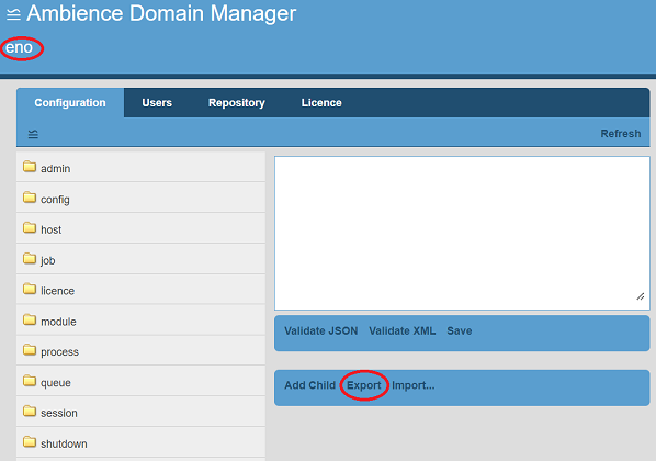

In the A4 Domain Manager, ensure the correct domain is used. In the Configuration tab, click on the “Export” button to export the Configuration XML file. This file will be saved with the filename <domain>.xml.

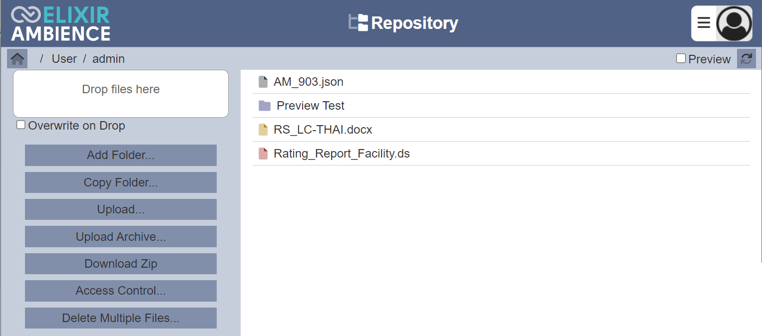

In the Ambience software suite, navigate to the Repository module. If desired, create a root folder for each filesystem.

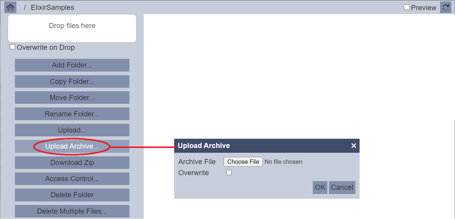

In the desired folder, click on the “Upload Archive” button on the left panel.
In the “Upload Archive” dialog box, browse to the location of the file with the extension .tgz. To overwrite existing filesystem, select the “Overwrite” checkbox. This will upload all files from the A4 filesystem to the equivalent locations in Ambience. Once the files are uploaded successfully, a message will appear.
Repeat the above process for the other filesystems.

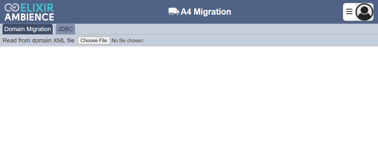

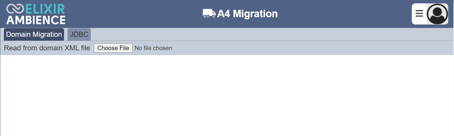

Next, navigate to the A4 Migration module.

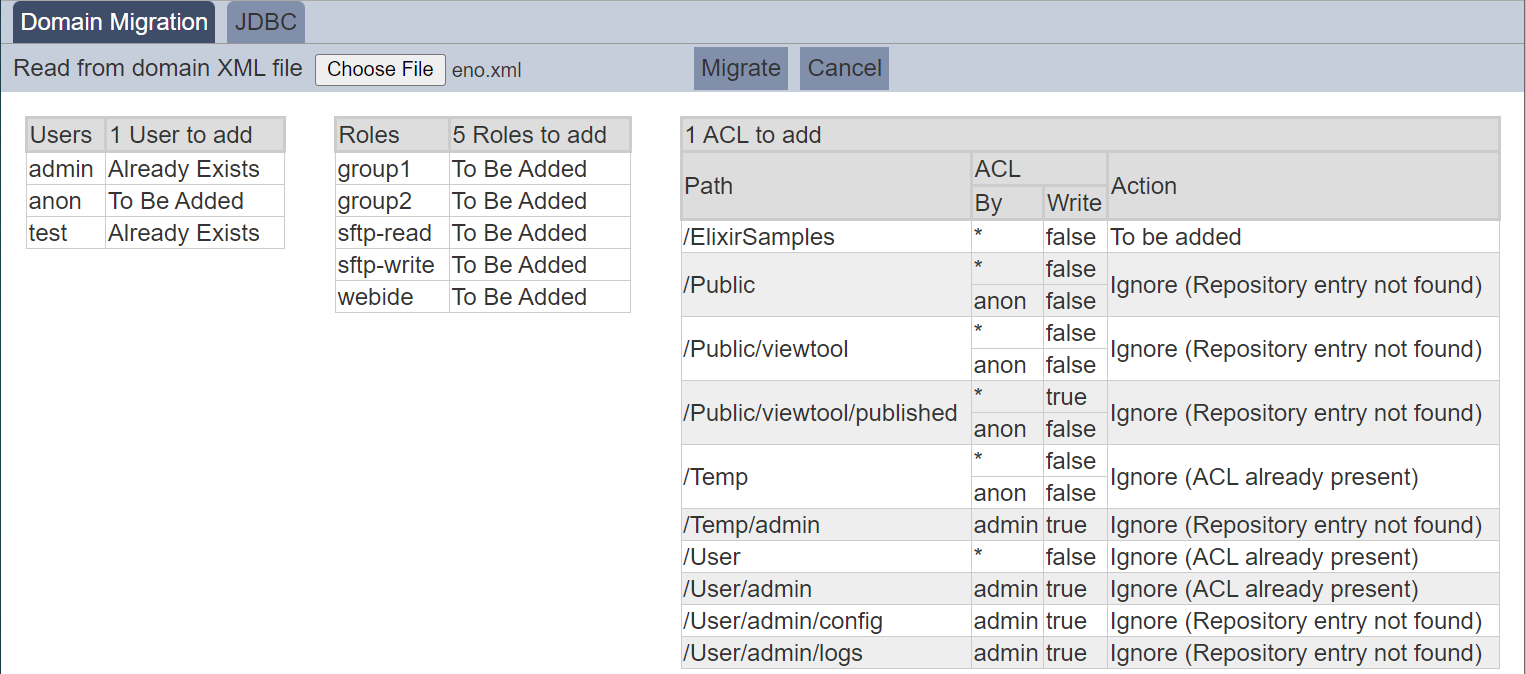

In the Domain Migration tab, click on the “Choose File” button. Browse to the location of the Configuration XML file.
Once the configuration XML has been uploaded, a list of users, roles and ACLs found in the configuration will be displayed for review.
Review the configuration and click on the “Migrate” button to apply the changes. To abort the action, click on the “Cancel” button.
The migration will perform the following:
- Add new users and roles that were not already present
- Apply any roles to the users that had them, including existing roles and users.
- Add ACL to any of the repository entries that exist and do not already have an ACL set
Upon successful migration, A message will appear.

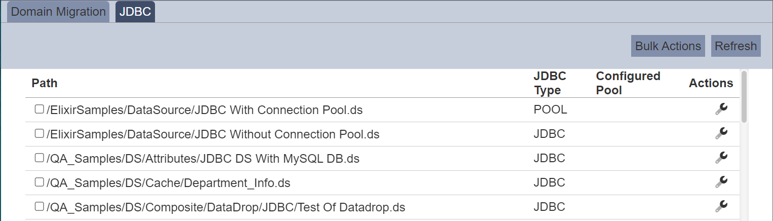

The JDBC tab lists the JDBC connection pools and their path.
There are several actions that can be performed in this tab. They are described in the sub-sections below.
Update
This function allows you to update the path of the JDBC connection pool.
To update a JDBC connection pool, click on the  “Update” icon under the “Actions” column of the corresponding JDBC connection.
The “Update JDBC” dialog box will appear.
Select the desired JDBC connection pool from the drop-down list in the “New Pool” field. Click on the “OK” button to save the change or click on the “Cancel” button to abort.
