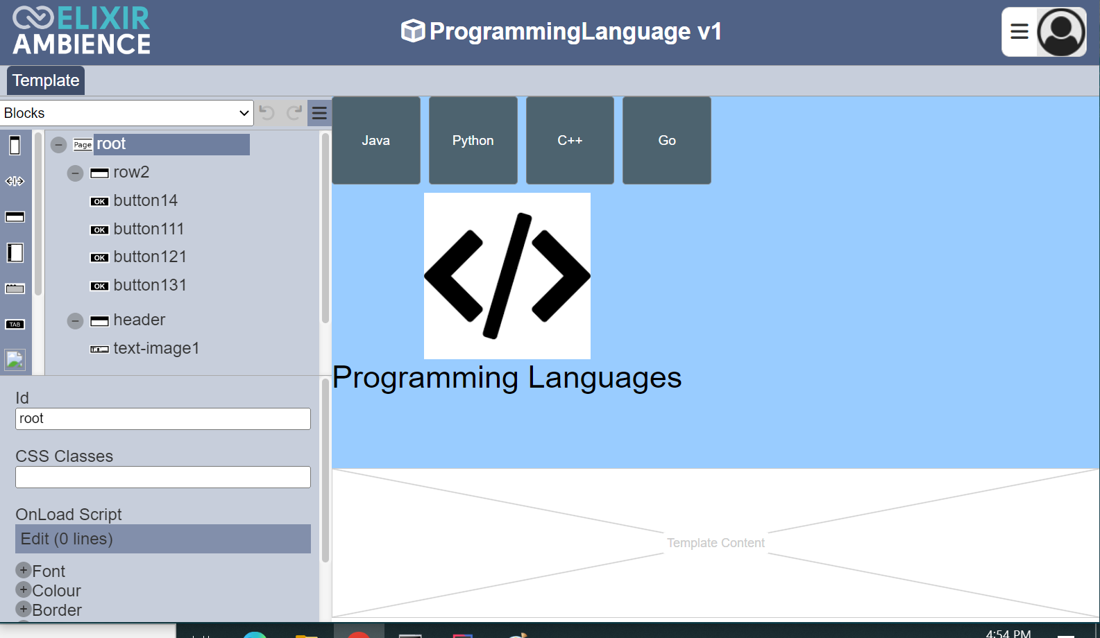

There are two designers in the CMS module; the Page Designer and the Template Designer. The Template Designer allows you to design a template for the web pages. These templates then can be used to create web pages with the same outlook. The Page Designer allows you to design a web page, with or without a template.
Both designer is quite similar. The main difference is that the Template Designer allows you to add CSS and Java Script (JS) to the root component and has a Template Content component.
The Designer consists of two panels. The left panel displays the hierarchy, the components and their properties. The right panel displays the template/page, allowing you to visualise the template/page as you design it.
The left panel displays the available actions for the selected component in the template/page. It has three parts; the top row, tree structure in the middle and component properties at the bottom.

Tree Structure
The template/page structure allows you to design the structure of the template/page, as well as add images, drop-down menu, buttons, etc. onto the template/page.
Every template/page begins with a root, which other components can be added onto it.

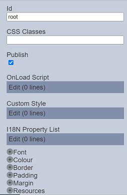

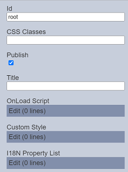

Root
Every template/page has a root, this is by default. The root presents the blank template/page itself until components are added onto it.
You can define the root using its properties. The properties for root is different for template and page. Below are the screenshots for template and page respectively.
| Id | Name of the root that will be displayed in the tree structure. | “root” |
| CSS Classes | Defines the CSS class to be used. | Empty |
| Publish | If selected, allows the root to be visible in the snapshot. If unselected, the root component will be excluded in the snapshot and a “404” error will appear in the snapshot preview. |
Selected |
| Title | Name that will be displayed on the windows tab when the page is ran. If not defined, the name of page is used. For page only. |
| On Load Script | Defines the script to run when loading template/page. | None |
| Custom Style | Customise the style of the template/page. | None |
| I18N Property List | Defines the I18N property list for the template/page. | None |
| Common properties | Some common properties such as CSS Classes, Publish, Font, Colour, Border, etc. See Common Properties for more details. |
Vary |
