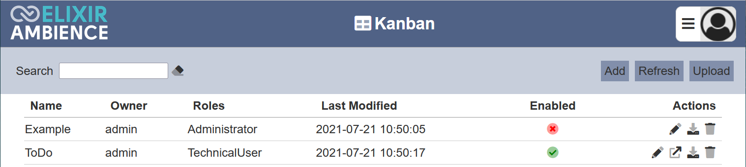

| Kanban | Allows access to Kanban page. | mod-kanban |
| Kanban | Allow to edit Kanban metadata (e.g. role access). | mod-kanban-edit |
| Kanban Board | Allows access to Kanban board page. | mod-kanban-board |

After performing actions on the browser/tab, the list is reloaded to display the list of Kanban boards. The manual “Refresh” button is available and is particularly useful if there are others making changes on the same page.

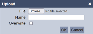

This function allows you to upload an existing Kanban board onto the management page.
To upload a Kanban board, click on the “Upload” button at the upper right corner of the page.
Browse to the location of the Kanban board to be uploaded. The “Name” field uses the filename of the file selected by default. You can change the name as desired, then click on the “OK” button to upload the board. If the board already exist, an error message will appear.
If the board to be uploaded is to overwrite an existing board, select the “Overwrite” field before clicking on the “OK” button.
Once the board is uploaded successfully, a notification will appear.

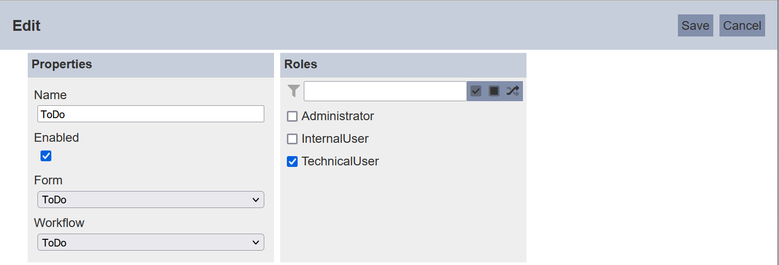

This function allows you to edit the properties of the Kanban board, such as name of the board, the roles that can access the board and to enable or disable the board.
To edit a board, click on the  “Edit” icon under the “Actions” column corresponding the desired Kanban board.
In the “Properties” section, you can change the name of the board. The name must be unique or an error message will appear. You can also enable or disable the board be selecting or de-selecting the “Enabled” field. Once the board has been disabled, you will not be able to open the board until you enable it again.
In the “Roles” section, select the desired roles by selecting the checkboxes in the section to allow them to access the Kanban board. Alternatively, you can search for the role by using the search function at the top of the section. There are options to select all, select none and invert selection by clicking on the respective icons next to the search function.

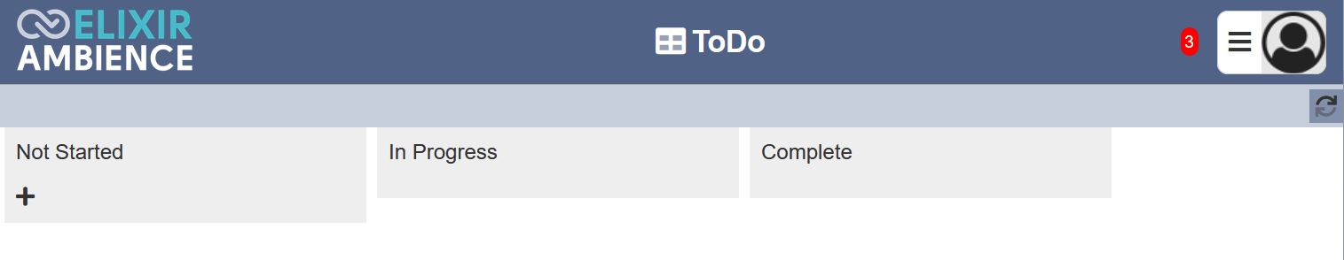

The Kanban Board allows you to add and edit Kanban items.
To open the Kanban Board, click on the  “Open” icon under the “Actions” column corresponding the desired board.
The “Kanban Board” page will appear.
Refer to Kanban Board for more details.

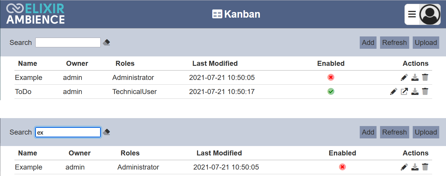

There is a cross-field search function for the list of Kanban boards. It is located at the upper left corner of the page.
This provides an easy way to search through the Kanban boards. It is case-insensitive and displays files that have the entered search value in any of the values of the fields below:
