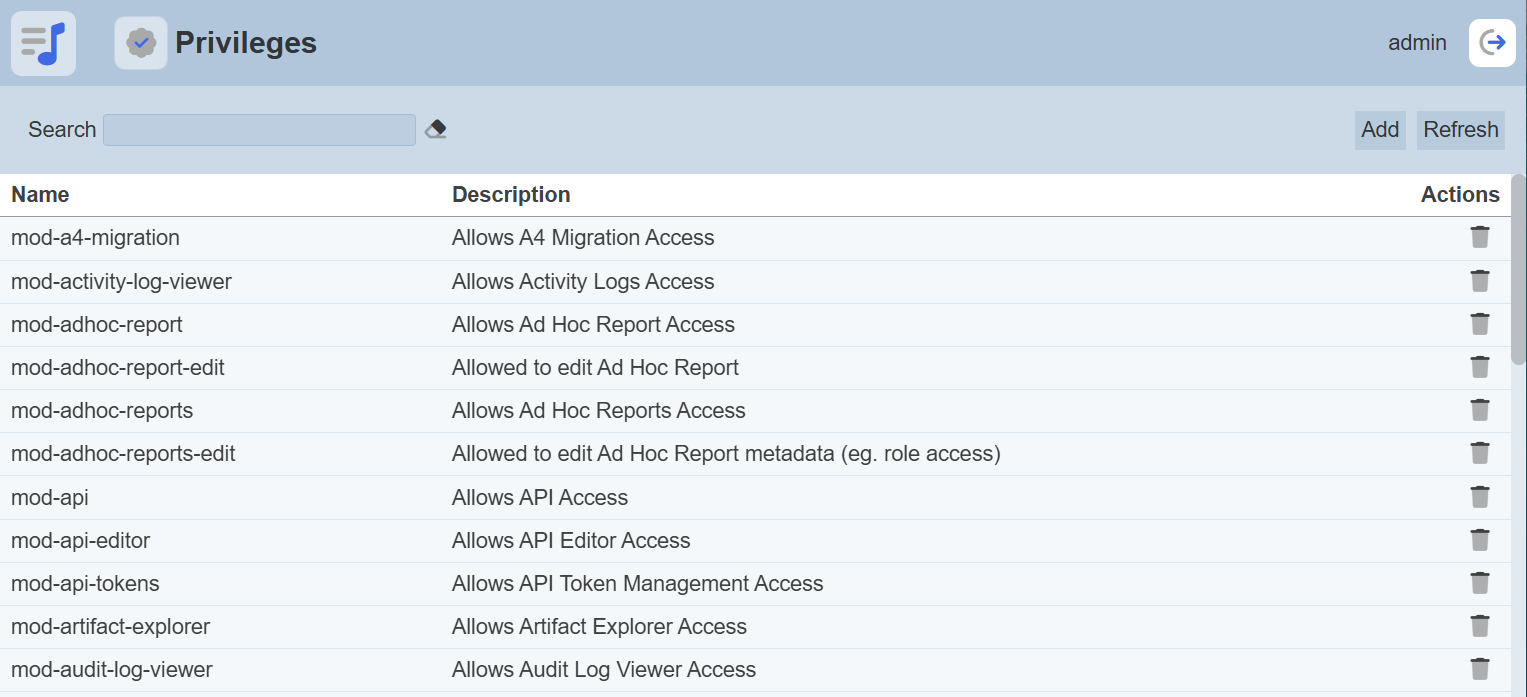

Access to the Ambience modules are based on the privileges given. Each module can have one or more privileges, allowing access to different areas in the module. These access right can be given to different users based on their roles.
The Privileges module provides a simple interface to manage privileges.
Privileges are primarily for controlling access to modules. By default, privileges used by all standard Ambience modules are listed.

Features
- Add privilege
- Edit privilege
- Delete privilege
- Refresh list
- Search
| Privileges | Allows adding, modifying and deleting privileges. | mod-privileges |

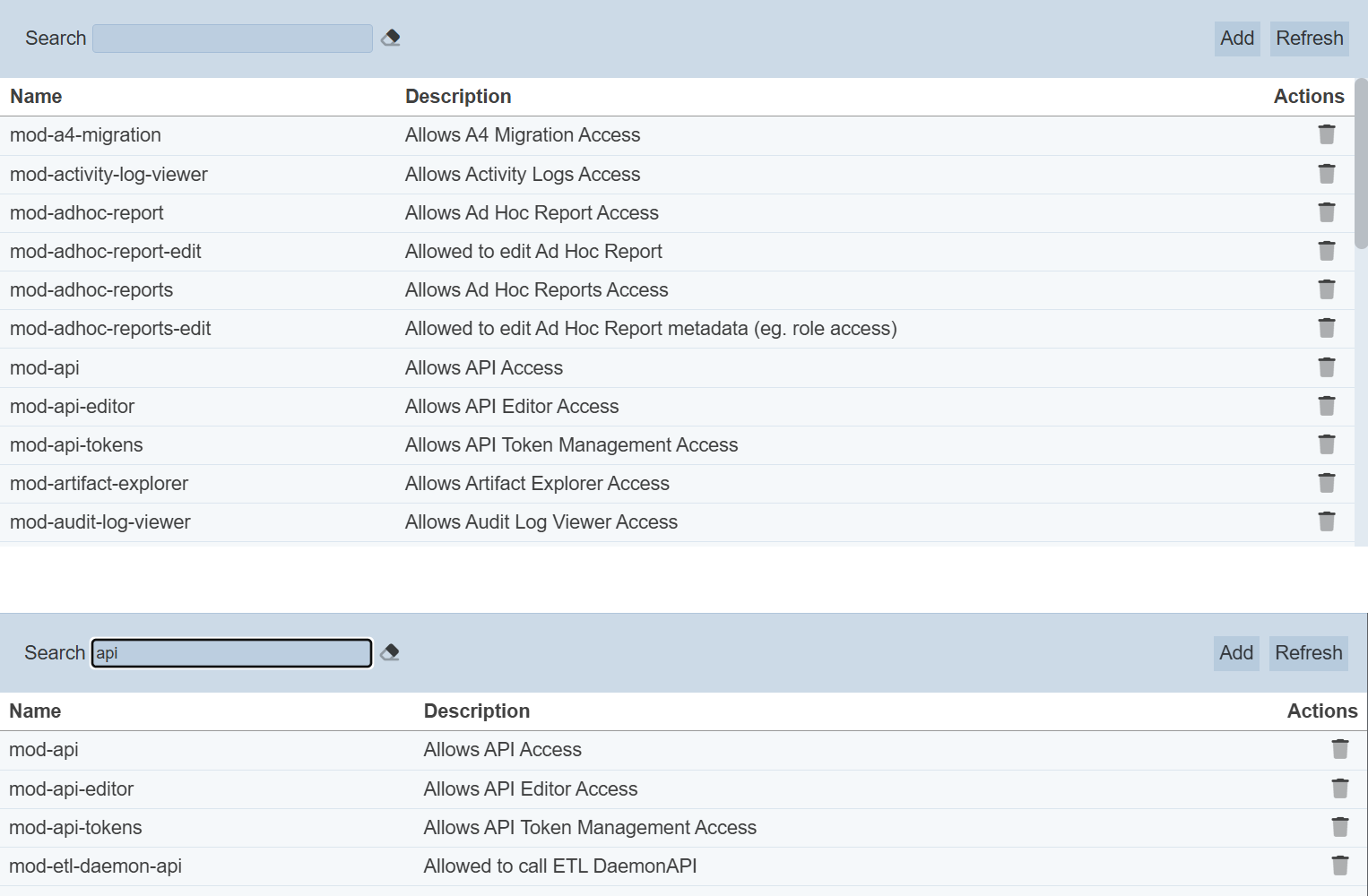

Refresh List
After performing actions (e.g. add privilege, delete privilege) on the browser window/tab, the list is reloaded to display the updated data. The manual “Refresh” button is available and is particularly useful if there are others making changes on the same page.
The “Refresh” button is available on the upper right corner of the page. Clicking on it reloads the list of privileges.
This provides an easy way to search through the privilege list. It is case-insensitive and displays records that have the entered search value in any of the values of the fields below:
