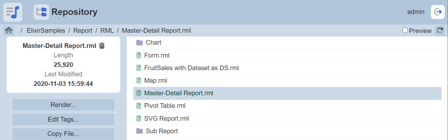

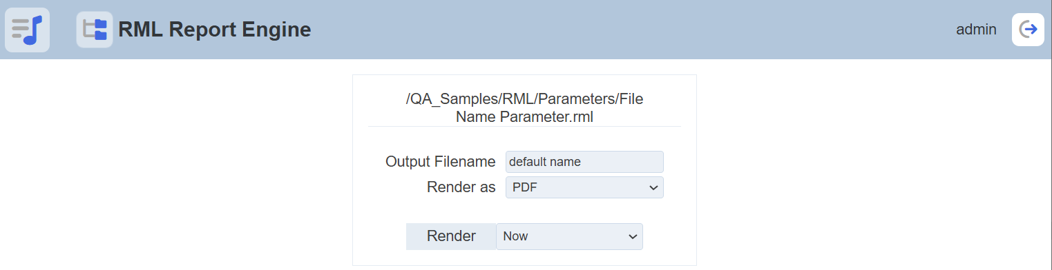

To generate the RML report through the Repository module, select the RML document and click the “Render” button.

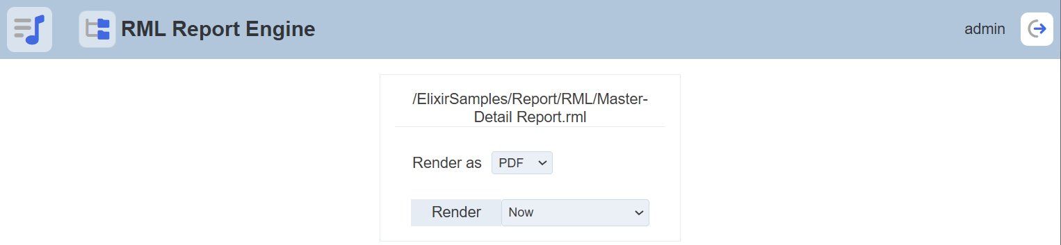

The RML Report Engine page will appear.

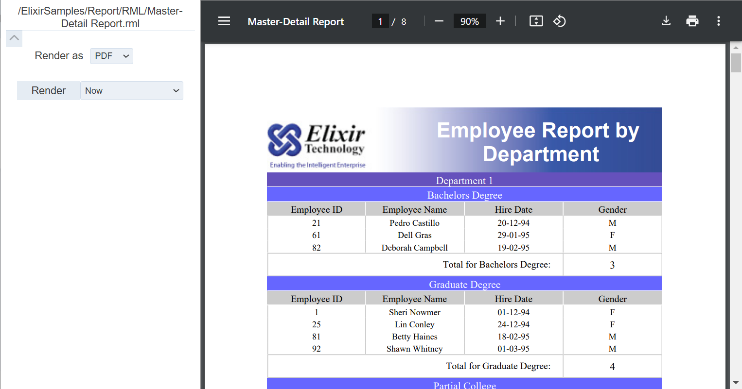

Select the desired format (PDF or XLSX) from the drop-down list and click on the “Render” button. The report is generated using the DS file as content and the RML file as template. If the browser permits, the report is displayed in another tab.
There is an additional option to display the generated report in the RML Report Engine page. To use this, you will need to add the following line into the application.conf file. For example, to show PDF files on the same page:
ambience.rml-engine.ui-left-parameters = ["application/pdf"]
If the browser permits, you can also display HTML or XLSX format in the RML Report Engine page. You simply add the corresponding mime-types into the list (comma separated) in the application.conf file.
You will need to restart the server for the display to take effect. With this option enabled, where possible, the generated report will be displayed in the RML Report Engine page instead of another browser tab.
You can opt to close the left panel to maximise the report in the page by clicking on the “Hide Parameters” icon on the left of the left panel.
To expand the left panel, click on the “Show Parameters” icon next to the path of the report at the top.
Do note that the output report uses the name of the report as its filename. Some reports may have the elx-filename parameter to allow user to dynamically define the name of the output report. Below is an example during rendering.

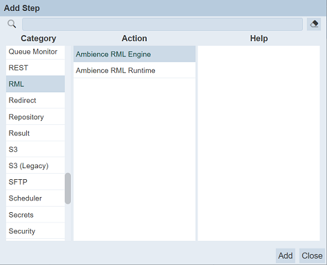

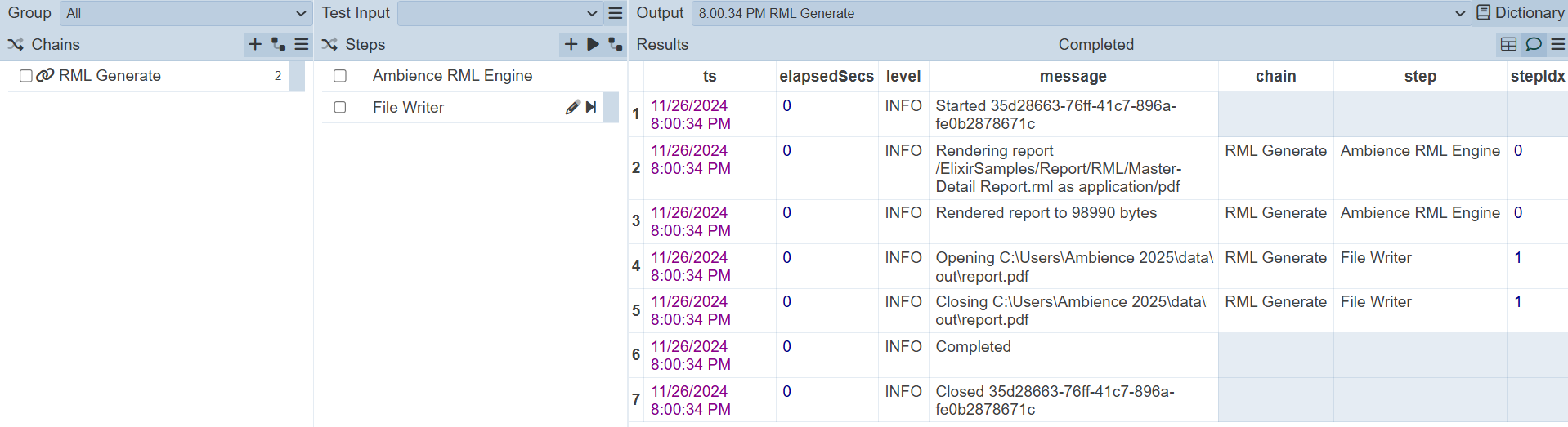

Another way to generate RML report is to use the ETL chainset. There are several ETL steps that can be used to generate the RML report.
In the simple example below, the ETL chainset generates the RML report and writes to a PDF.
  • Generates RML report in the desired output format
  • Writes the output file to the desired location and filename
Click on the “Run Steps” icon to generate the RML report.

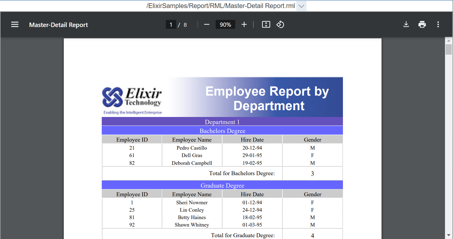

curl -v -X POST http://localhost:1740/rml-engine/api/v1/render?elx.token=<token>
-H "Content-Type: application/json"
-d '{"rml": "/ElixirSamples/Report/RML/Master-Detail Report.rml"}' -o result.pdf
The result PDF will be displayed with the content of Master-Detail Report.rml.

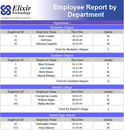

An RML template may need to use dates in its report. These dates typically need a default value. Depending on the nature of the report, you may want the default values to be as close to the current date as possible. So if an RML file was created several years ago, hard-coded default dates may be dated too far back. It may be useful to set the default date to the first day of the current month and year - the Theme module can help to set the initial date.

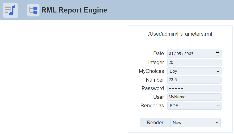

In the example below, a RML file that was created several years ago has a default date that is old.

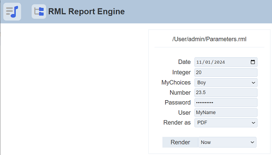

The above script allows you to use the first day of the current month and year as the initial date.

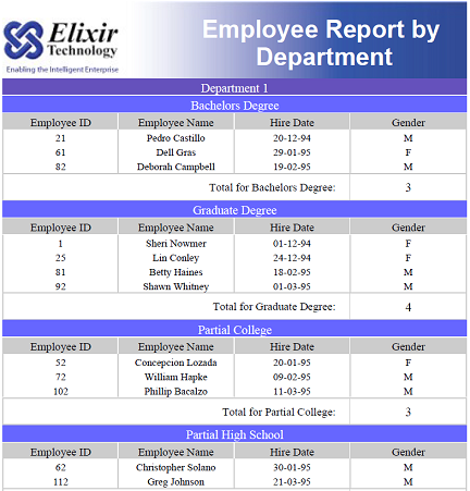

Activate the theme if it is not activated yet. Refresh the Repository and render the report.
The initial date is now the first day of the current month and year. This makes it easier for the user to select dates that are more current.
