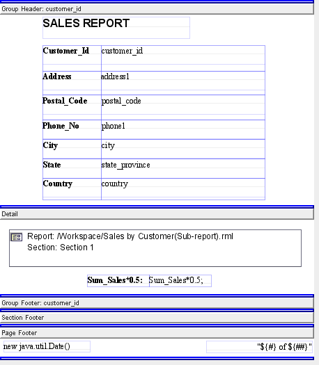

Select and place a Label element in the GroupHeader: customer_id and enter Sales Report in the text field of the Properties Wizard. Below it place a Vertical box element and append 5 cells to it. Place a horizontal box in each cell. Place label element in each cell of the Horizontal box element and enter Customer_id, Address, Postal_Code, Phone_No, City, State and Country in the text fields of the Properties wizard of corresponding Label element. Similarly, place Data field element in the second cell of each Horizontal box and select customer_id, address1, postal_code, phone1, city, state_province and country fields.
Select and place a Sub-Report element in the Detail section. The SubReport Properties Wizard appears. In this select the report Sales by Customer(Sub-report).rml from the Choose a Report dialog by clicking the button on the right of the text box. Select section1 from the section combo box and select Customer_Filter Subreport from the DataSource combo box.
Select and place a Horizontal box element below the SubReport element. In the first cell add a label Sum_Sales*.0.5. Place a Data Field element in the second cell of the box. In the Wizard select the Script Field type and enter Sum_Sales*0.5; and click on the Finish button.
Finally, invoke the Group Header Properties Wizard and enter Sum_Sales=0; in the OnRenderBegin text field of the Scripts tab. The layout appears as shown in Figure 4.10, “SubReport Example Layout”.
