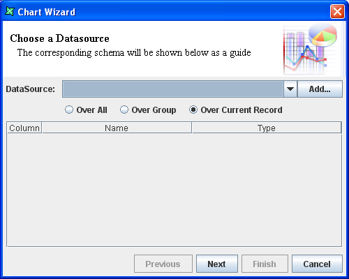

Select and place a Chart element in the report layout. The Wizard appears as shown in Figure 4.16, “Chart Wizard”. Select the DataSource from the combo box. Alternatively, by clicking the Add button on the right of the combo box select the DataSource from the Configure DataSource Wizard.
OverAll: On selecting this option, the whole set of records are taken into consideration irrespective of the grouping.
OverGroup: If this option is selected then the plotting is done based on the grouping of data is considered.
OverCurrentRecord: If this option is selected for the chart in the Group header, then the first record of the group is considered. If this option is selected for the section footer, then the last record of the data source is considered as the current record or if this option is selected for the section header then the first record of the data source is considered.
Enter the Display Name if required.
Click on the Next button to navigate to the next screen.

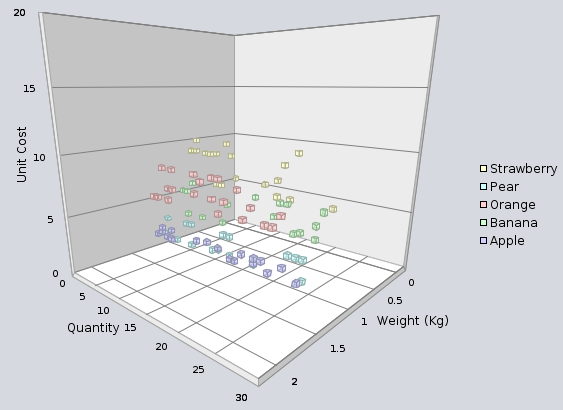

A 3D chart displays data using three axes, X, Y and Z. The orientation of these axes follows the right-hand rule: make a fist with your right hand, and extend your thumb to point to the right. Extend your index finger so it points upwards, making a 90 degree angle with the thumb. Finally, extend your middle finger so it is at 90 degrees to both your thumb and index finger. You now have the directions of the X (thumb), Y (index finger) and Z (middle finger) axes. These are shown in Figure 4.17, “XYZ Axes”.
Five kinds of 3D charts are supported, Area, Column, Line, Scatter and Surface. In each case, the X axis may reference any kind of field, such as strings, numbers etc. The Y axes can only hold numeric values, so the wizard will only let you select from the numeric fields of your datasource. The Z axis can reference any kind of field, but discrete values, i.e. strings make most sense. The Z axis can't key the values effectively over a continuous range, such as a floating point number.

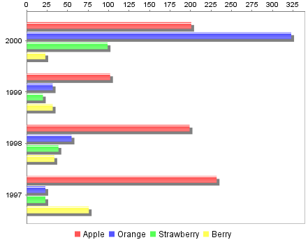

A bar chart displays series as set of horizontal bars that are grouped by category. The categories are arranged horizontally and the values vertically . Bar charts are used to compare value over categories and are ideal for showing the variations in the value of an item over time, or for showing the values of several items at a single point in time.

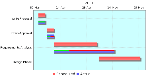

The Bar chart types include Bar, Bar 3D, Cylinder, Bar Stacked Chart, Bar Stacked Percentage and Gantt Chart. For example, the 3D Bars are used to display data in 3D format which is convenient for visually comparing the Bars. This is used for making comparisons between groups of data particularly when you want to compare one period of time to another (You can use Bar graph to compare sales per quarter). The Gantt Charts are used to display how much percent of the tasks has been completed during the Start and End dates, which helps you monitor the progress of a schedule project at a glimpse. Figure 4.19, “Gantt Chart” displays a common example of Gantt Chart, which uses Percent on the Actual values to show the current progress:

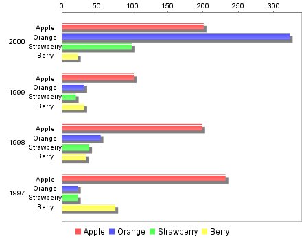

Sub-category is supported for both Bar and Column charts. Figure 4.20, “Bar Chart without Sub-Category” and Figure 4.21, “Bar Chart with Sub-Category” explains for themselves.

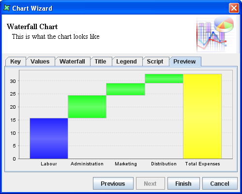

Waterfall charts are a special type of Floating Column Charts. A typical waterfall chart shows how an initial value is increased and decreased by a series of intermediate values, leading to a final value.
Waterfall charts have very specific data requirements. Here is a sample datasource we will use for illustration:
Product Stage Value ---------------------------------- Product 1 Labour 15.76 Product 1 Administration 8.66 Product 1 Marketing 4.71 Product 1 Distribution 3.51 Product 1 Total Expense 32.64 ----------------------------------
Every Waterfall datasource requires three fields to be specified, one Key and two Values. The Key in this case is Product. The first value should be the field that describes the composition of the bars, in this case Stage. The second value should be the field that holds the numeric data. In this case Value. If you create a dataset with more or less than two values, it won't render correctly. The output produced for the sample dataset given above is shown in Figure 4.22, “Sample Waterfall Chart”.

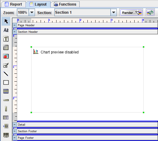

Previewing of Chart element on the workspace can be disabled by
unchecking the checkbox in the Properties panel, as
shown in Figure 4.23, “Properties Panel”. With the
Preview function enabled, any changes made including the
size, colour and position invokes a re-render of preview. Thus, increasing
the chances of performance issues.
When the Preview function is disabled, the Chart element on the workspace will show that previewing of the Chart is disabled, like in Figure 4.24, “Chart Preview Disabled”.

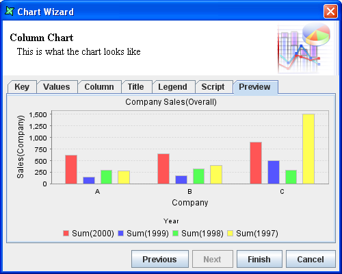

Here's how to add a Column Chart based on the Company sales for four consecutive years.
Add a Blank report with ChartData.ds as the default data source which points to the Fruit.csv file.
Invoke the Section Wizard on Section 1 and sort based on CompanyName in Ascending order and group on Each Value. Make sure the group header is enabled.
Select the Layout tab and place the Chart element in the Section header. In the Wizard that appears select Default from the DataSource combo box. Select the Over All option and click on the Next button.
In this screen select the Column category and Column as the chart type. Click on the Next button.
In the Key tab select Company from the fields listed in the table.
In the Values tab click the Add button to add a value. Select Operation from the Field type combo box and Sum from the Operation combo box. Select 2000 from the list of fields and click on the Ok button. Follow the same procedure and add the 1999, 1998 and 1997 fields.
Select the column tab and enter "Years" as the label for X Axis and "Sales(Company)" as the label for Y axis. button.
Select the Title tab. By default Literal is the field type. Enter Company Sales(Over All) in the text field and select North as the position. Select Legend tab and enter the legend title as Company and select South from the position combo box.
After entering all the values the preview should appear as shown in Figure 4.25, “Column Chart”. Click on the Finish button to embed the chart in the report.

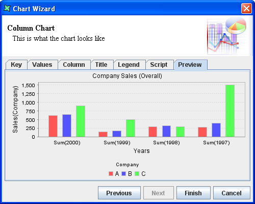

In the Column tab an Invert Data check box is available. There are three data items per point in a chart: Key, Value and Amount. So when you turn on the Invert Data check box the Value and Key are switched over. The first data item controls the Overall grouping, including legend and allocation of colours. The second data item controls the clustering of values along X-axis (Column Chart). The third data items gives you the height of the bar. So, by inverting the data we get the preview as shown in Figure 4.26, “Inverted Data Column Chart”.
If in the above example Key(CompanyName), Value(Year) and Amount(Sales) are the data items. When the invert data check box is selected the Company Name and Year data items are switched but the Sales remains unchanged. The X-Axis title and Legend title have been modified in this example to reflect the inversion of data.

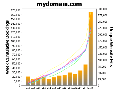

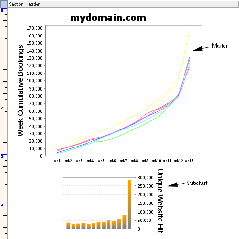

In order to create a dual axis chart like the one shown in Figure 4.27, “Dual Axis Chart”, you need to be able to control each side of the chart independently. To make this easy, you can create two independent chart plots and then merge them into one chart.
We will call the first chart, that will show the final result the Master. The other chart, which will be merged in to the Master we will call the Subchart. The two charts to be merged are shown in Figure 4.28, “Dual Axis Chart Design”.
You will notice that one has the Y axis on the left and the other on the right. To put a Y axis on the right you need to add this script:
importClass(Packages.org.jfree.chart.axis.AxisLocation); plot.setRangeAxisLocation(AxisLocation.TOP_OR_RIGHT);In the designer you will see separate charts, so you can configure them independently. In the rendered output you will only see one combined chart.
importClass(Packages.com.elixirtech.report2.logical.renderer.\
ChartRenderer);
if (cxt!=null) // real rendering
var subChart = cxt.getRawElementByName("Subchart");
var subPlot = ChartRenderer.buildChart(cxt,subChart).plot;
var axis = subPlot.getRangeAxis();
axis.setAutoRange(false);
plot.setRangeAxis(1,axis);
plot.setDataset(1,subPlot.getDataset());
plot.setRenderer(1,subPlot.getRenderer());
plot.mapDatasetToRangeAxis(1,1);
(the text here is wrapped at the \ character on the first line - remove this and concatenate
the first two lines together).
When you have finished designing your two charts, you can put the Subchart anywhere you want - even on top of, or behind the Master as it won't appear in the output. This way it doesn't occupy space you need for other report components
