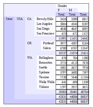

The Cube Table element allows two-dimensional cubes to be embedded in a report. Each cube has two dimensions, one representing the table rows and one the columns. Each dimension may consist of multiple levels, defined by data fields. The records are grouped by these levels and those records forming the intersection of the row and column levels are rendered using one or more cube measures, for example Sum or Average.
An example Cube Table output is shown in Figure 4.31, “Sample Cube Table”. There are a lot of options to control the formatting and presentation of the data.
The designer view of the cube table shown above is illustrated in Figure 4.32, “Cube Table Designer View”. Within the cube table you can see three additional subcomponents - the Row Header (called Store) the Column Header (called Gender) and the Measure Count(store_id). Any additional measures will also appear here.

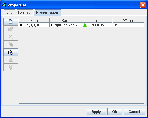

Each measure has properties similar to a Field: alignment, padding, format etc. In addition, each measure has a Properties panel to control presentation. A sample presentation is shown in Figure 4.34, “Measure Presentation Options”.
The presentation options consist of a list of tests, which might be content tests, e.g. Value > 1000 or may be structure tests, e.g. RowLevel==3. Each test is associated with a foreground and background colour, and an optional icon. When formatting a value for display, the list of conditions is scanned from top to bottom looking for a match. When a test returns true, then the associated foreground, background and image are used to render that value. Once a match is found, subsequent tests are ignored.
The most flexible presentation test is through JavaScript. Several variables are predefined so that you can use them in your tests.
The sample shown above sets the background to white for all "normal" rows (i.e. not totals) as shown in the cube table at the beginning of this section. Combinations of these conditions allow for very flexible value rendering. For example, RowLevel==0 && Value>100 will test true for those normal elements whose value is greater than 100, but won't include totals (which are usually bigger).
