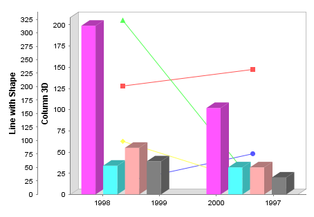

to finalize all the editing. The Composite Chart
will appear like in Figure 4.35, “Composite Chart”.

will be the
name for all the X axes. This is applicable to Y axis as well.
