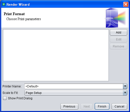

This format is selected if you want to print the reports directly. If you select Print as your output type the Launch to Viewer and the Save to Disk check boxes are disabled. Click the Next button. The screen appears as shown in Figure 5.7, “Print Options”.
Printer Name: Select a printer name from the dropdown list.
Scale to Fit: All reports have one or more page setup configurations which define the default page size for each section of the report. In certain special circumstances you might need to produce an output on a different sized paper. For example to print a scaled copy of an A3 report on an A4 page for inclusion in an A4 binder. To achieve this, you can change the "Scale to fit" value from the default, "Page Setup", to specify a particular paper size. The Save to file information is a render detail option called "Media", stored within the RML file. If you save the RML after using "Scale to fit", then the value will be remembered for next time. Any saved value will also be used when printing through the Repertoire Server.
On clicking the Add button the Print Attribute dialog window appears. There are a number of Attribute Names to choose from:
