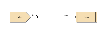

Here's how to use a flow processor to connect the Sales DataSource directly to the Result.
Add a JDBC DataSource Sales using
the procedure given in the previous chapter.
Add a Composite DataSource named Flow.
Drag and drop the Sales DataSource
in the Designer window.
Select the Flow control and connect the output of the
Sales DataSource processor to the
input of the Result. The data flow diagram appears as
shown in Figure 4.4, “Sample Flow”.
