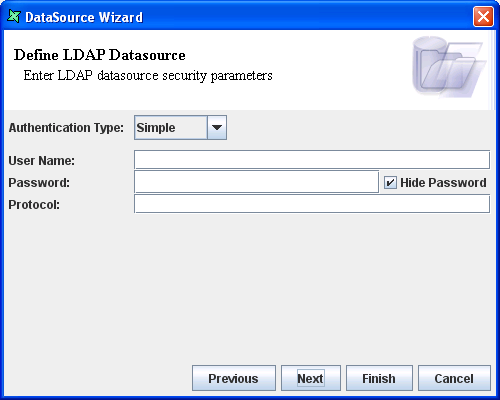

In Figure 11.2, “Security Parameters”, the default type none
has been
changed to simple
so that you can see the available options.
If your server does not require any authentication for read access,
you can leave the authentication type as none
Authentication Type: The value of this property is a string that specifies the authentication mechanism(s) for the provider to use. The following values are defined for this property:
none: If this option is selected from the combo box, then no authentication is required. It is referred to as anonymous bind.
simple: If this option is selected, then a clear text password is used. This type of bind sends an unencrypted user name and password to the LDAP server for verification, and can be secured only by using a secure channel to transmit the password, e.g. SSL.
GSSAPI: GSSAPI stands for Generic Security Services Application Programming Interface. An application level interface (API) to system security services. It provides a generic interface to services which may be provided by a variety of different security mechanisms.
Digest-MD5: In Digest-MD5, the LDAP server sends data that includes various authentication options that it is willing to support, plus a special token to the LDAP client. The client responds by sending an encrypted response that indicates the authentication options that it has selected. The response is encrypted in such a way that proves that the client knows its password. The LDAP server then decrypts and verifies the client's response.
User Name: This property is used to specify the identity of the principal for authenticating the caller to the service.
Password: This property is used
to specify the credentials of the principal for authenticating the
caller to the service. By default, any text entered here is shown
as asterisks (*), unless you turn off the Hide Password
option.
Protocol: The value of this property is a string that specifies the security protocol for the provider to use. The protocol is entered in the text box.

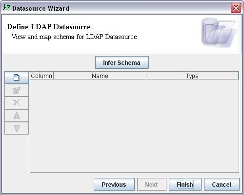

Click Next to display the screen as shown in Figure 11.3, “LDAP DataSource Schema”.
Click Infer Schema to query the LDAP server using the settings you have entered, and extract the schema attributes. The fields and the corresponding data types are displayed in the table. Click Finish to add the data source to the repository.
