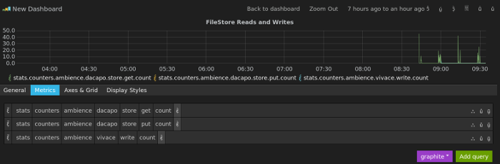

to expand your newly added row.Edit.From the Metrics tab,
add the statistic to be retrieved and displayed, as shown by the example in
Figure 2.3, “Adding the Metrics”.
Note that as you select each component of the statistic, the system filters and displays only the appropriate choices for the next component.

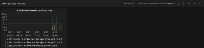

Click the Back to
Dashboard link on the top, to return to your dashboard. The added
statistic is displayed, as shown by the
example in Figure 2.4, “Displaying the Added Statistic”.

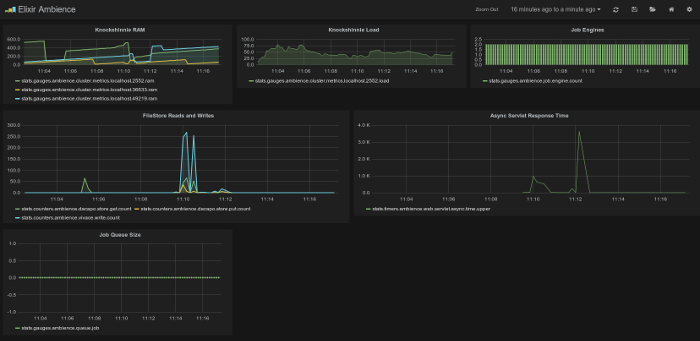

An example of a completed dashboard is shown in Figure 2.5, “Completed Dashboard”.
