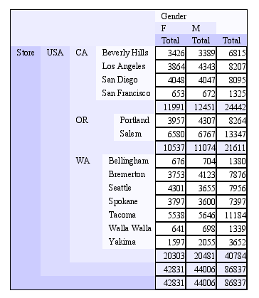

An example Cube Table output is shown in Figure 4.31, “Sample Cube Table”. There are a lot of options to control the formatting and presentation of the data.
Figure 4.31. Sample Cube Table
Sample Cube Table
