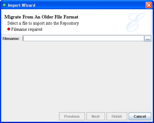

  2. Right-click at the Local File system that you have created. On selecting the Import..., the "Import Wizard" will appear as shown in Figure 9.1, “Import Wizard”. Enter the name of the Report Template (.template) in the text box. Alternatively, you can click on the ... button to launch the File Chooser dialog to select the Report Template that you wish to import.
    Figure 9.1. Import Wizard
    Import Wizard
  3. Click on the Finish button to complete the migration process. The name of the Report Template will be displayed under the Local File system in the repository panel to indicate that the migration is completed.
