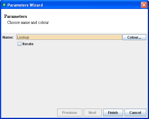

Properties
The Parameter properties are shown in Figure 4.33, “Parameter Wizard”.

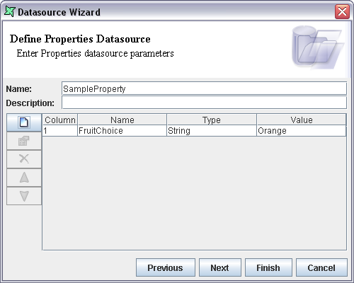

To filter records based on a parameter which is read from a different datasource:
Create a Properties DataSource named SampleProperty.
Click Add Column and in the dialog enter
field Name as FruitChoice, Data Type as String and
the Value as Orange. Click OK. The
column is added to the DataSource. Similarly any
number of fields can be added. After adding the
fields, the DataSource Wizard appears as shown in
Figure 4.34, “Completed Properties DataSource”. Click Finish.
(For more
information on working with Properties DataSource
refer to Chapter 8, Properties DataSource.)

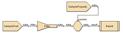

Add a Tabular DataSource SampleFruit which
includes a column listing each fruit name.
Drag and drop SampleFruit onto the Composite diagram.
Place a Filter on the diagram and use a Flow to connect SampleFruit DataSource processor to the Filter processor.
Invoke the Filter Properties and in
the Filter#1 tab select Matches from the
When combo box in the Fruit row. Enter
the condition as ${FruitChoice} where ${FruitChoice} is
the dynamic parameter we get from the Properties datasource.
For more information on dynamic parameters
refer to Appendix A, Dynamic Parameters.
Click Finish.
Place a Parameter processor on the diagram.
Connect the Filter output to the data input of the parameter processor.
Drag and drop the SampleProperty onto
the diagram.
Connect the SampleProperty data source with the
params input of the Parameter processor.
Finally, connect the output of the Parameter processor to the Result. The diagram appears as shown in Figure 4.35, “Sample Parameter Flow”.

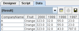

Select Result and choose View from the popup menu. The output is shown in Figure 4.36, “Parameter Result”. As the Value of FruitChoice in the property DataSource is Orange, the records corresponding to Orange are fetched.
