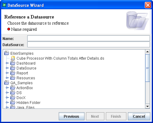

The Reference DataSource Wizard is shown in Figure 9.1, “Reference DataSource Wizard”.
Figure 9.1. Reference DataSource Wizard
Name: Enter a unique name for the Reference DataSource.
DataSource: Select the DataSource for which the parameter values need to be set.

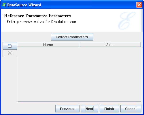

Click Extract Parameters as shown in Figure 9.2, “Reference DataSource Wizard Page Two” to extract parameters from the datasource or define parameters explicitly using the buttons on the left. Click End to end the creation process.
Figure 9.2. Reference DataSource Wizard Page Two
