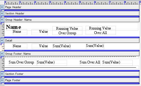

To illustrate the use of summation and running values, here's a simple example. We start with the data in Figure 4.5, “Sample Data”. We will group it by Name and perform operations on the Value. A report is designed, as shown in Figure 4.6, “Sample Running Sum Report”. The report demonstrates the use of running values and over all/over group.
Figure 4.6. Sample Running Sum Report

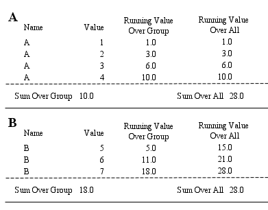

When the report is rendered, the output appears as shown in Figure 4.7, “Running Sum Output”. Note that in the first group footer, you can still get Sum Over All, even though all records have not yet been processed. Indeed, you can put this value in the header, before any records have been processed. In the 'B' group, Running Value Over Group is reset to 0, whereas Running Group Over All continues from the value 10.0 that was built by group 'A'.
