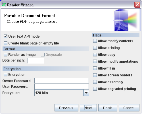

The PDF render properties are shown in figure Figure 5.5, “PDF Options”.
Use iText API mode
This flag enables use of the iText API mode which addresses an issue with JDK 1.7 output. By default JDK 1.7 outputs text as glyphs which results in higher accuracy of output, but much bigger files. The accuracy is due to the conversion to vector graphics within the engine, instead of within the PDF viewer. A benefit of the default JDK 1.7 behaviour is that no fonts need to be embedded.
However, where reports need to be transmitted across the network or archived, the increase in file size (which may be a factor of ten or more) can be excessive. By enabling API mode, the renderer outputs characters instead of glyphs to produce smaller files. This may cause some minor discrepancies in the report, for example a line of text may be fractionally longer or shorter because it is now the PDF viewer that chooses the best font match. In API mode, fonts can be embedded to ensure the viewer chooses an appropriate font.
Create blank page on empty file
Create blank page on empty file option allows empty file such as 0 bytes size file to be rendered into the pdf output successfully with blank page created. However, if the option is disabled, 0 bytes file size will fail to render into pdf output.
Format
Image: When this option is selected then in the rendered PDF document each page will be a page-sized image. This results in bigger files, but requires no embedded fonts.
Grey Scale: When this is selected then the output will be displayed in shades of grey instead of color which will make the file size smaller. If you will only be printing in black and white then it might be useful to reduce memory usage.
Dots per inch: Dots per inch indicates the desired resolution of the rendered image - larger values mean increased sharpness, but bigger file size.
Encryption
When this check box is selected the PDF file is encrypted with user and owner passwords. Encryption allows owners to control certain functions such as printing the file, copying and pasting from the file. So only when this check box is selected we can set the flag values. If the owner password is left blank, the system will generate a random password - effectively preventing anyone from changing the access options.
The encryption strength either 40 bits or 128 bits is selected from the combo box. The 40-bit strength is the standard one. You can increase a document's cryptographic strength by using 128-bit security.
Flags
With encryption enabled, a PDF viewer will determine the operations that can be performed on the document based on the list of flags.

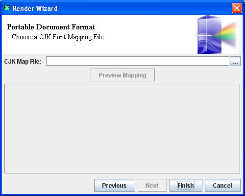

CJK Font Mapping
The PDF specification defines 14 built-in fonts. If you use fonts that are not part of the specification they can be embedded in the report (subject to font licensing) or the glyphs can be rendered as vectors, removing the need for the font, but making selection impossible.
CJK Fonts can be very large, so embedding the glyphs or even the font itself results in large files. The next page of the PDF Render Wizard allows font names to be substituted, retaining small files, as long as the CJK fonts are available on the reader devices. The wizard page is shown in Figure 5.6, “PDF CJK Mapping”.
The CJK Mapping File is a text file, which contains a substitution on each line. For example:
Serif=STSong-Light SansSerif=MSung-Light
You can create this mapping file as a text file in the repository, so that many reports can share it and so you can easily deploy it to the Repertoire Server if necessary. Once the mapping file is chosen, all text in the report that use Serif font will be written to PDF as STSong-Light.
The font metrics used in placement of the text will still use Serif, so it is important to choose substitutions with closely matching font metrics. Adobe does not allow the free use of their CJK fonts which prevents use of the actual CJK font metrics.
Common CJK font encodings are defined in /config/EREngine-config.xml. You can add extra definitions here if you need additional fonts, but will need to restart the tool for them to be read.
