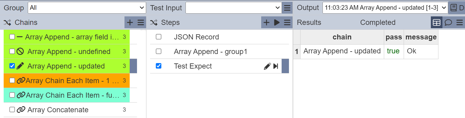

There are four panels available at all times, each displays specific information related to the selected chainset. The following sections below describe each of the panels.
- Chains - displays the list of chains in the chainset
- Steps - displays all steps of a selected chainset
- Results - displays the output of a specific run record and list of run logs for the chainset
