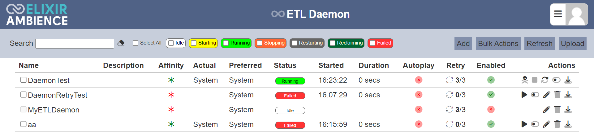

There are several columns in the ETL daemon management page.
| Column | Description |
| Name | Name of ETL daemon. |
| Description | Brief description of ETL daemon. |
| Affinity | It is green when the values of “Actual” and “Preferred” are equal, otherwise it is red. |
| Actual | Actual Ambience instance that is running the ETL daemon. |
| Preferred | Preferred Ambience instance to run the ETL daemon, set in System Settings module. |
| Status | Current status of ETL daemon. |
| Started | When the ETL daemon was started. |
| Duration | Indicates how long the ETL daemon has been running. |
| Autoplay | Indicates a green tick if autoplay is turned on, otherwise a red cross if autoplay is turned off. |
| Retry | Current retry logic state Spinning icon indicates current retrying. “2/3” indicates 2 of 3 retries remaining. |
| Enabled | Shows a green tick if enabled, otherwise a red cross if the ETL daemon is disabled. |
| Actions | List of actions to be performed on the ETL daemon. |

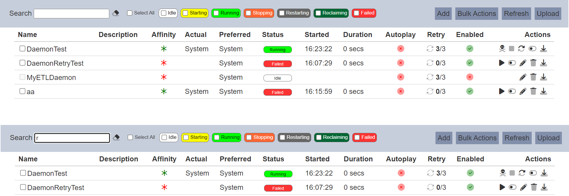

The checkboxes beside the “Select All” field and status allow users to filter the ETL daemon that are listed in the page.

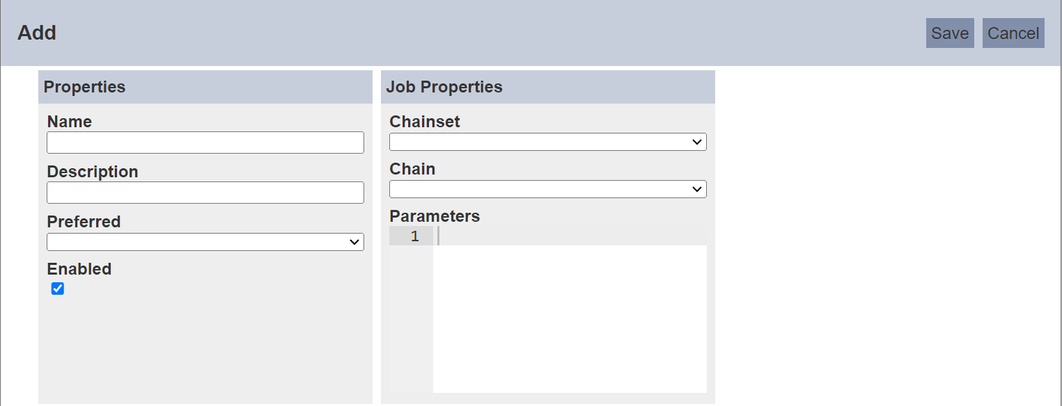

To add a ETL daemon, start by clicking on the “Add” button on the upper right corner of the page.
The “Add Panel” will appear.
| Properties | |||||
| Name | Unique name assigned to the ETL daemon. | Y | Text field | Any text (case-sensitive) | Empty string |
| Description | Brief description for the ETL daemon. | N | Text field | Any text | Empty string |
| Preferred | Select the preferred Ambience instance to run the ETL daemon. | Y | Drop-down list | Select from list | Not selected |
| Enabled | If selected, enables the ETL daemon. | Y | Checkbox | True (selected) or false (unselected) | Selected |
| Job Properties | |||||
| Chainset | Select the ETL chainset to be used. | N | Drop-down list | Select from list | Not selected |
| Chain | Select the ETL chain to be used. | N | Drop-down list | Select from list | Not selected |
| Parameters | JSON parameters to pass to the ETL daemon. | Y | Text field | Any text | Empty string |
In the “Properties” section, key in an unique name for the new ETL daemon in the “Name” field. It is case-sensitive. Provide a brief description on the ETL daemon in the “Description” field. Select the desired system ID from the drop-down list in the “Preferred” field. The “Enabled” field is selected by default. Do note that only enabled ETL daemons can be run.
In the “Job Properties” section, select the desired ETL chainset and chain for the ETL daemon in the “Chainset” and “Chain” fields respectively. In the “Parameters” field, key in the desired parameters in JSON format for the ETL daemon.
For the ETL chain to appear in the drop-down list, the ETL chain must contain the ETL Daemon Signature step and include an ETL step that performs a continuous task that has been designed to work with the ETL daemon. Currently, these steps are :
- Daemon MQTT Reader
- Daemon Timer
Click on the “Save” button at the top right corner of the panel to create the new ETL daemon. Clicking on the “Cancel” button aborts the action.

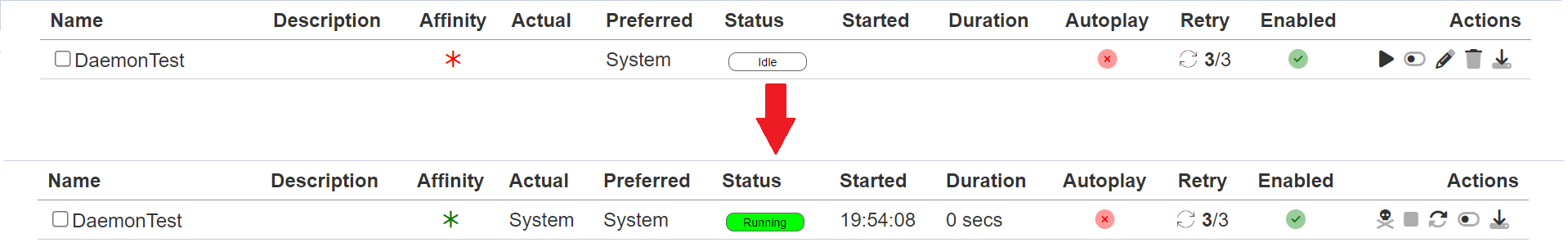

Run
To run a ETL daemon, click on the
“Run” icon under the “Actions” column corresponding the desired daemon.
If any error occurs, an error message will appear and the daemon will stop running.
Once the ETL daemons runs, the status of the daemon will change from “Idle” to “Starting”. The
“Busy” icon will appear in the “Actions” column. Once the Ambience instance picks up the ETL daemon, the status will change to “Running”. Do note that the “Busy” icon may not be noticeable, as the duration may be too short.

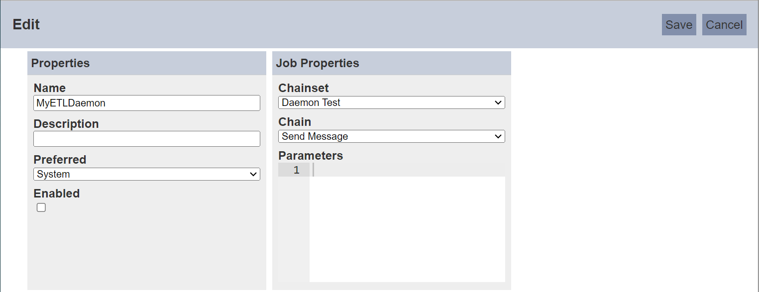

To modify an existing ETL daemon, click on the
“Edit” icon under the “Actions” column corresponding the desired daemon.
Edit as desired and click on the “Save” button to save the changes. Once the daemon is saved, a message will appear.

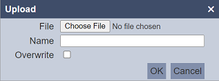

To upload a ETL daemon, start by clicking on the “Upload” button on the upper right corner of the page.
Browse to the location of the file (<filename>.daemon.json) to be uploaded and set the “Name” field. By default, the “Name” field uses the name of the upload file. You can change it to an appropriate name if desired. If the file to be uploaded is to replace an existing daemon, select the “Overwrite” field. Do note that the “Name” field must be unique, or an error message will appear.
| File | Browse to select file to be uploaded. | Y | “Choose File” button | Any text | Empty |
| Overwrite | If selected, overwrites existing daemon. | N | Checkbox | Select or not selected | Not selected |
If the name of the daemon to be uploaded already exist, an error message will appear.
To overwrite the existing daemon, select the “Overwrite” field in the dialog box, then click on the “OK” button.
