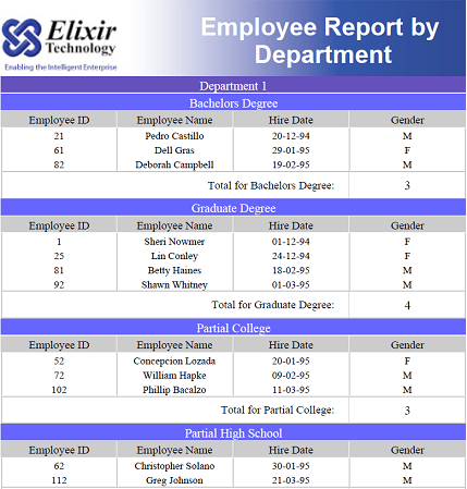

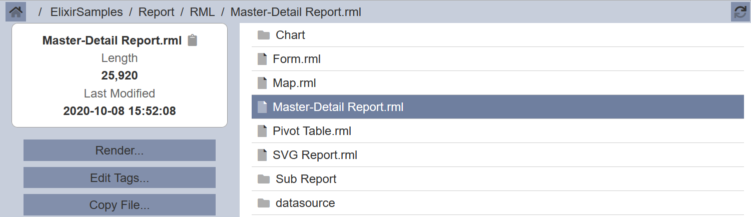

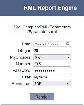

To generate the RML report through the Repository module, select the RML document and click the “Render” button.

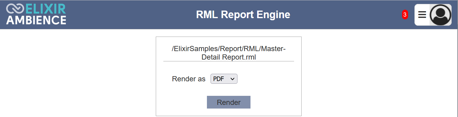

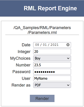

The RML Report Engine page will appear.

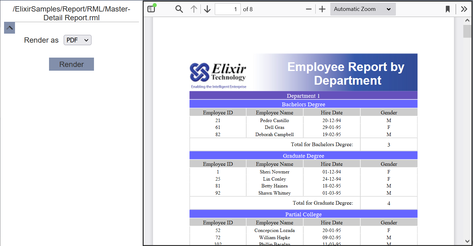

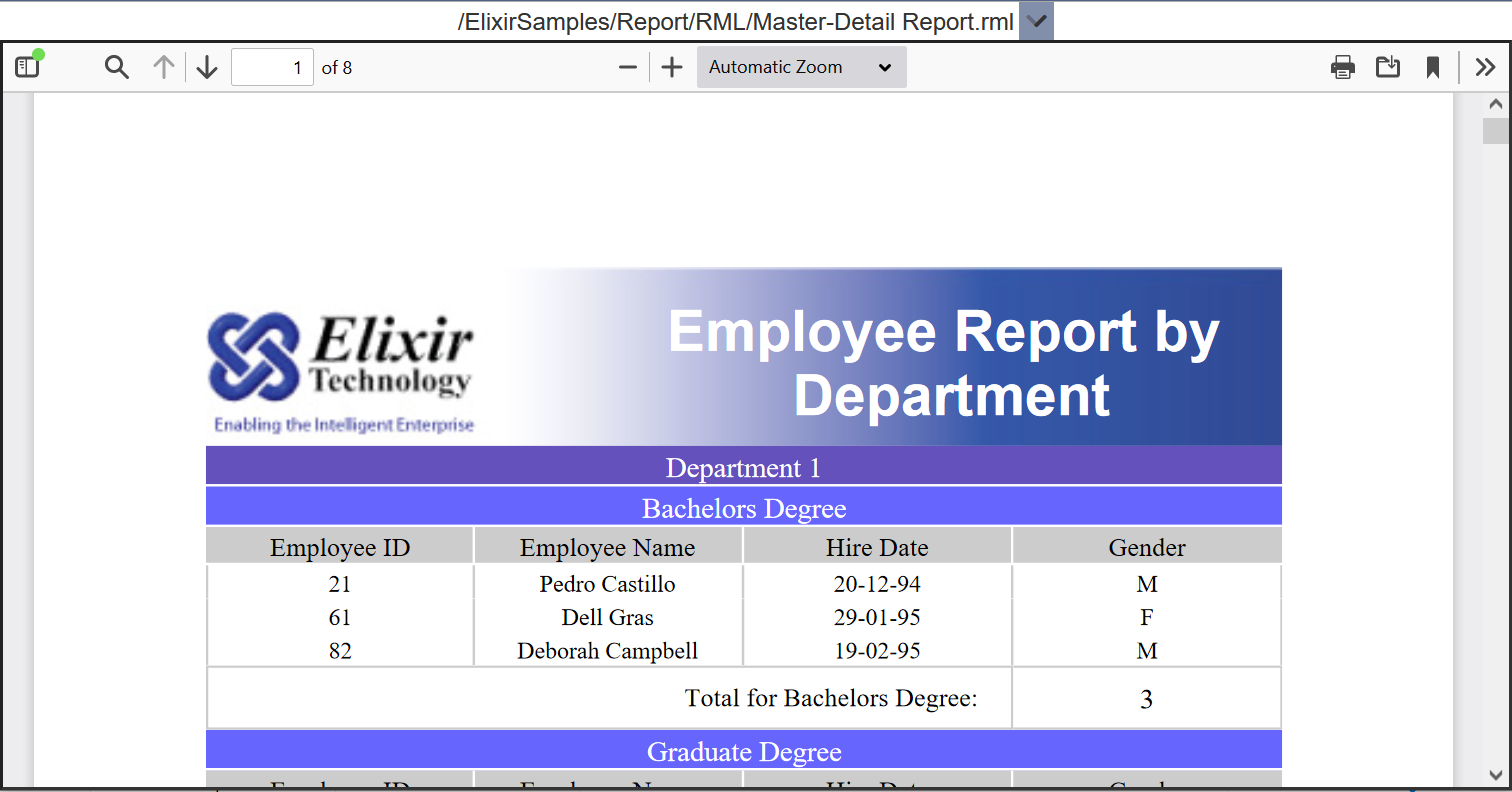

Select the desired format (PDF or XLSX) from the drop-down list and click on the “Render” button. The report is generated using the DS file as content and the RML file as template. If the browser permits, the report is displayed in another tab.
There is an additional option to display the generated report in the RML Report Engine page. To use this, you will need to add the following line into the application.conf file. For example, to show PDF files on the same page:
ambience.rml-engine.ui-left-parameters = ["application/pdf"]
If the browser permits, you can also display HTML or XLSX format in the RML Report Engine page. You simply add the corresponding mime-types into the list (comma separated) in the application.conf file.
You will need to restart the server for the display to take effect. With this option enabled, where possible, the generated report will be displayed in the RML Report Engine page instead of another browser tab.
You can opt to close the left panel to maximise the report in the page by clicking on the “Hide Parameters” icon on the left of the left panel.
To expand the left panel, click on the “Show Parameters” icon next to the path of the report at the top.

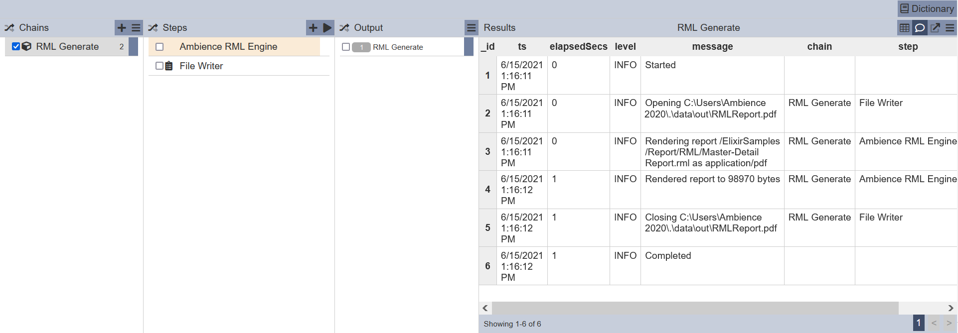

Generate RML Via ETL

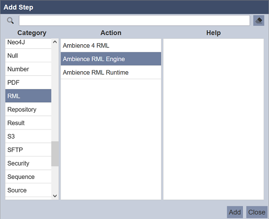

Another way to generate RML report is to use the ETL chainset. There are several ETL steps that can be used to generate the RML report.
In the simple example below, the ETL chainset generates the RML report and writes to a PDF.
  • Generates RML report in the desired output format
  • Writes the output file to the desired location and filename
Click on the “Run Steps” icon to generate the RML report.

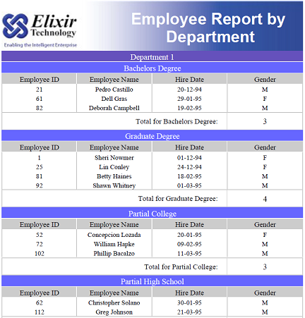

-d '{"rml": "/ElixirSamples/Report/RML/Master-Detail Report.rml"}' -o result.pdf
The result PDF will be displayed with the content of Master-Detail Report.rml.
