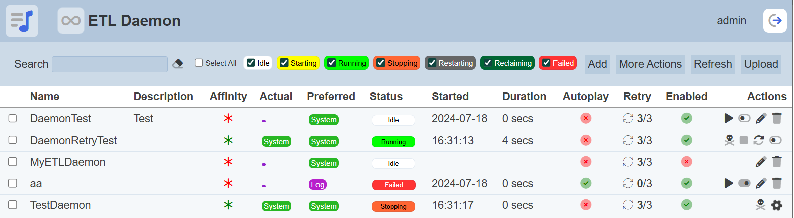

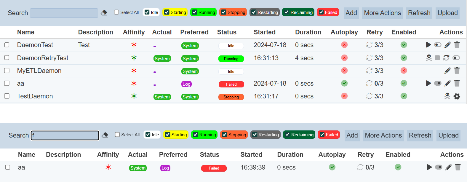

There are several columns in the ETL daemon management page.
| Column | Description |
| Name | Name of ETL daemon. |
| Description | Brief description of ETL daemon. |
| Affinity | It is green when the values of “Actual” and “Preferred” are equal, otherwise it is red. |
| Actual | Actual Ambience instance that is running the ETL daemon. |
| Preferred | Preferred Ambience instance to run the ETL daemon, set in System Settings module. |
| Status | Current status of ETL daemon. |
| Started | When the ETL daemon was started. |
| Duration | Indicates how long the ETL daemon has been running. |
| Autoplay | Indicates a green tick if autoplay is turned on, otherwise a red cross if autoplay is turned off. |
| Retry | Current retry logic state  Spinning icon indicates current retrying. “2/3” indicates 2 of 3 retries remaining.  |
| Enabled | Shows a green tick if enabled, otherwise a red cross if the ETL daemon is disabled. |
| Actions | List of actions to be performed on the ETL daemon. |

Status
The status of the ETL daemons are as follows:
| Status | Description |
| Idle | ETL daemon not running. |
| Starting | ETL daemon was started by the run action but has not yet been picked up by an Ambience instance. |
| Running | ETL daemon is running |
| Stopping | ETL daemon was stopped by the stop action but has yet been stopped.  Stop is not always immediate as the ETL chain will await for a safe place to stop in a managed way.  |
| Restarting | ETL daemon was restarted by the restart action and is still in the process of restarting. |
| Reclaiming | ETL daemon was running in a non-preferred Ambience instance and the preferred instance was started causing the ETL daemon to be reclaimed automatically. |
| Failed | ETL chain that the ETL daemon was running has failed and all retries wre exhausted. |
The checkboxes beside the “Select All” field and status allow users to filter the ETL daemon that are listed in the page.

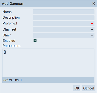

To add a ETL daemon, start by clicking on the “Add” button on the upper right corner of the page.
The “Add Daemon” dialog box will appear.
| Name | Unique name assigned to the ETL daemon. | Y | Text field | Any text (case-sensitive) | Empty string |
| Description | Brief description for the ETL daemon. | N | Text field | Any text | Empty string |
| Preferred | Select the preferred Ambience instance to run the ETL daemon. | Y | Drop-down list | Select from list | Not selected |
| Chainset | Select the ETL chainset to be used. | N | Drop-down list | Select from list | Not selected |
| Chain | Select the ETL chain to be used. | N | Drop-down list | Select from list | Not selected |
| Enabled | If selected, enables the ETL daemon. | Y | Checkbox | True (selected) or false (unselected) | Selected |
| Parameters | JSON parameters to pass to the ETL daemon. | Y | Text field | Any text | Empty string |
Key in an unique name for the new ETL daemon in the “Name” field. It is case-sensitive. Provide a brief description on the ETL daemon in the “Description” field. Select the desired system ID from the drop-down list in the “Preferred” field.
Select the desired ETL chainset and chain for the ETL daemon in the “Chainset” and “Chain” fields respectively. In the “Parameters” field, key in the desired parameters in JSON format for the ETL daemon.
The “Enabled” field is selected by default. Do note that only enabled ETL daemons can be run.
For the ETL chain to appear in the drop-down list, the ETL chain must contain the ETL Daemon Signature step and include an ETL step that performs a continuous task that has been designed to work with the ETL daemon. Currently, these steps are :
- Daemon MQTT Reader
 - Daemon Timer
Click on the “Save” button at the top right corner of the panel to create the new ETL daemon. Clicking on the “Cancel” button aborts the action.
If the “Preferred” field is left empty, an error message will appear.
If the name already exist or the name is missing, the relevant error message will appear.
Upon successful saving the ETL daemon, a message will appear.

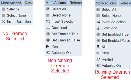

This function allows you to perform the same action on multiple daemons.
To perform an action on multiple daemons, select one or more checkboxes next to desired daemons. Click on the “More Actions” button at the upper right corner of the page.
Select the desired action to perform from the list. The available options that appear in the list depends on the status of the ETL daemon. If the selected daemons are running, the below options will be available.
If no daemon is selected, only the first three options will appear, which allows you to either select all, select none or invert selection.
| Select All | Selects all ETL daemons in the list. |
| Select None | Unselects all ETL daemons. |
| Invert Selection | Inverts the current selection.  That is, any ETL daemons selected will be unselected and vice versa.  |
| Download | Downloads multiple ETL daemons as a zip file.  If only one ETL daemon is selected, the selected ETL daemon will be downloaded as a JSON file.  |
| Set Enabled True | When selected, sets the selected ETL daemons to enable. |
| Set Enabled False | When selected, sets the selected ETL daemons to disable. |
| Kill | Kills the selected ETL daemons. |
| Stop | Stops the selected ETL daemons. |
| Restart | Restarts the selected ETL daemons. |
| Autoplay On/Off | Toggles autoplay to on/off for the selected ETL daemons. |
To download the selected ETL daemons, click on the “More Actions” button and select the “Download” option.
If only one daemon is selected, the downloaded daemon has a filename of <filename>.etl-damon.json.
If more than one daemon are selected prior, the “Download” dialog box will appear.
Key in the desired name for the zip file and click on the “OK” button. The selected ETL daemons will be downloaded as a zip file with the filename provided earlier. The individual ETL daemon in the zip file will have the filename format as mentioned above.

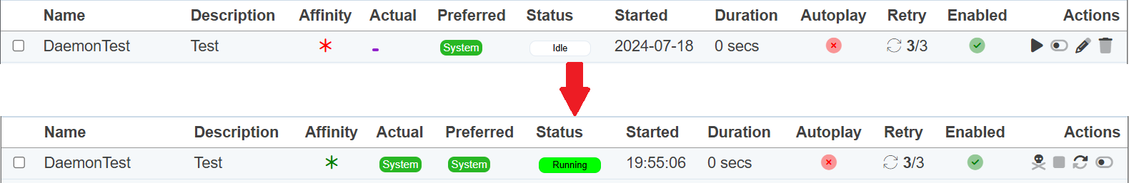

Run
To run a ETL daemon, click on the
 “Run” icon under the “Actions” column corresponding the desired daemon.
If any error occurs, an error message will appear and the daemon will stop running.
Once the ETL daemons runs, the status of the daemon will change from “Idle” to “Starting”. The
 “Busy” icon will appear in the “Actions” column. Once the Ambience instance picks up the ETL daemon, the status will change to “Running”. Do note that the “Busy” icon may not be noticeable, as the duration may be too short.
The available icons will change according to the status of the ETL daemon.

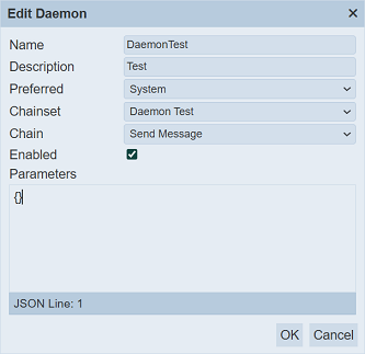

To modify an existing ETL daemon, click on the
 “Edit” icon under the “Actions” column corresponding the desired daemon.
The “Edit Daemon” dialog box will appear.
Edit as desired and click on the “Save” button to save the changes. Once the daemon is saved, a message will appear.

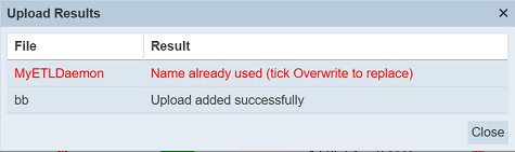

Click on the “OK” button to upload the selected file. Click on the “Cancel” button to abort the action.
For uploading a single file, a message will appear after the file has been successfully uploaded.
If the name of the daemon to be uploaded already exist, an error message will appear.
To overwrite the existing daemon, select the “Overwrite” field in the dialog box, then click on the “OK” button.
For uploading a zip file, the “Upload Results” dialog box will display the results of the uploading.

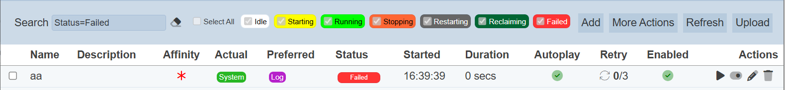

You can arrange/sort the list of daemons in ascending or descending order by clicking on the name of the desired field. By default, the list is sorted by the “Name” field in ascending order.
After performing actions on the browser/tab, the list is reloaded to display the ETL daemons. The manual “Refresh” button is available and is particularly useful if there are others making changes on the same page.
 - Actual
 - Preferred
 - Status
 - Started
 - Retry
Alternatively, you can click on the any items under the “Actual”, “Preferred” or “Status” columns respectively to aid the search for the daemons in the page.
In the example above, ETL daemons that are assigned the role “tester” are shown.
