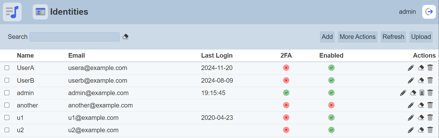

Identities
People need to be identified (authenticated) before they can be authorised to use all the different modules in Ambience. If you already have an authentication system, such as an SSO, LDAP or Active Directory, then it is possible to use that as the authentication mechanism. However if you do not have a mechanism, or want to keep Ambience separate, an identities module is provided which handles the authentication part of the login process. This identities system is built upon OAuth2, which is what makes it possible to plug in alternate authentication providers.
The Identities module provides a simple mechanism for authentication (determining who is logging in). The Users module provides the corresponding mechanism for authorisation (determining what each authenticated user can access).
The Identities module provides a simple interface to manage user identities. Once the user identity has been created, it can be assigned roles and privileges through the Users module. The Identities module also allows you to enable or disable, edit details and reset the password of a user, as well as resetting their Two Factor Authentication (2FA).

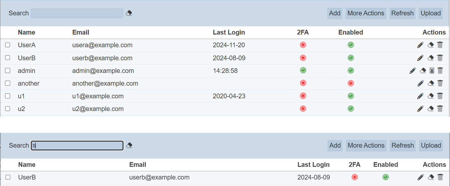

Refresh List
Add User
The “Add Identity” dialog box will appear.
In the dialog box, enter the name and email of the user to be created. Ensure that the “Enabled” box is checked to enable the user. The enabled user is indicated with a green tick, while a disabled user is indicated with a red cross in the “Enabled” column in the main page.
Upload User
Edit User
