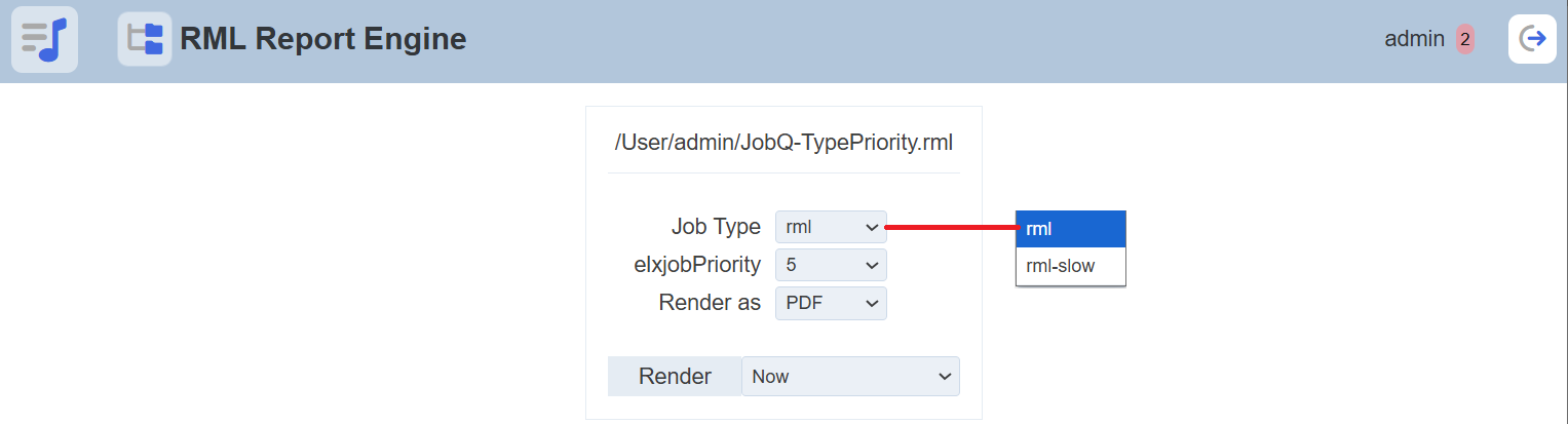

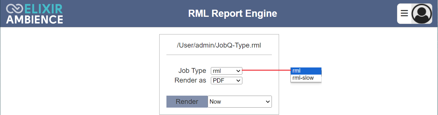

Add Parameters To RML
Connect the Designer to the Ambience server. Open an RML and add a parameter.
Two choices are provided: rml and rml-slow to match the names of the two job types. Save the RML and go to the Repository and render the modified RML.
If rml is chosen, the main “web” server (Server1) will render the report. If rml-slow is chosen, then slow server (Server2) will render the report.

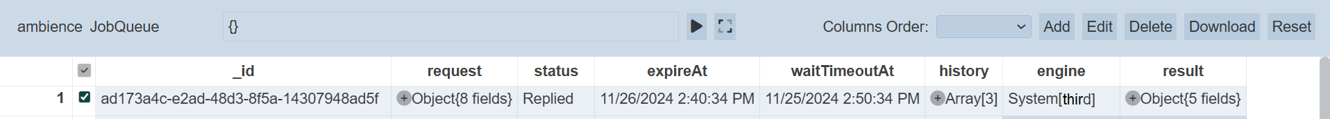

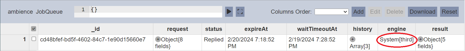

From the JobQueue collection, under the “engine” column, the third engine is selected to run the report.

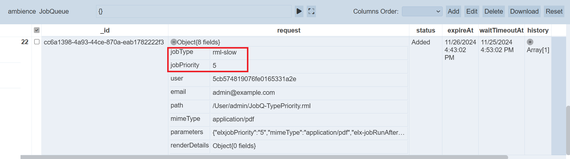

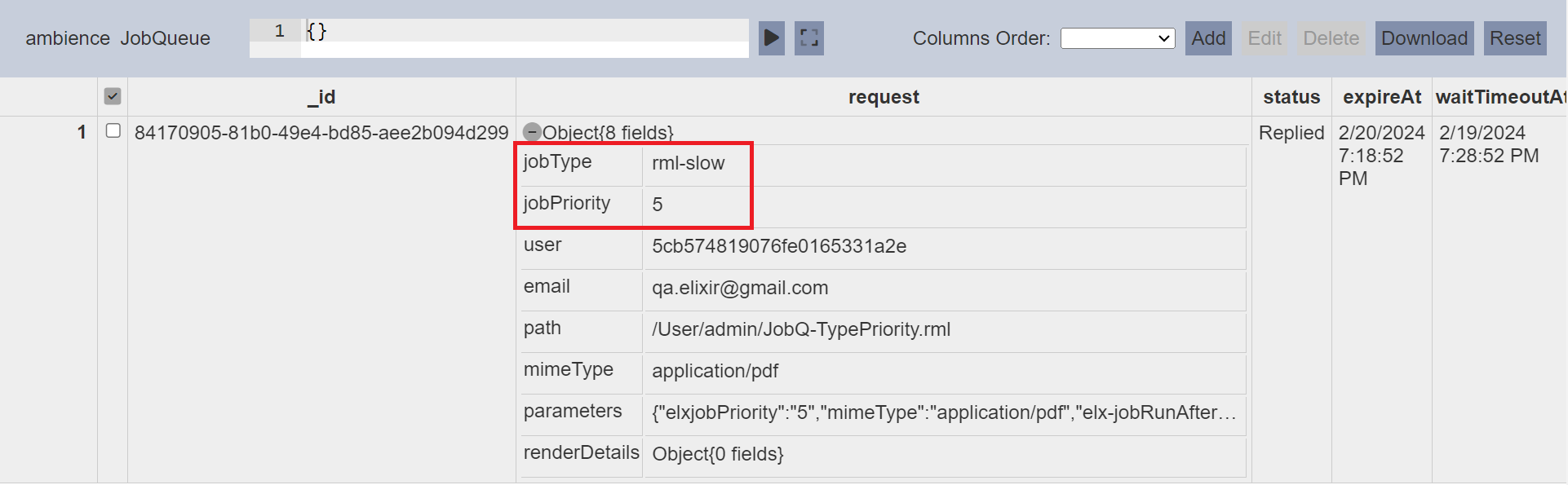

The elx-jobPrority governs how items are ready from the queue. It can be defined just like the elx-jobType in the Designer.
When an engine is looking for work, it will sort the eligible jobs (i.e., those with a jobType it understands) by:
jobPriorityexpireAttime (derived from when it was added to the queue)
In other words, with three priority 5 reports, the earliest added would be chosen, but any priority 1 report would be done first.
In the above example, user chooses between 1, 3, 5, 7, 9, with the default being 5. The JobQueue shows the selected value.
No elx-jobPriority was set, so the default of 5 is chosen. If a value is to be specified, then “1” is the first (highest) priority. There is no limit on the number, a value of “100” can be set for a very, very low priority job, for example. Again, this value can be passed as part of the URL if it is calling the server from outside. Below is en example:
elx-jobType=rml-slow&elx-jobPriority=7
