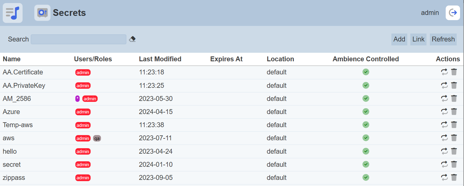

The Secrets module acts as a repository and manager for secrets, such as passwords, which can be accessed via ETL. These secrets can be stored either internally (such as MongoDB or binary store) or in an external vault (such as Hashicorp Vault).
Do note that Hashicorp is disabled in Ambience by default. See Hashicorp and Config Vault sections on more information on how to install Hashicorp Vault and configure Ambience to include Hashicorp.
See the Examples section on how the secrets can be used.
| Secrets | Allows Secrets module access, allows creation and management of secrets | mod-secrets |
| Secrets | Allows reading of secrets only | mod-secrets-reader |

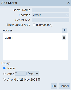

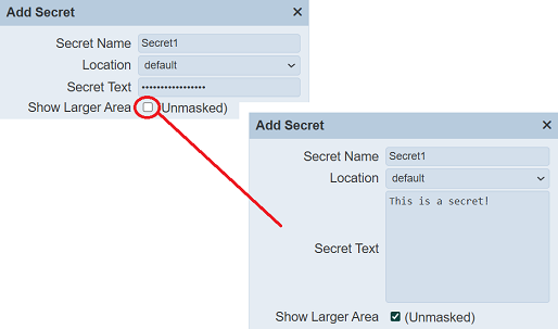

To add a secret, click on the “Add” button at the upper right corner of the page.
The “Add Secret” dialog box will appear.
THis dialog box can be divided into three parts. The first four property fields, the “Access” field and the “Expiry” field.
Property Fields
| Secret Name | Unique name of the secret. | Textbox | None |
| Location | Location of the secret to be located.  See Config External Vault for more details on how to add external vaults.  |
      Drop-down list | “default” |
| Secret Text | Encrypted text of the secret. | Textbox | None |
| Show Larger Area (Unmasked) | If selected, displays the secret text unencrypted. | Checkbox | Not selected |
| Access | Users or roles that can access this secret. | Dialog box | owner’s name |
| Expiry | Unique name of the secret. | Textbox | None |
Key in an unique name for the colour in the “Name” field. Select the desired location for the secret from the drop-down list from the “Location” field.
In the “Secret Text” field, key in the secret text. The text will be encrypted. To view the text un-encrypted, select the checkbox next to the “Show Larger Area” field.

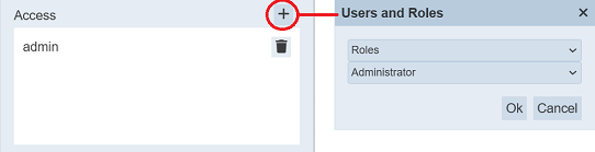

Access
The “Access” field allows you to add users and/or roles to the secret. By default, the owner is added into the list. To add a new user/role, click on the “+” icon above the list. The “Users and Roles” dialog box will appear.
The first drop-down list allows you to select either Roles or Users or All. The second drop-down list displays the available options based on the selected option above. Selected the desired role/user and click on the “OK” button. The new role/user will be added onto the list.
To remove a role/user, click on the
 “Delete” icon next to the desired role/user.

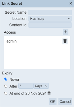

To add a link, click on the “Link” button at the upper right corner of the page.
The “Link Secret” dialog box will appear.
There are three parts in the dialog box. The first three property fields, the “Access” field and the “Expiry” field.
For the first three property fields, key in a unique name for the secret in the “Secret Name” field. This is the Ambience name for the secret and may be different to the name of the secret within the vault it is stored in.
Enter the Content Id on the “Content Id” field.
The Hashicorp vault stores secrets as a key value pair with a name. When linking a secret stored in a Hashicorp, the Content Id must take the form <name>.<key> where <name> is the Hashicorp name and may or may not be the same as the name Ambience will refer to it as.
There are two parts in the dialog box:
Refer to the relevant sections for more information on the part by clicking the links above. Once the link secret is created, the secret will appear in the management page with a red cross in the “Ambience Controlled” column.

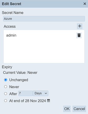

This function allows you to change the properties of the secret. The secret text will not be shown and cannot be edited. It can only be replaced.
To edit a secret, click on the name of the desired secret under the “Name” column.
The “Edit secret” dialog box will appear.
There are three parts in the panel:
Refer to the relevant parts for more information on the part by clicking the links above. The secret text will not appear in this dialog box.
Edit the fields as desired and click on the “Save” to save the changes. To abort the change, click on the “Cancel” button.

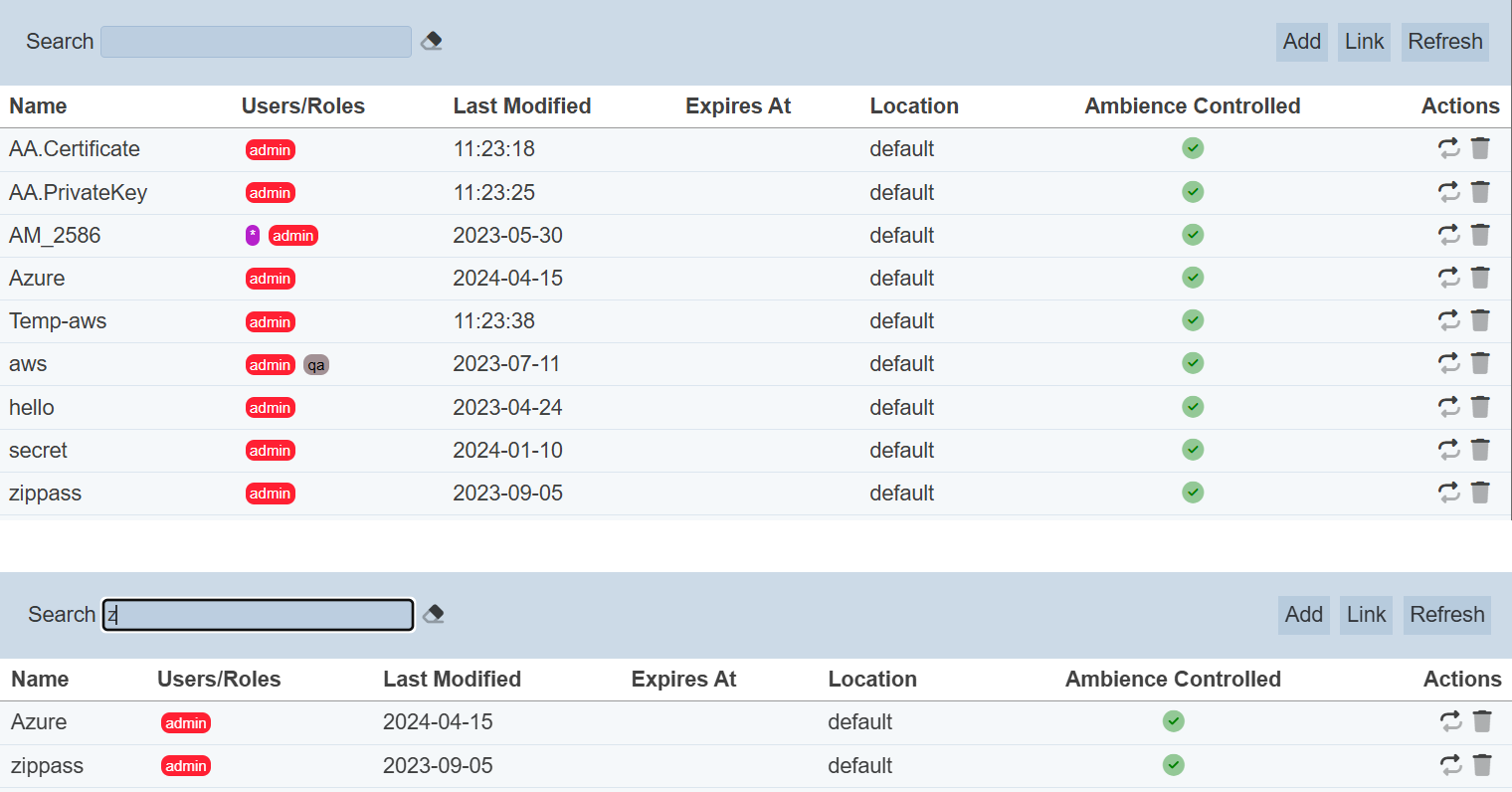

There is a cross-field search function for the list of secrets. It is located at the upper left corner of the page.
This provides an easy way to search through the list of secrets. It is case-insensitive and displays secrets that have the entered search value in any of the values of the fields below:
 - Users/Roles
 - Expires at
 - Location

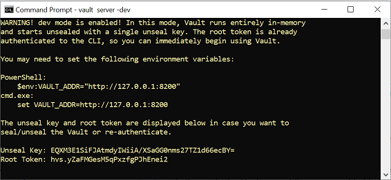

Open a command line terminal, navigate to the location where the Hashicorp is installed and run the following command:
vault server -dev
to start the server in “dev” mode.
The vault server will produce a token. Below is an example. Copy the token.
