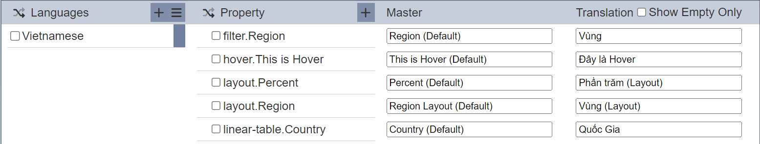

Below is the list of IDs that can be used for the I18N module.
- filter.XXX
- hover.XXX
- linear-table.XXX
- layout.XXX
where XXX is the field.

First, create a dashboard. Next, in the Internationalisation module, create the desired translation for the dashboard.

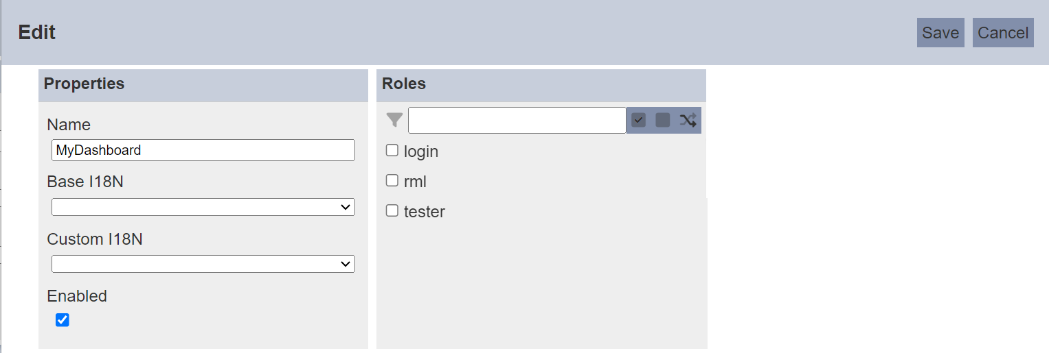

To use the translation on the dashboard, click on the
“Edit” icon to edit the dashobard.
Select the desired I18N translation on the “Base I18N” or “Custom I18N” field and click on the “Save” button to save the change.

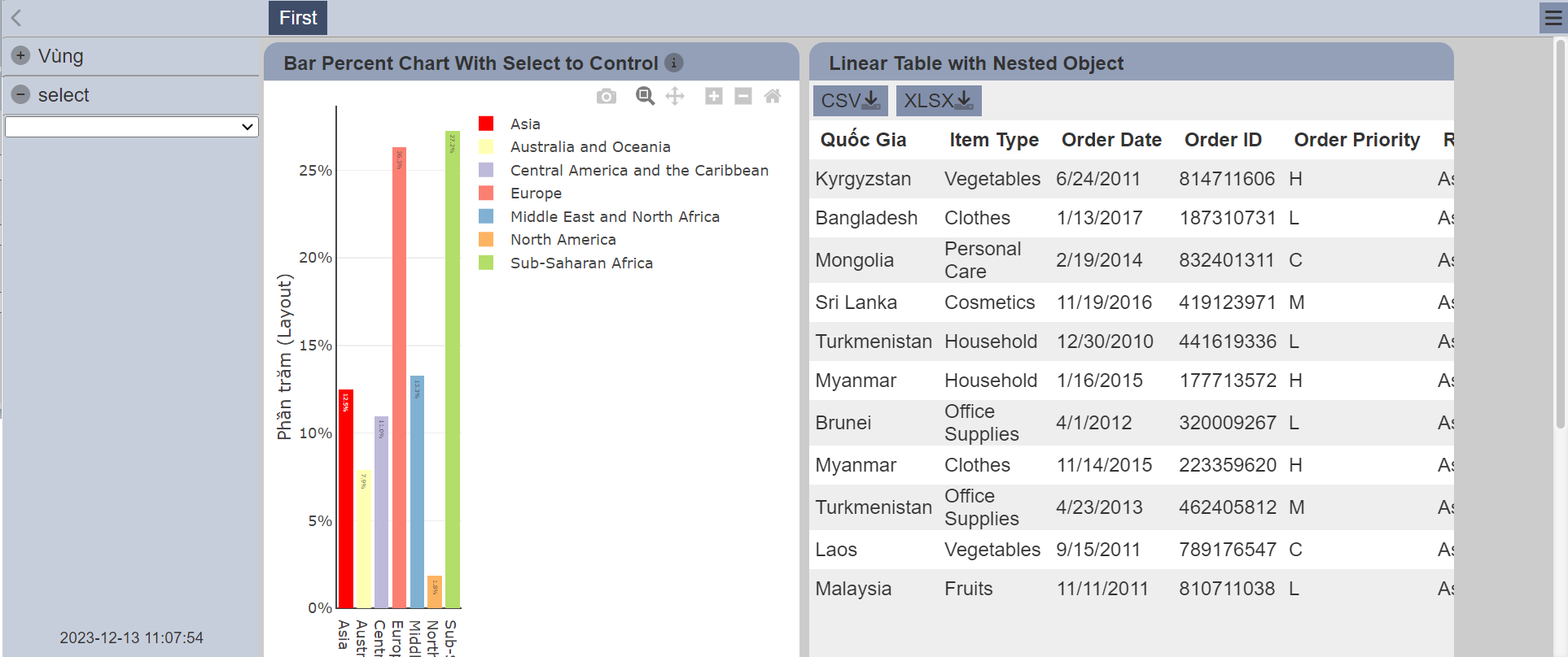

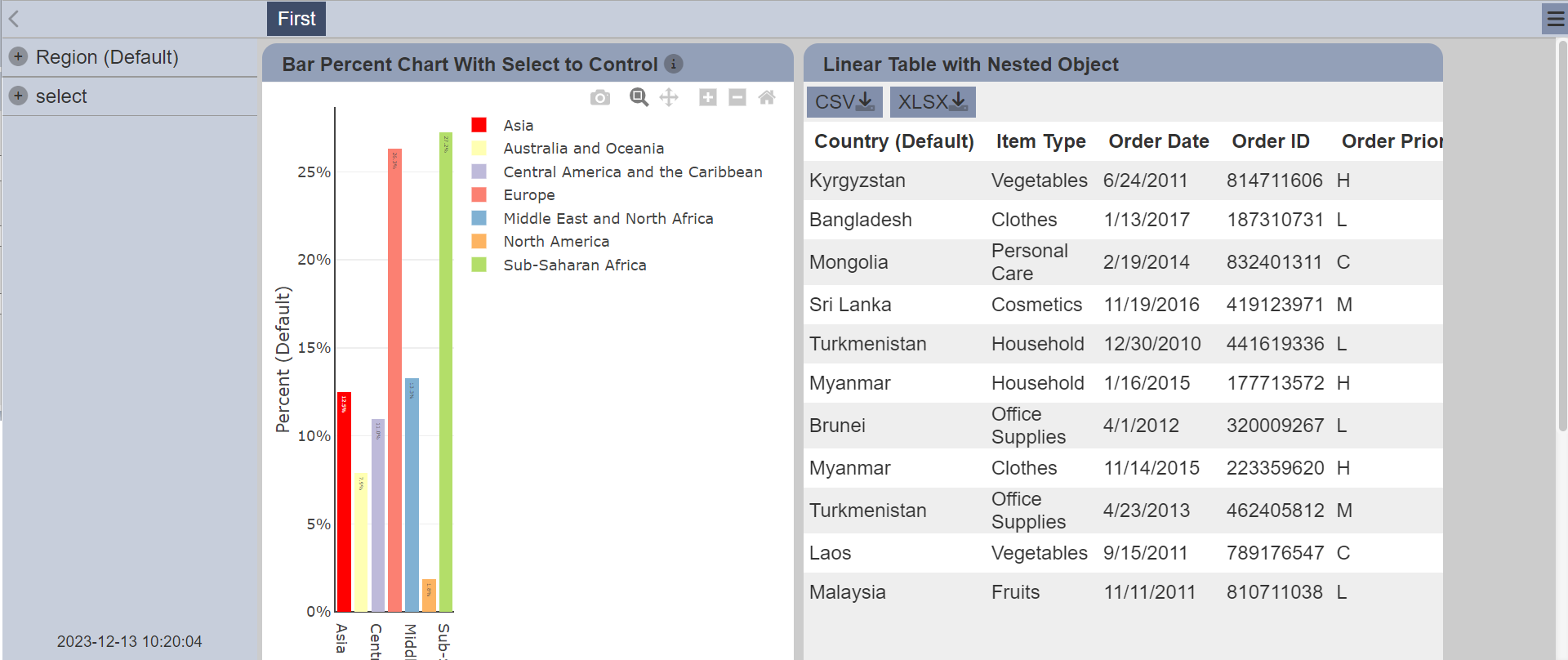

Open the dashboard. The dashboard by default should be in English.
Switch the language of the browser to the desired language. In this case, Vietnamese is used. The dashboard now display the desired wordings in Vietnamese.

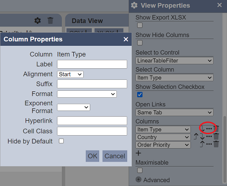

Open the “View Properties” dialog box of the Linear Table. In the “Columns” field, click on the
“Properties” icon of the desired column to internationalise.
Select the value “I18N” in the “Format” field in the “Column Properties” dialog box. Click on the “OK” button to save the change.
Close the “View Properties” dialog box and click on the “Save” button to save the change.

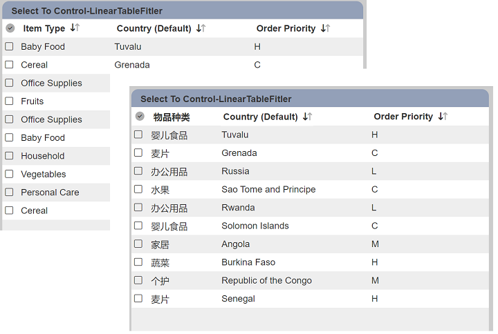

Note that the “Sort” icon is not displayed once “I18N” is selected in the “Format” field.
Switch the language of the browser to the desired language. In this case, Chinese (Simplified) is used. The selected column now display the desired wordings in Chinese.
