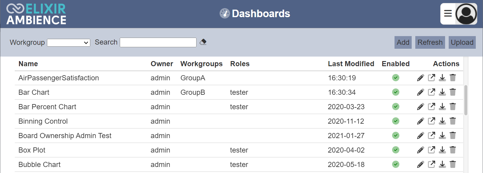

Dashboards management page provides an interface to manage dashboard properties. Users can add, modify and delete dashboards here. This interface also leads to the dashboard designer and viewer. Uploading and downloading dashboards are also supported. Controlling the audience of the dashboard is also managed through this interface.

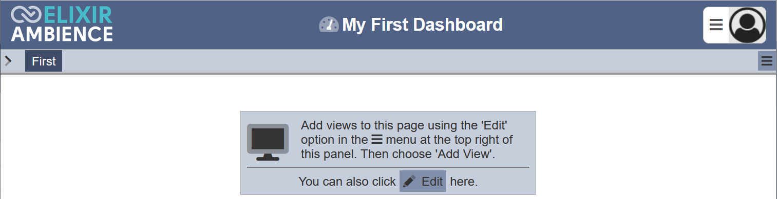

Clicking on the “OK” button on the dialog above redirects the user to the Dashboard Viewer, rendering the newly created dashboard with one page, entitled “First”. Clicking on the “Cancel” button aborts the action.

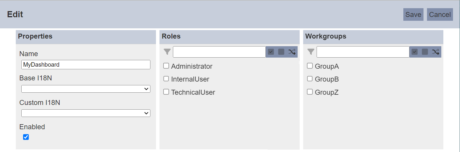

The “Edit” panel displays the selected dashboard’s attributes.
| Name | Unique name assigned to the dashboard that would be used as its identifier. | Y | Text field | Any text. The value must not exist in the current list, regardless of status (enabled or disabled) and ownership. The value is case-sensitive. | Empty string |
| Base I18N | Selects the default I18N translation. | N | Drop-down list | Translations need to be setup in the Internationalisation module. | Not selected |
| Custom I18N | Selects the custom I18N translation. | N | Drop-down list | Translations need to be setup in the Internationalisation module. | Not selected |
| Enabled | Indicates if the dashboard is enabled (selected) or disabled (unselected). | Y | Checkbox | True (selected) or false (unselected) | True (selected) |
| Roles | List of roles that are granted read-only access to the dashboard. Users who have the selected roles would be able to view the dashboard, assuming they have the appropriate privilege to the Dashboard Viewer interface. | N | Checkbox | Multiple values can be selected. All roles are listed as available options. | No value selected |
| Workgroups | List of workgroups that are associated with the dashboard. | N | Checkbox | Multiple values can be selected.* | No value selected |
* Do note that the available options that appear in the list, the user is either owner of the workgroups or is assigned a role listed in the workgroups. If the user is not the owner of any workgroup or not assigned any of the roles in a workgroup, no options will appear in the “Workgroups” property panel.
Refer to Internationalisation for more details on how to internationalise a dashboard.
In the “Roles” and “Workgroups” property panel, there is a search function, as well as Select All, Select None and Invert Selection buttons above the role options that may assist you in the roles selection.

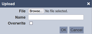

For the “Name” field, the same constraints for “Name” in the add dashboard dialog are applied to the “Name” field here. Verification on name uniqueness is not applied if “Overwrite” is selected.
After clicking on the “OK” button on the upload dialog, a record of a new dashboard is uploaded (new name given) or an existing dashboard with the same name (existing name with “Overwrite” selected) is updated. Clicking on the “Cancel” button aborts the action.

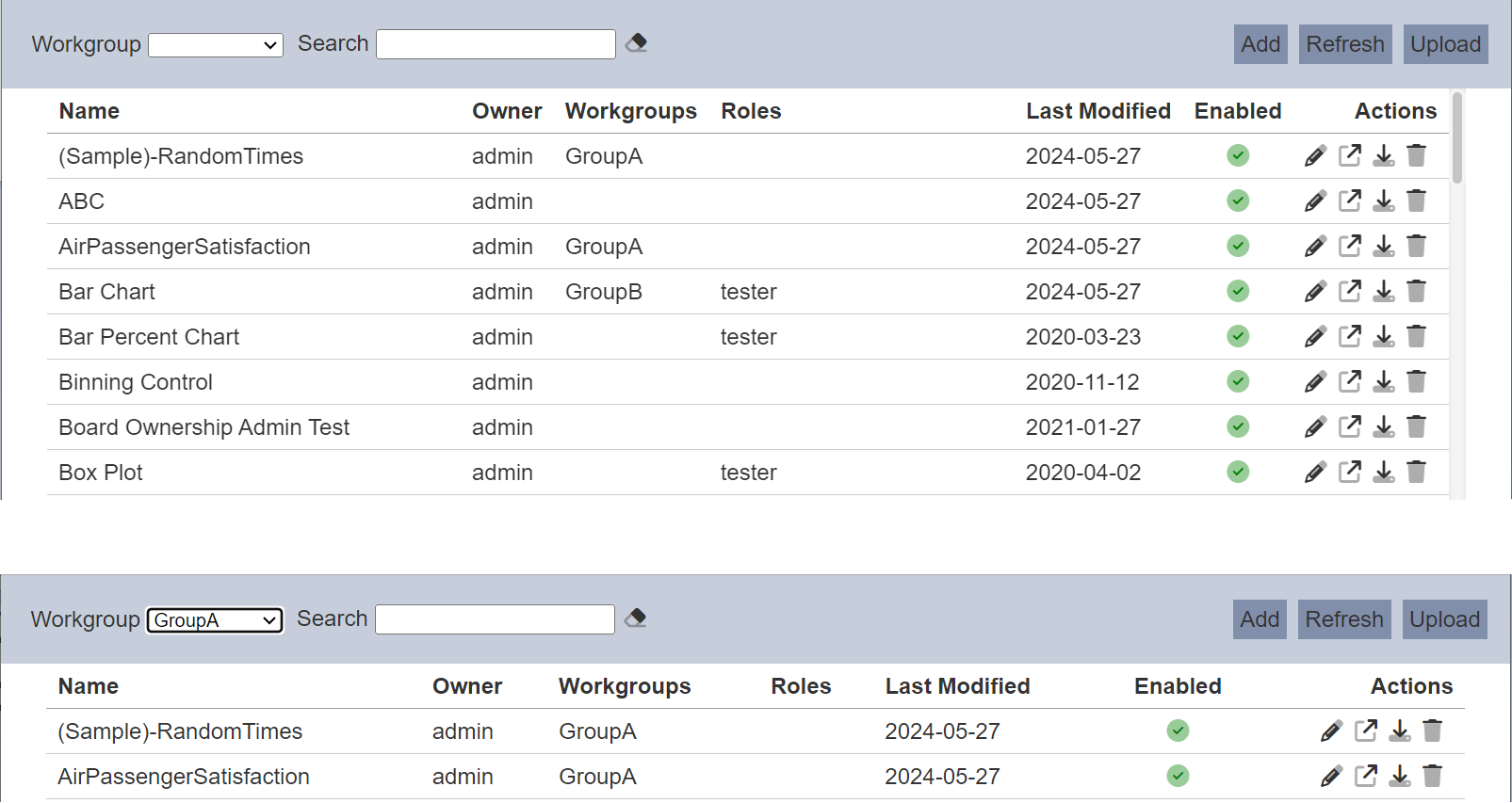

Workgroup

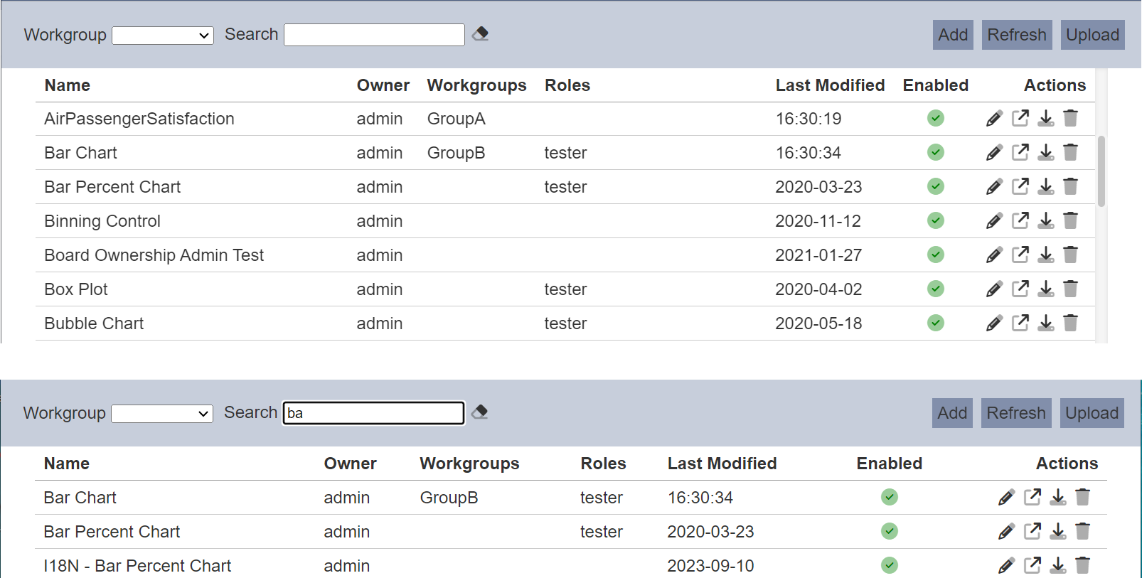

The “Workgroup” field at the top left corner of the page allows you to filter the dashboards associated with the selected workgroup.
Simply select the desired workgroup from the drop-down list and the dashboards associated with the selected workgroup will appear.
This provides an easy way to search through the dashboard list. It is case-insensitive and displays records that have the entered search value in any of the values of the fields below:
- Workgroups
