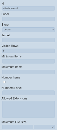

The Attachments component allows you to attach files onto the form. It has the following properties.
| Id | Name of the component that will be displayed in the form structure. | “attachmentX” |
| Store | Location where the attached file is stored. | None |
| Target | Path of the file content to appear in. | None |
| Visible Rows | Number of rows in the form. | “5” |
| Minimum Items | Defines the minimum number of items to attach. | None |
| Maximum Items | Defines the maximum number of items to attach. | None |
| Number Items | If selected, displays the number of items attached in the form. | Not selected |
| Number Label | Defines the label for the number items. | None |
| Allowed Extensions | Defines the extensions allowed to be attached. Each separated by a row. It is case insensitive. |
None |
| Maximum File Size | Defines the maximum file size of the items to be attached. | None |

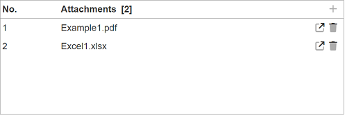

To test the form, click on the “More Actions” icon at the top row and select the “Run Form” option. In the “Run Form” dialog box, select a workflow from the drop-down list. Do note that currently the Attachment component needs to run with a workflow to work.
The form will appear in another tab. The Attachment component has the following settings in its properties:
- Minimum one attachment
- Maximum three attachments
- Maximum file size of 500KB
- Allows only PDF and xlsx files

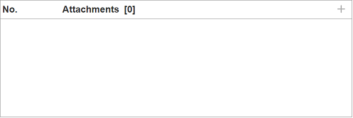

To attach a file, click on the “+” icon at the right of the Attachment component. The “Add Attachment” dialog box will appear. If the form is ran without a workflow, the “+” icon will not appear in the form.
Browse to the location of the file to be attached. The name of the selected file is used by default in the “Name” field. Change the name if it is not desired. Click on the “OK” button to attach the file.
You can choose multiple files to attach. In this case, the “Name” field will be disabled.
There are several types of file extensions that are not allowed to be uploaded. The default configuration is:
ambience.form.attachments.disallowed-extensions = [".exe", ".bat", ".cmd", ".js", ".dll", ".so"]
All comparisons are case-insensitive.
If the file extension matches one of those listed above, an error message will appear.
The “Allowed Extensions” property limits the type of extension allowed. If the attached file does not match the list in the property, an error message will also appear.
The “Maximum File Size” is set in the properties, an error message will appear if the file size is exceeded.
Once uploaded, the name of the attached file appears in the Attachment component along with the
“Open Attachment” icon and
“Delete Attachment” icon on the right. You can add more files by clicking on the “+” again.

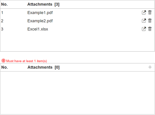

If the “Minimum Items” property is set, error message will appear if no attachment is attached and the “Submit” button is clicked. When the number of attachments matches the value set in the “Maximum Items” property, the “+” icon will disappear.

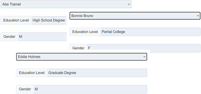

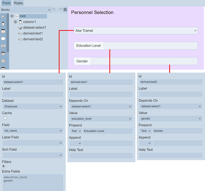

Derived Text

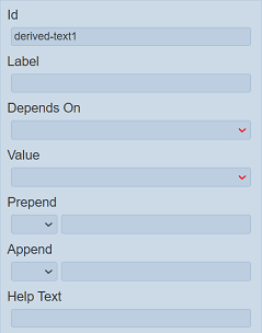

The Derived Text component provides a text area that allows you to display the desired text based on the selection of another component, such as the Dataset Select component.
It has the following properties:
| Id | Name of the component that will be displayed in the form structure. | “derived-textX” |
| Depends On | Selects the dataset that the Value field will use. | None |
| Value | Selects the field that the text will be derived from. | None |

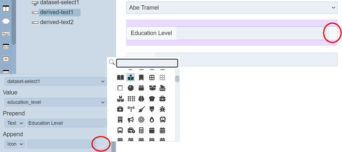

This component is particularly useful when some text (such as an explanation, caution, or any information) needs to be displayed along with a selection.

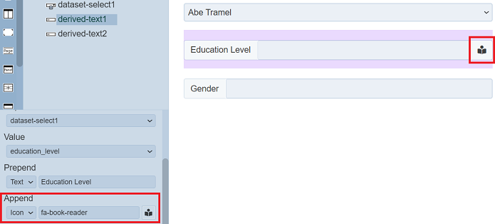

For example, a form uses the Dataset component to allow users to select personnel from a list based on their names. But it can only the names are displayed in the drop-dowm list, no other information is provided. It may be useful to provide more information for the users, such as education level and gender of the personnel selected. This can be done by adding two Derived Text components into the form, one to display the education level, another to display the gender.
Once the form is launched, when the user selects any personnel, the education level and gender will be displayed.
Instead of placing text in the “Prepend” and “Append” fields, icons can be used as well. In the “Prepend” or “Append” field, select the option “Icon” and a empty icon will appear next to the textbox in the property. Click on the icon and the Icon Picker will appear.
Select the desired icon. The selected icon will appear in the form. In the property, the name of the icon will appear in the textbox and the empty icon will be replaced by the selected icon.

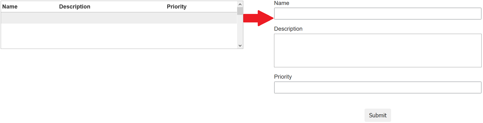

Form Launcher

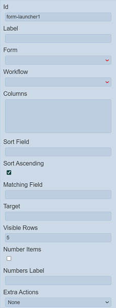

The Form Launcher component allows you to launch another form from the current form by clicking on the rows on the current form.
| Id | Name of the component that will be displayed in the form structure. | “form-launcherX” |
| Form | Selects a form from the Forms page through a drop-down list. | None |
| Workflow | Selects a workflow from the Workflows page through a drop-down list. | None |
| Columns | The columns to be displayed in the form. | None |
| Sort Field | The field from elxPublic to sort the records. | None |
| Sort Ascending | If selected, sort the field in ascending order. | Selected |
| Matching Field | The field to filter the records listed. | None |
| Target | The path which the form content to appear in. | None |
| Number Items | If selected, displays the numbering of the items in the component. | Not selected |
| Numbers Label | Defines the title of the numbering if “Number Items” is selected.. | None |
| Extra Actions | Selects the action to be added onto the component, including its icon and confirmation prompt (if applicalbe). | “None” |
Refer to Examples for a simple example on how to create a form with form launcher.

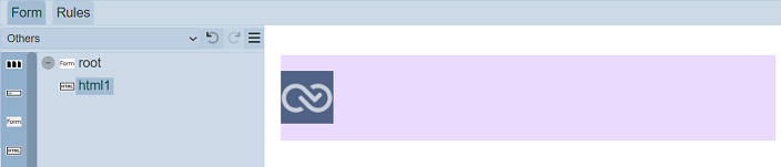

HTML
The HTML component allows you to add a HTML onto the form. It can be text, web page, logo, etc. It has the following properties.
| Id | Name of the component that will be displayed in the form structure. | “htmlX” |
| HTML | HTML code to be entered. | None |
In the below example, a logo is to be added onto the form. To do so, enter the HTML code <img src="logo.png"> in the “HTML” field.

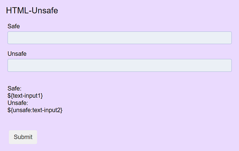

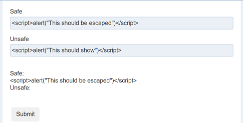

In the example below, a form is created with two text input and a HTML components. The HTML component output the text from the text inputs which are defined as below:
<div>Safe:<br>${text-input1}</div>
<div>Unsafe:<br>${unsafe:text-input2}</div>
A workflow and ETL chainset are created for the form as well. When the form submits its inputs, the workflow calls the ETL chainset, which adds the values from the text inputs to elxPublic.

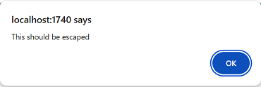

Run the form with the workflow and enter the following scripts in the two text inputs respectively:
<script>alert("This should be escaped")</script>
<script>alert("This should show")</script>
Click on the “Submit” button.
Since the substitutions are made safe by default, “Submit” will handle the first script. The second script will show as an alert.
The HTML view will show as below.

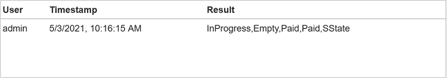

History
The History component allows you to include history information (such as user, timestamp and result) in the form.
| Id | Name of the component that will be displayed in the form structure. | “historyX” |
| Visible Rows | Number of rows to be displayed. | “5” |

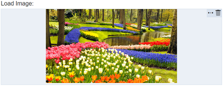

The Image component allows you to add a placeholder to load an image into the form with a workflow. It has the following properties.
| Id | Name of the component that will be displayed in the form structure. | “imageX” |
| Height | Height of the image placeholder. | “200px” |
| Store | Location where the image file is stored. | “default” |
| Maximum File Size | Defines the maximum size of image. | None |
To test the form, click on the “More Actions” icon at the top row and select “Run Form”. In the “Run Form” dialog box, select the desired workflow. The form with the Image component will appear with a “…” icon at the far right.
Click on the “…” icon to display the “Set Image” dialog box.
In the dialog box, browse to the location of the image file. The “Name” field takes the filename by default, change if the name is not desired. Click on the “OK” button to load the image or click the “Cancel” button to abort the action.
If the “Maximum File Size” property is set and the image file exceeds the file size, an error message will appear.
Upon successful uploading, the image will appear in the form.
You can reselect the image by clicking on the “…” icon.
To remove the image, click on the
“Delete” icon. The “Delete Image” dialog box will appear with a warning message. To confirm, click on the “OK” button. Click on the “Cancel” button to abort.
Do note that the Image component works only when run with a workflow. If no workflow is selected in “Run Form” dialog box, the Image component will appear in the form without the “…” icon to load an image.

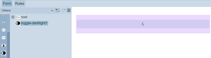

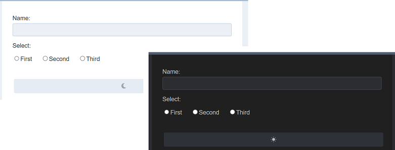

Toggle Dark Light
The Toggle Dark Light component allows you to add a button in the form to allow user to switch betwwn light and dark theme.
