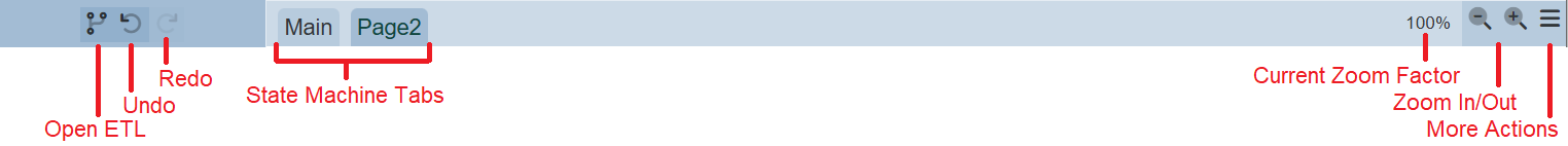

Task Bar
Open ETL
The
“Open ETL” icon allows you to open the ETL module with the ETL chainset that is linked to this workflow.
Undo/Redo
The
“Undo” icon and

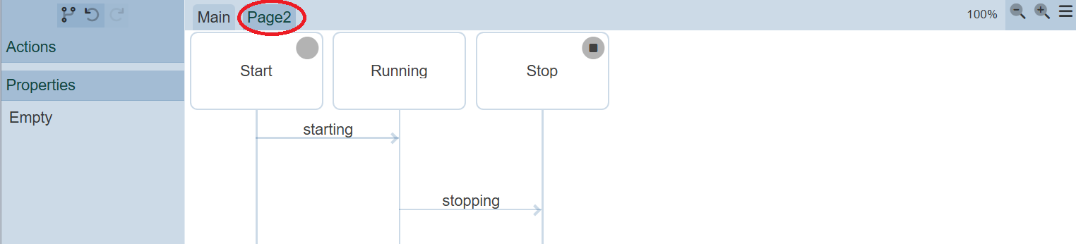

State Machine Tabs
Zoom Out/In
You can zoom out and in of the workflow diagram using the “Zoom Out”, “Zoom In”
icons. The number before the icons indicates the current zoom percentage. The zoom range is from 25% to 150%, in steps of 25%. The default initial zoom factor is 100%. Once the minimum or maximum zoom is reached, the respective icon will grey-out.

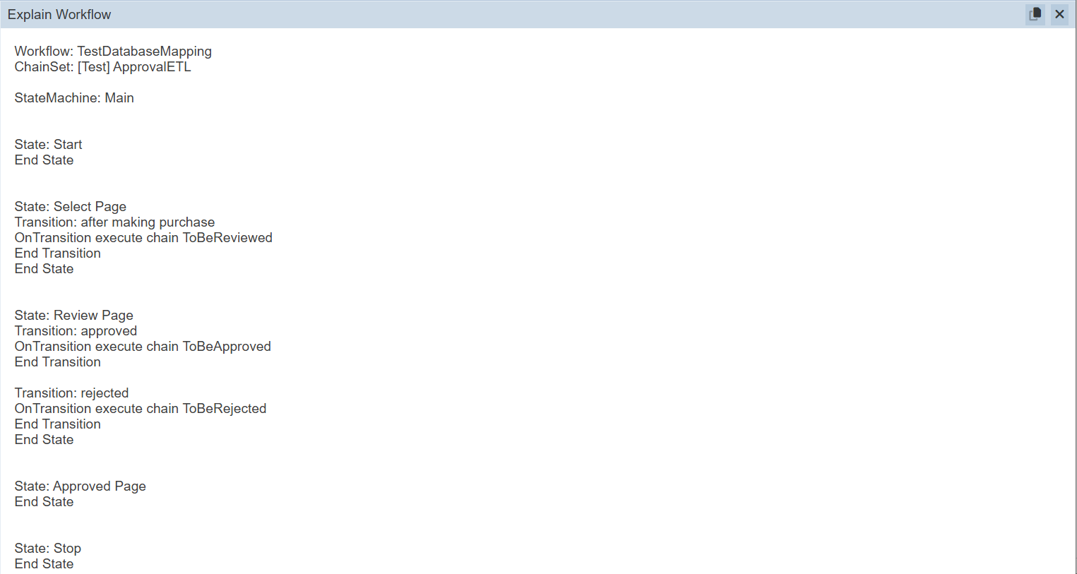

In the “Explain Workflow” page, you can copy the details of the workflow by clicking on the
“Copy” icon on the upper right corner of the page. To close the page, click on the

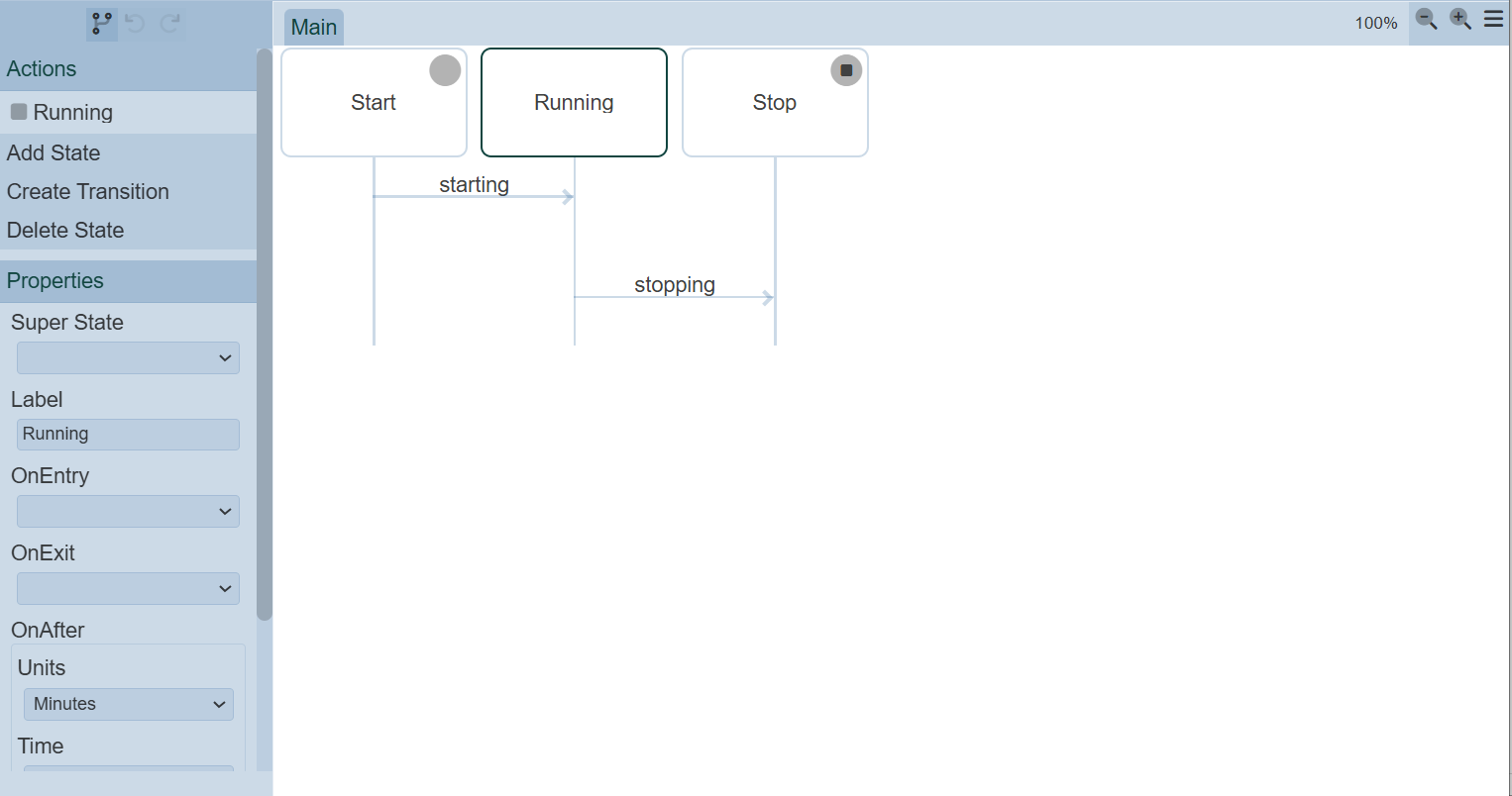

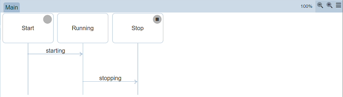

Flow Panel

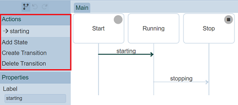

Three states
StartstateRunningstateStopstate
Two transitions
startingtransitionstoppingtransition

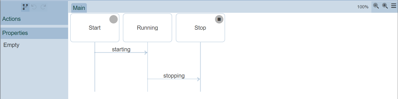

The first state is always Start and is indicated with a light grey outer circle and a dark grey inner circle at the upper right corner. The last state is always Stop and is indicated with a light grey circle and a smaller dark grey inner square at the upper right corner. They are the starting and ending points of a workflow respectively. There are no property for these two states, except for their labels and they cannot be relocated.

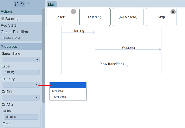

When the second state, which is Running or any of the transitions is selected, the actions available and its properties will be displayed in the Actions and Properties Panels respectively.

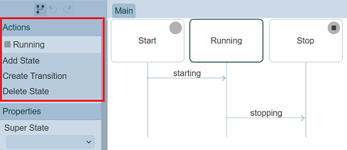

Actions Panel
| Action | Description | Process |
| Add State | Adds new state into the workflow. | State / Transition |
| Delete State | Removes selected state from the workflow. | State (except Start and Stop) |
| Create Transition | Creates a transition between selected source and target states. | State (except Stop) |
| Delete Transition | Removes selected transition in the workflow. | Transition |
Add State

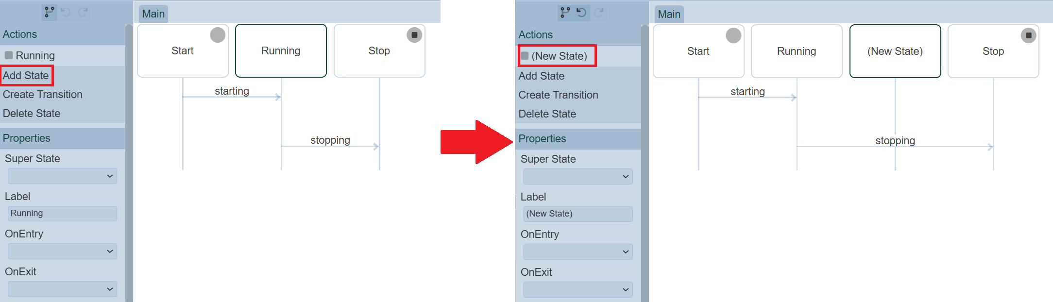

To add a new state, click on the “Add State” button on the Actions Panel. The (New State) new state will always be added before the Stop state. You can drag-and-drop the new state to the desired location if the current location is not desired.
The label and the properties of the newly added state (by default, the label is (New State)) can be changed in the Properties Panel.

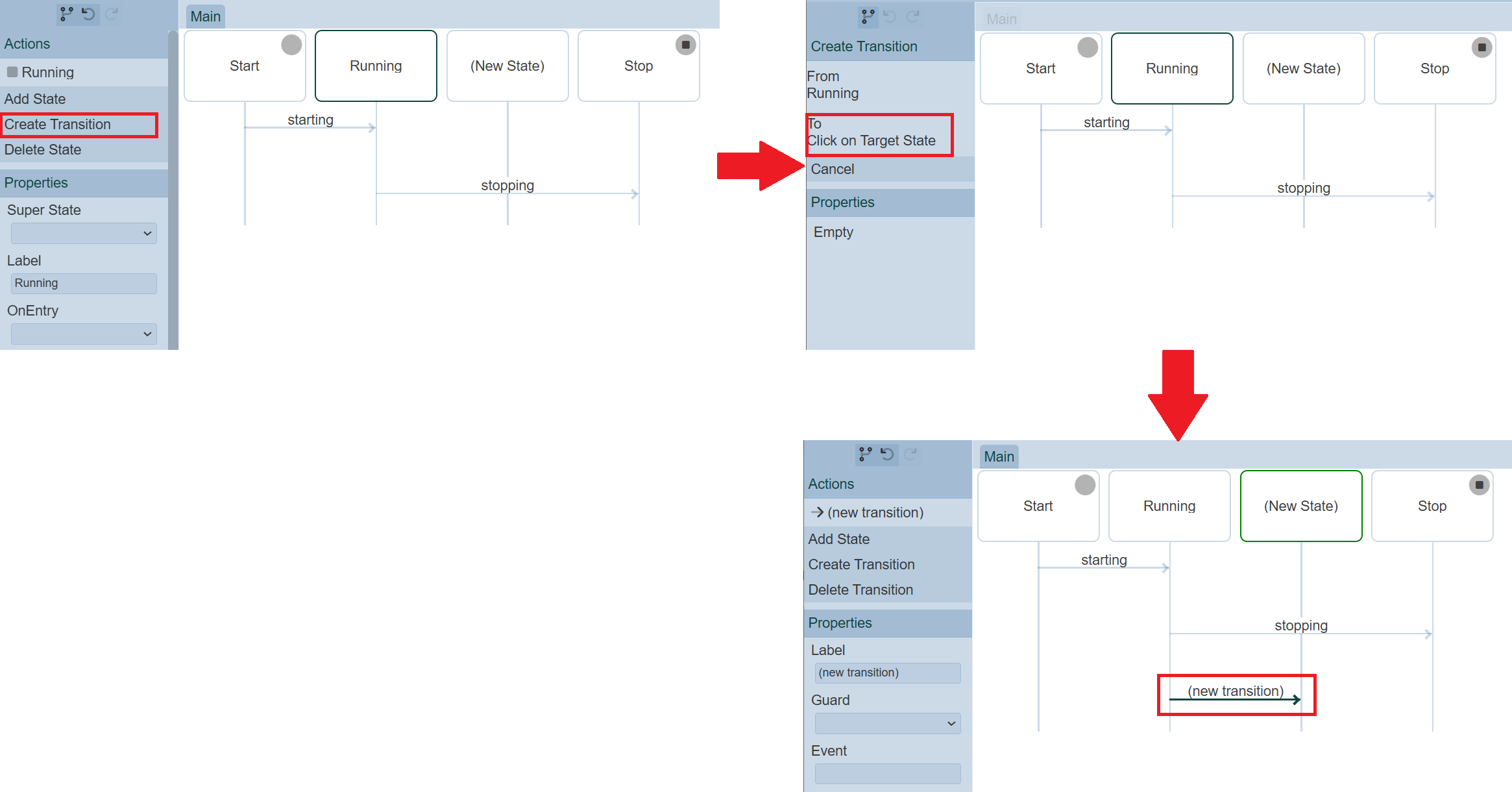

In the example below, a transition is added between Running and (New State) states. First, select the source state Running, then click on the “Create Transition” button on the Actions Panel on the left. A message will appear in the Actions Panel to prompt you to select the target state. Click on the (New State) state and a new transition (new transition) is added between the two states.
The label and properties of the newly added transition (by default, the label is (new transition)) can be changes in the Properties Panel.

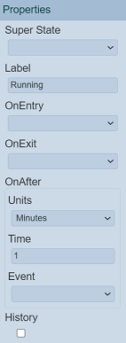

Properties Panel
State Properties
| Super State | Selects the super state that the current state belongs to. | N | Drop-down list | Select from drop-down list | Empty |
| Label | Display the name of the state selected. | Y | Text field | Any text | Name of selected process |
| OnEntry | Executes the ETL chain defined. | Y | Drop-down list | Select from drop-down list | Empty |
| OnExit | Executes the ETL chain defined. | Y | Drop-down list | Select from drop-down list | Empty |
| OnAfter | |||||
| Units | Defines the unit for the Time field. Options: - Days - Hours - Minutes |
| Time | Defines the time to execute the event. | Y | Text field | Numeric | “1” |
| Event | Defines the event to be executed in the workflow at the defined time. | N | Drop-down list | Select from drop-down list | Not selected |
| History | If selected, the state be a history state. | N | Checkbox | None | Not selected |

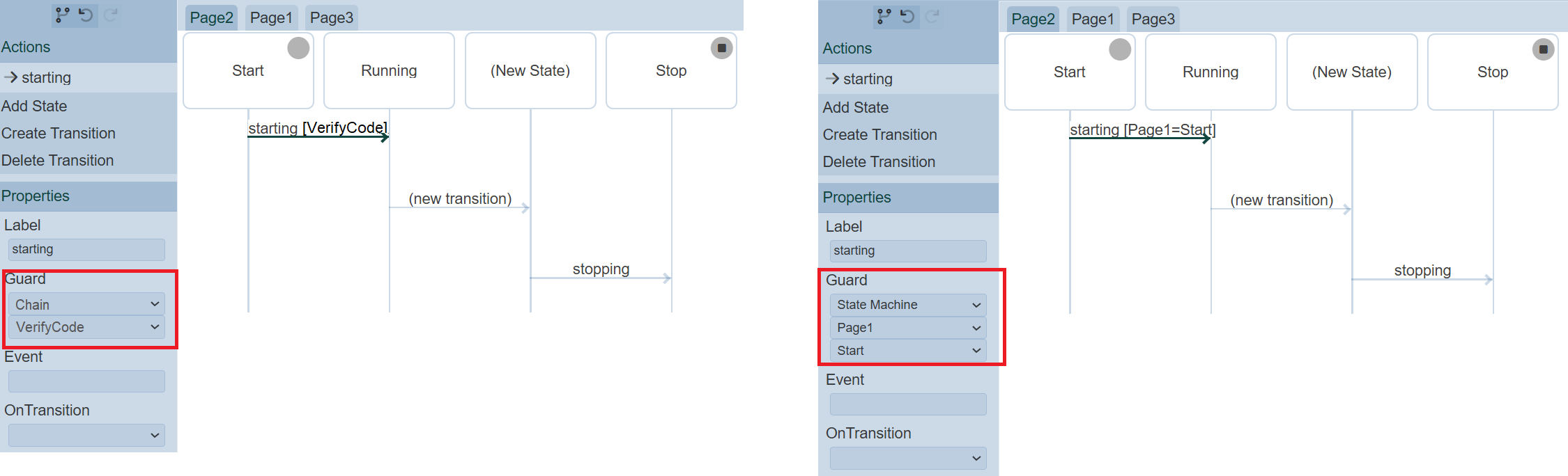

Transition Properties
| Label | Display the name of the transition selected. | Y | Text field | Any text | Name of selected process |
| Guard | Evaluates the true or false of the input to the transition before executing the transition and moving to the next state on true condition. | Y | Drop-down list | Select from drop-down list | Empty |
| Event | Defines the event that must be sent to Workflow engine. If no event is specified, any event will trigger this transition. |
| OnTransition | Executes an ETL chain. | Y | Drop-down list | Select from drop-down list | Empty |
There are two options for the “Guard” property, namely “Chain” and “State Machine”. If the ETL chain or state machine is not available, their respective option will not be selectable. For the ETL chain to be selectable for the workflow, the Guard Endpoint ETL must be present in the ETL chainset. When one of the option is selected, their respective sub-field(s) will appear, which allows you to define the ETL chain or state for evaluation.

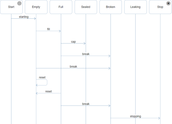

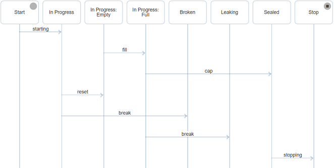

Using Super State
This creates duplicating transitions in the workflow, such as reset and break transitions. These duplication should be avoided as much as possible. A real life workflow is much more complex.
We can add a new abstract state called InProgress. InProgress is the super state while Empty and Full are its sub-states. The InProgress super state has two transitions, reset and break. These transitions are inherited by the sub-states. The sub-states can trigger these transitions, thus reducing the need to duplicate these transitions for each state.

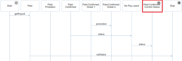

Using History State

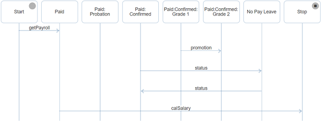

In this scenario, a confirmed employee of Grade2 returns to the company after taking no pay leave. When he returns, he will return to the Confirmed state.
To solve this issue, a History state “CurrentStatus” is added. A History state is indicated with a two-bar icon on the upper right corner. The History state is responsible for remembering the state on Exit and resuming that state on re-entry.
When the employee goes on no pay leave, the Confirmed state goes to No Pay Leave state. The History state remembers the current state of the employee, such is Grade 2.
When that employee returns to the company after his no pay leave, the No Pay Leave state returns to the History state. Since the History state remembers the state of the employee (i.e. Grade 2), it resumes that state and place the employee back to the Grade 2 state.
