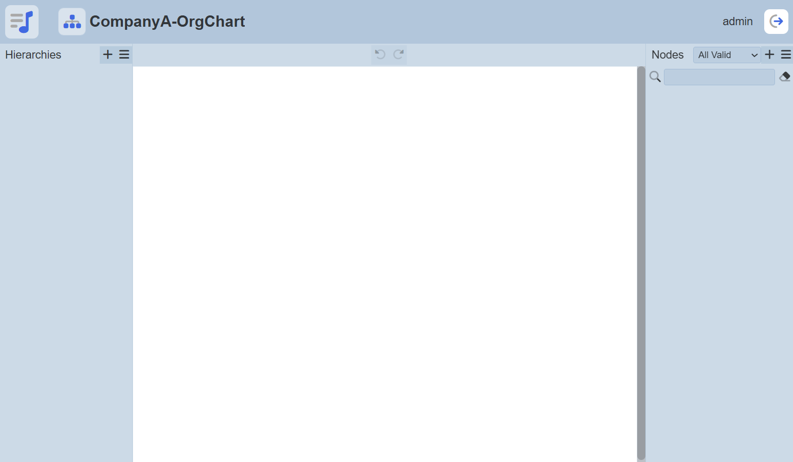

During initial creation, a blank organisation chart will appear.
The Chart Designer page is divided into three parts:
- Hierarchies Panel
- Design Area
- Nodes Panel

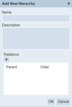

Add Hierarchy

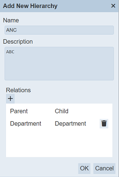

To add a hierarchy, click on the “+” icon in the top row. The “Add New Hierarchy” dialog box will appear.
| Field | Description | Mandatory | Constraint |
| Name | Unique name assigned to the org chart. | Y | Any text (case-sensitive) |
| Description | Brief description of the org chart. | N | Any text |
| Relations | List the parent-child relations. | Y | At least one relation must be defined |
In the “Add New Hierarchy” dialog box, key in the name to be given to the hierarchy into the “Name” field. The “Name” field must be a unique value (not used by other hierarchies) and it is case-sensitive.
Provide a brief description for the hierarchy in the “Description” field.
Click on the “+” icon below the “Relations” field. The “Add Relation” dialog box will appear.
The list of options available in the drop-down lists are provided by the Data Catalog module.
In the “Parent” field, select a value from the drop-down list. Select a value from the drop-down list in the “Child” field. Click on the “OK” button to add the relation to close the dialog box. Do note that more than one relation can be defined. Repeat the above steps until all the desired relations are added.
If any of the relations need to be removed, click on the
“Delete” icon on the right of the relation.
Once all fields are set, click on the “OK” button to add the new hierarchy.
If the “Name” field has no value or the name already exist, the relevant error message will appear.
If no relation is defined, an error message will also appear.
Once the new hierarchy is added successfully, a message will appear.

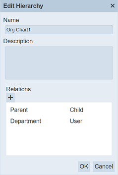

Edit Hierarchy
To edit a hierarchy, select the desired hierarchy to edit and click on the
“More Actions” icon. Select the “Edit Hierarchy” option from the list.
The “Edit Hierarchy” dialog box will appear.
Edit the “Name” and “Description” fields as desired.

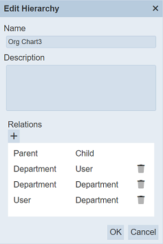

To add more relations to the hierarchy, click on the “+” icon below the “Relations” field. Click on the
“Delete” icon to next to the relation to remove it. At least one relation must be defined, else an error message will appear.
Click on the “OK” button to save the changes. A message will appear to confirm the change is saved.
Do note that if only one relation has been defined prior, the
“Delete” icon will not appear next to the only relation in the dialog box.

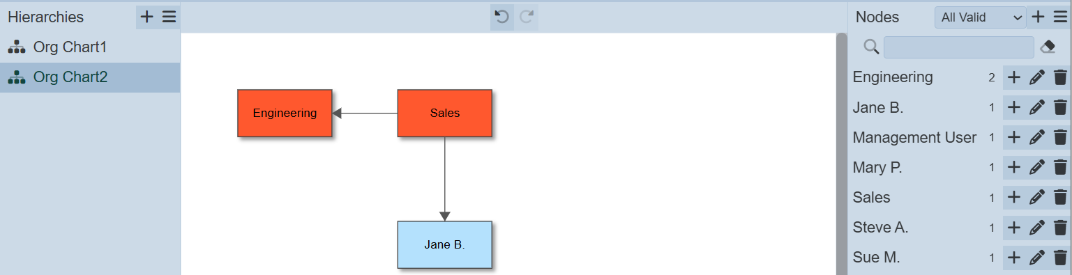

Node Panel
The Node Panel allows user to add, edit, delete and populate nodes for the tree in the Design Area.
The Node Panel consists of two parts, the top row and the list of nodes below.
The node type selection at the top of the panel allows user to filter the nodes according to the type selected. The nodes are shared across the hierarchies. By default, any nodes that are not of a type that is allowed in the current hierarchy are not shown by the drop-down list at the top of the panel.

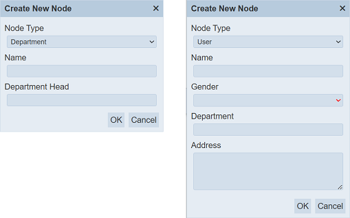

To add a node, click on the “+” icon at the top row. A “Create New Node” dialog box appear.
| Node Type | Defines the node type. | Y | Select one |
| Name | Name of node. | Y | Any text |
| Department | |||
| Department Head | Name of department | N | Any text |
| User | |||
| Gender | Defines gender of user. | N | Select one |
| Department | Defines name of department | N | Any text |
| Address | Defines address of user. | N | Any text |
Select the desired option from the drop-down list in the “Node Type” field. The fields below will vary according to the type of node selected.
Key in a unique name for the new node in the “Name” field. In the fields, select or key in the desired values.
Click on the “OK” button to save the new node.

Populate Node
To populate the org chart with a node, click on the “+” icon on the right of the desired node. The node will be added into the Design Area and the number next to the node will increase by one.
A node can only be added to a hierarchy once. If the node has been added prior, an error message will appear.

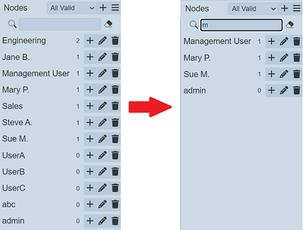

Search Node
There is a cross-field search function for the list of nodes, just below the top row.
This provides an easy way to search through the nodes. It is case-insensitive and displays files that have the entered search value in any of the values of the fields below:

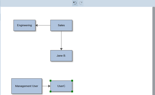

Select Node
To select a node, simply click on the node itself. Four green squares will appear at the four corners to indicate that the node is selected.
Once the nodes are added to the hierarchy, they can be drag-and-drop to arrange the tree.
Multiple nodes can be selected by clicking on the CTRL key on the keyboard. They can then be moved simultaneously and will retain their relative positioning.

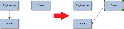

When an existing node is selected as an option, the child node (if not added in the Design Area, the child node will be added) and a line will be drawn between the parent and child nodes, with an arrow pointing towards the child node.
If the node being added as a child already has a parent, then the added node will be reparented.

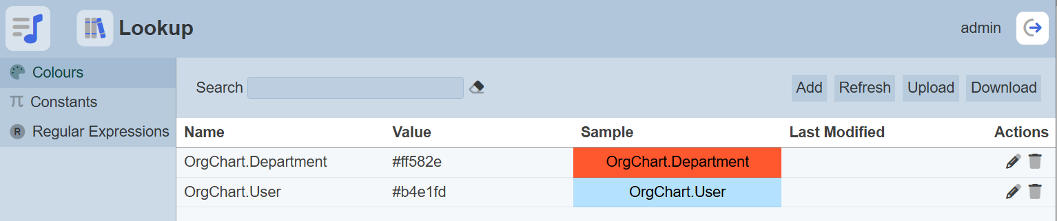

Changing Node Colour
By default, the nodes in the Org Chart has the same colour, LightSteelBlue. User can change the colour of the nodes by using the Lookup module.
In the Lookup module, add a lookup in the format OrgChart.<NodeType> and define the desired colour.
Refresh the Org Chart and the new colours will be displayed.
