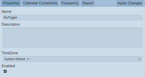

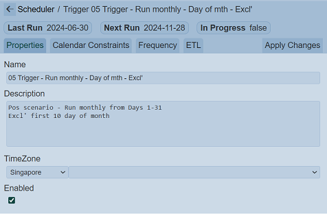

Properties Tab
The Properties tab allows user to set the various properties of the trigger.
| Name | Unique name assigned to the trigger. | Y | Text field | Any text. | Empty string |
| Description | Brief description of the trigger. | Y | Text field | Any text | Empty string |
| TimeZone | Time zone of the trigger to be run. | N | Drop-down list | Select from list | System default |
| Enabled | Enable or disable trigger. | Y | Checkbox | Enable or disable | Enabled |
The value in the “Name” field is as per defined in the previous dialog box. Provide a brief description of the trigger in the “Description” field. The “Enabled” field is enabled by default, allowing the trigger to fire.
The “TimeZone” field is by default set to the your system’s time zone. If you are unsure of the time zone set on your deployment server, then selecting an explicit time zone, rather than using the system default will ensure your trigger runs at the time you choose.

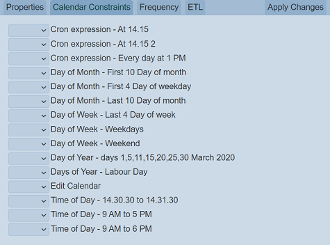

Calendar Constraints Tab
This tab allows user to select the appropriate constraint(s) by including or excluding it.
| List of calendar constraints | A list of calendar constraints defined in the Calendar page. Each calendar constraint can be unselected (not used) or selected (to include or exclude). |
Refer to Calender for more information on how to set calendar constraint.

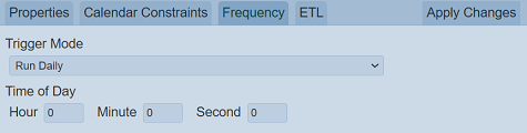

Frequency Tab
In the “Frequency” tab, select the appropriate “Trigger Mode” and its corresponding fields.
| Trigger Mode | Select the trigger mode from the list of options: - Run once only - Run hourly - Run daily - Run weekly - Run monthly - Cron expression |
| Field(s) for above selection | Depending on the above selection, one or more fields may appear. By default, the field “Time of Day” is shown, since Run daily is the default. |

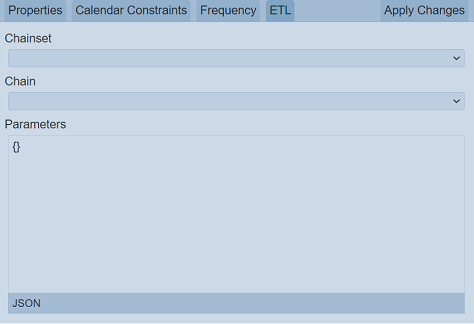

ETL Tab
The ETL tab allows user to select the appropriate ETL chainset and chain to run, and set up “Parameters” field if it is required to pass any parameters into the chain.
| Chainset | Selects the appropriate chainset for the report. | Y | Drop-down list | Select from list | Empty string |
| Chain | Selects the appropriate chain from the chainset. | Y | Drop-down list | Select from list | Empty string |
| Parameters | Defines any parameters required to be passed to the the chain. | N | Text field | Any text | Empty string |

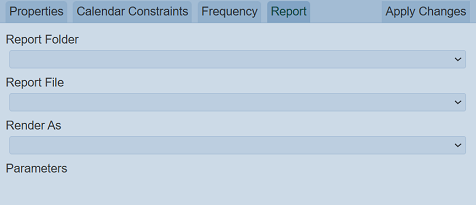

Report Tab
The Report tab allows you to select the desired report file in the Repository folder to generate a report and set up “Parameters” field if it is required to pass amy parameters into the DocX/RML file.
| Report Folder | Select the folder where the report resides in the Repository. | Y | Drop-down list | Select from list | None |
| Report File | Select the DocX/RML report file. | Y | Drop-down list | Select from list | None |
| Render As | Select the report output format. | Y | Drop-down list | Select from list The format available may vary, depending on the type of file selected. |
None |
| Parameters | Sets up the parameters to be passed into the report. | N | Textbox | Default settings are used if this field is left empty. | Empty |

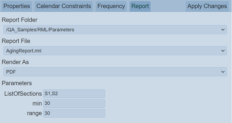

Select the desired folder and report file from the drop-down lists, as well as the output format. If no parameters are required, the “Parameters” field will be disabled. If parameters are required, the list of parameters will be displayed, allowing user to define the values. The parameters required for each report vary. Below is an example.
Do note that the default parameters will apply if the required parameters are not set up in the “Parameters” field

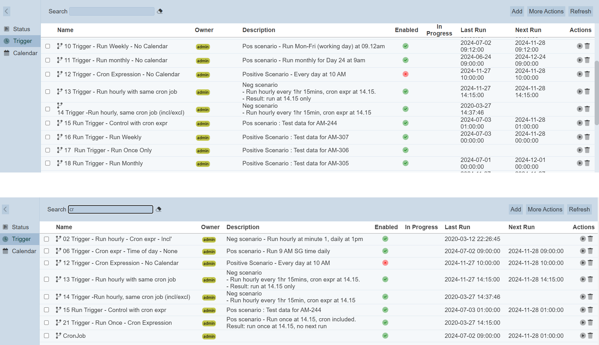

Refresh Trigger
- Last Run
- Next Run

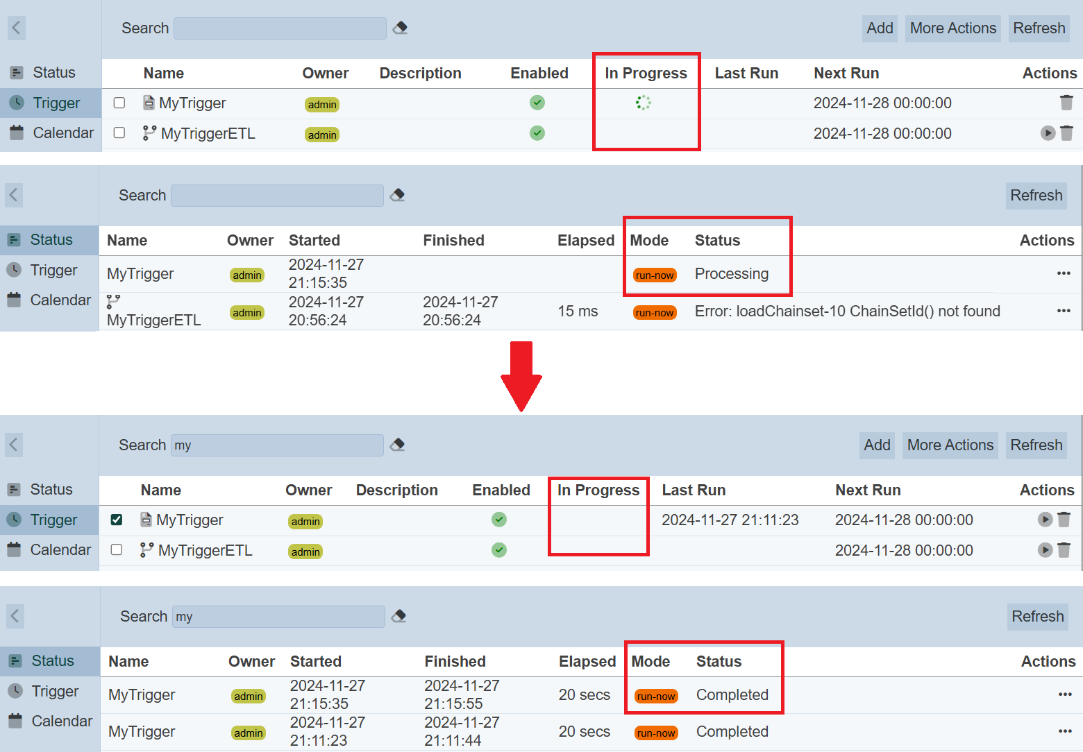

Once a trigger has been set up and enabled, it will run automatically once the defined date and time is reached, and will calculate the next run time. When the trigger is not due to run, you can manually run the trigger by clicking on the
“Run Now” icon under the “Actions” column corresponding to the trigger.
Once the job is fired, a message will appear.
Do note that the
icon is not available for jobs that are currently running (i.e., in progress). A job that is running is indicated by a green ring under the “In Progress” column corresponding to the trigger.

Reset Trigger
A trigger marked as “In Progress” will not fire again until it has finished. The in progress state may be incorrect if one of the server nodes crashed while the job is running. If you are sure that it is not running, you can reset the status of the trigger by selecting the trigger, click on the “More Actions” button and select the “Reset In Progress” option.
The in progress status will be removed and the job is stopped.
